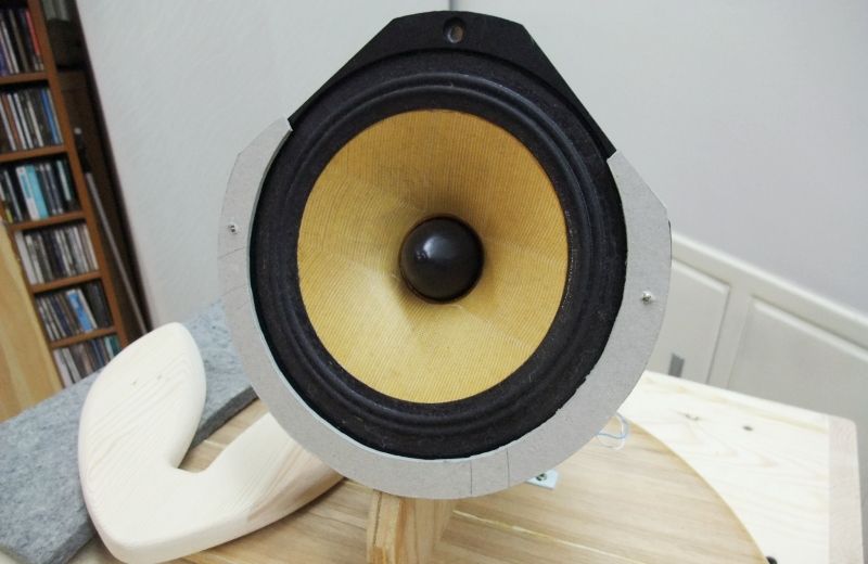

This lens indeed works in widening the dispersion. It makes the response more uniform in the room. The tonal balance is well maintained when I walk around. Without it, the range of upper mid to lower high would change a bit in different listening positions. It's obviously beaming.
One possible drawback is the output seems reduced somewhat. But I'm not if this is because the original beaming is spreaded to a wider area.

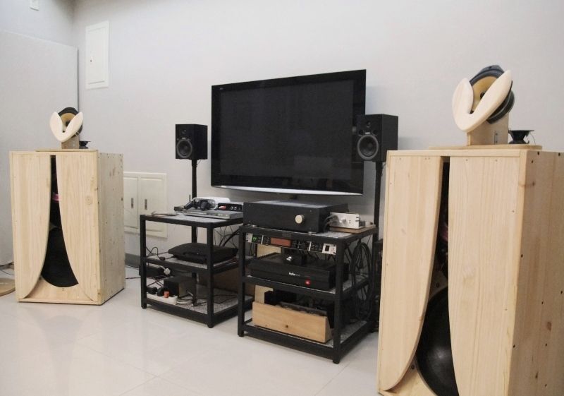

Wow... Nice!!! Great idea to put K-tech where it's needed. I know that having this aperture in front of my XKi gave it perhaps one of the most uniform polar responses, this side of a JBL M2 waveguide. It may color it a bit with dips, but for the most part, they sound benign compared to the huge expansion of uniformity coupled with significantly reduced beaming.
It also aesthetically matches the top and bottom drivers now. Very cool result.
You have a true dipole system top to bottom - how does it sound? My experience is that the bass and midbass have a very authentic realism and impact. The visceral punch has very good dynamics and timing. It may not be throbbing deep like a sealed sub, but the spatial room effects are not there and it is more uniform when walking around. Listen to well recorded drum solo, or slap bass and you can hear the effect very clearly.

It's actually not dipole all the way from top to bottom. In the top octave, the tweeters are up firing, it's similar to (horizontally) omni. At the very bottom, it's a bit lacking. Not much below 30.
I've been building and using dipole speakers for quite some time. Many obvious merits are obtained from no-box alone. It's a pity that plain OB is not enough in LF for my taste. It's clean but it lacks impact force. In the heydays, I'd tried 6x18" in total, but I guess a good single 12" in a proper box can beat that in the sense of impact.
Then, compared to plain OB, a slot (and its compression) helps loading the woofer quite nicely and brings back the sense of impact force. It has served me well as subs for years, too. But for wider range, a smarter slot (loading) is needed.
That's Karlson. That's a really smart slot.
It has a strong presence. The image has a solid body with temperature and breathing. And the 'body' is so eager, jumpy and powerful. Can't ignore. In this regard, I think it's very similar to horns, but with more uniform dispersion, smaller size, and slightly less efficiency. I'm very glad I built it. 😀
But no free lunch here, this KaZba is the most 'boxy' dipole I've built, so I have some residual resonances to clean up. Especially I've been used to baffle-less dipole in a very wide range. Have to carry on.

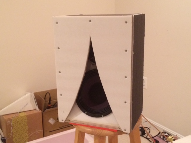

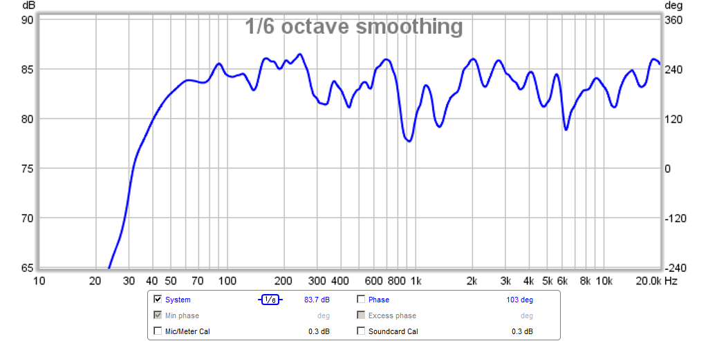

Return to the KaZba... with Beta 8cx Style

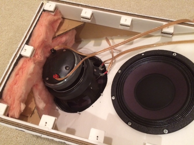

I installed a pair of Eminence Beta 8cx's (the latest variant with Qts 0.29 motor) with a PRV D280Ti CD on the front facing driver into my foam core/cardboard KaZba. The active XO is provided, as usual, with a miniDSP and a TPA3116D2 amp. The Beta 8cx has some dips that required some EQ. After applying a LR2 XO at 2kHz and a 0.14ms of time delay on the woofer, it was surprising how good it sounds. It doesn't measure flat by any means but what is special is the wide dispersion afforded by K-aperture, and the really smooth flat bass shelf that extends to 40Hz with a mild 5dB low shelf EQ, and the extremely wide bandwidth up past 2kHz. The real surprise is the impulse function and the step response (SR). Even though this is a LR2 crossover, I was able to achieve what resembles a right triangle SR, normally only possible with a BW1 transient perfect XO. Thus the music sounds especially realistic due to the good SR and time accuracy. I have been listening to it with a bunch of different tracks and it sounds really nice - very satisfying bass, clear mid range, sparkling highs from the titanium dome compression driver, and good time alignment. The CD is not shouty at all - very pleasant with different genre's. The KaZba slot loading does something the drivers so that the dipole bass extension is much better than a simple OB. There is some harmonic distortion, but reasonable levels. Much of it from foam core cabinet and K-aperture vibration and buzzing.
Here is a closeup of the D280Ti CD as mounted on the front facing Beta 8cx:
Here is the completed speaker playing music on a stand:

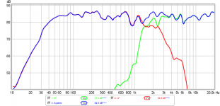

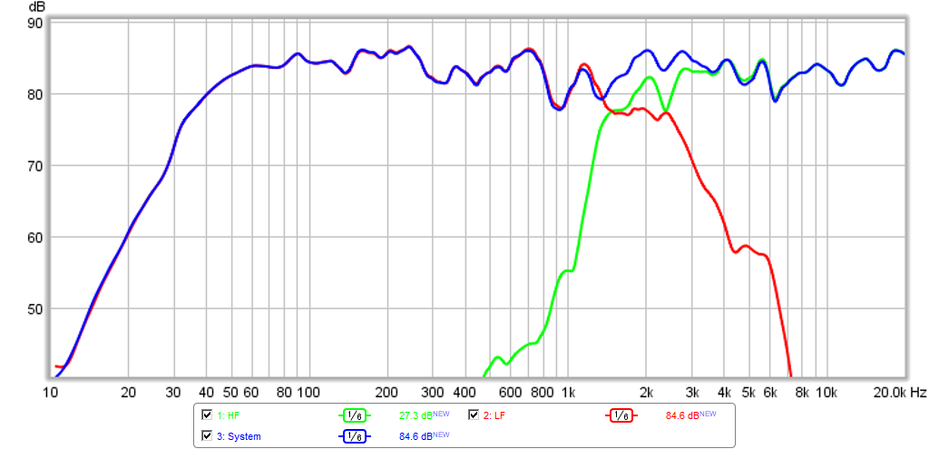

Here is the acoustic XO, at circa 1.5kHz to 2kHz:
Here is the detail of the frequency response at 5dB vertical intervals:

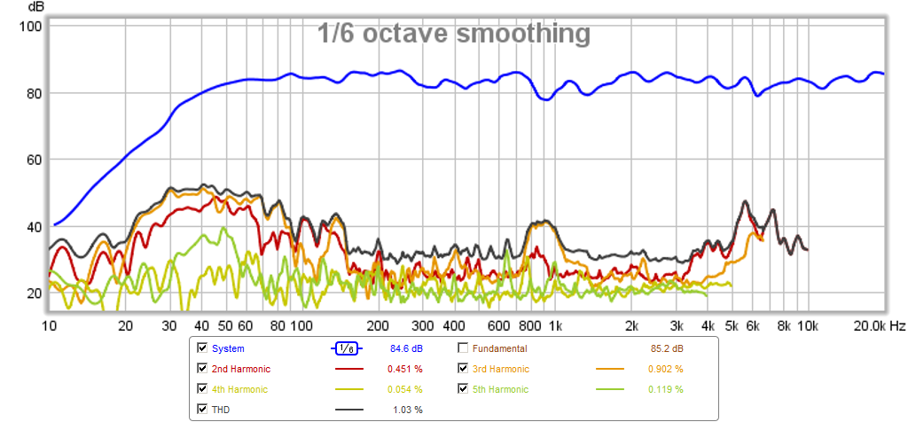

Here is the harmonic distortion:

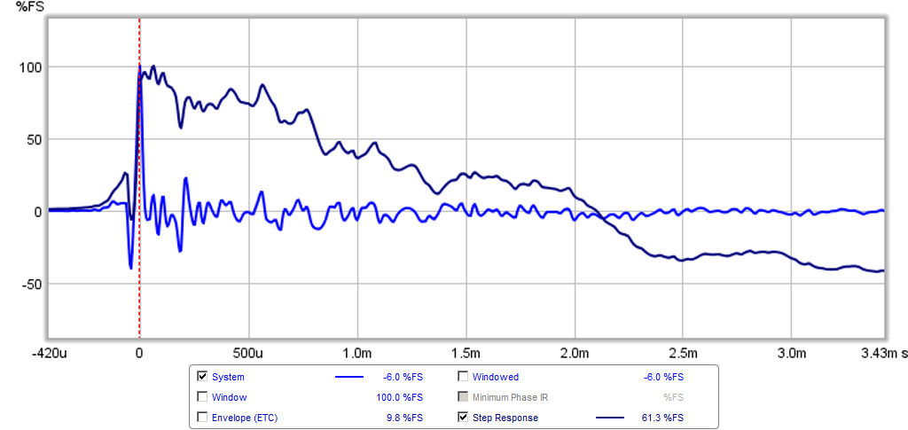

Here is the impulse response and step response:

Did you do anything to the center pole piece of the rear-facing 8CX? There's an opening, isn't it? And the dust cap is virtually an opening, too. This would be a path of leakage.
Very nice result of a low Q driver in "OB" - not a usual one, though.
I stuffed putty into the CD screw threaded hole to seal it. Same thing I did in the KaZba as well as my OB test bed. I realize that the lack of a dustcap sort of reduces the effective Sd?
