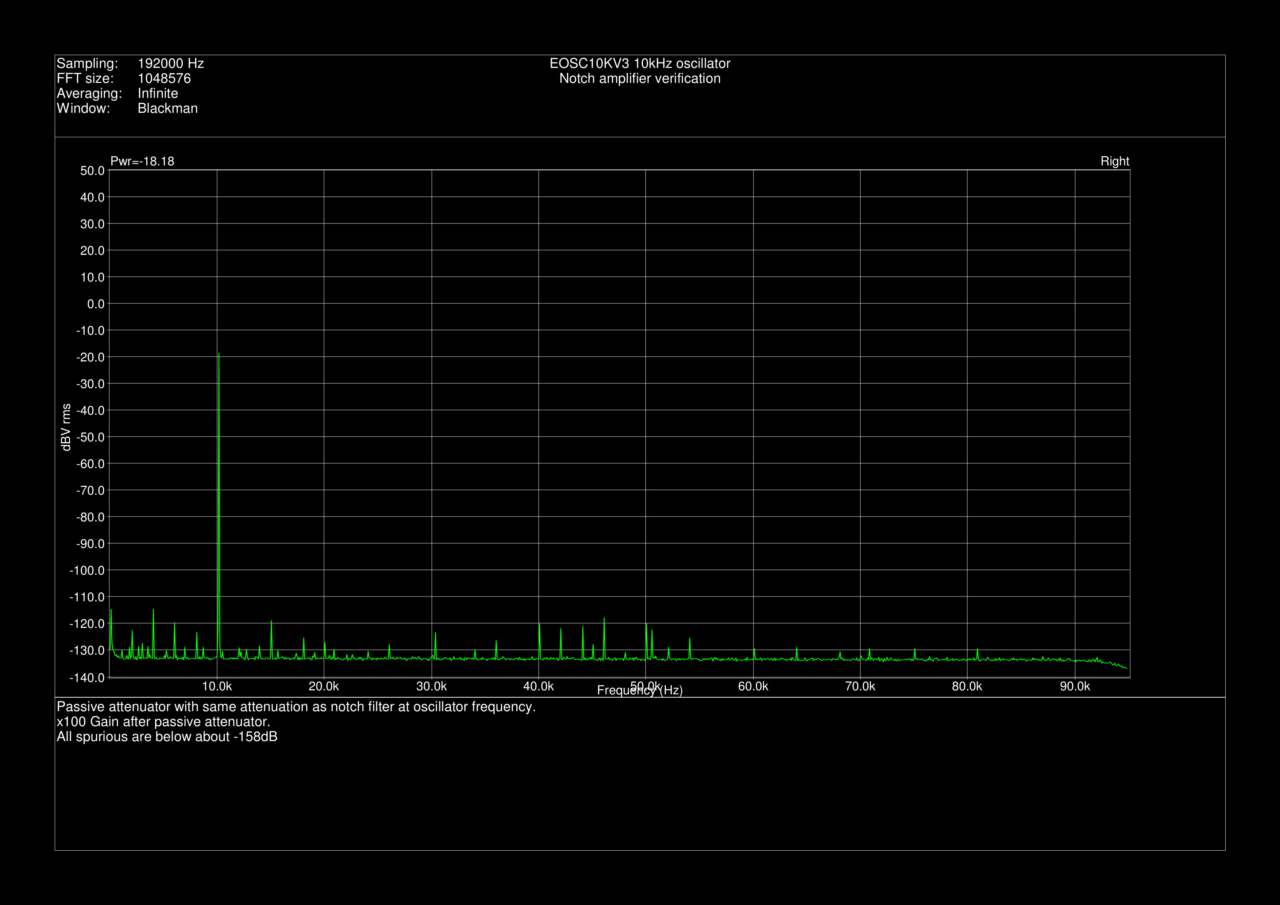

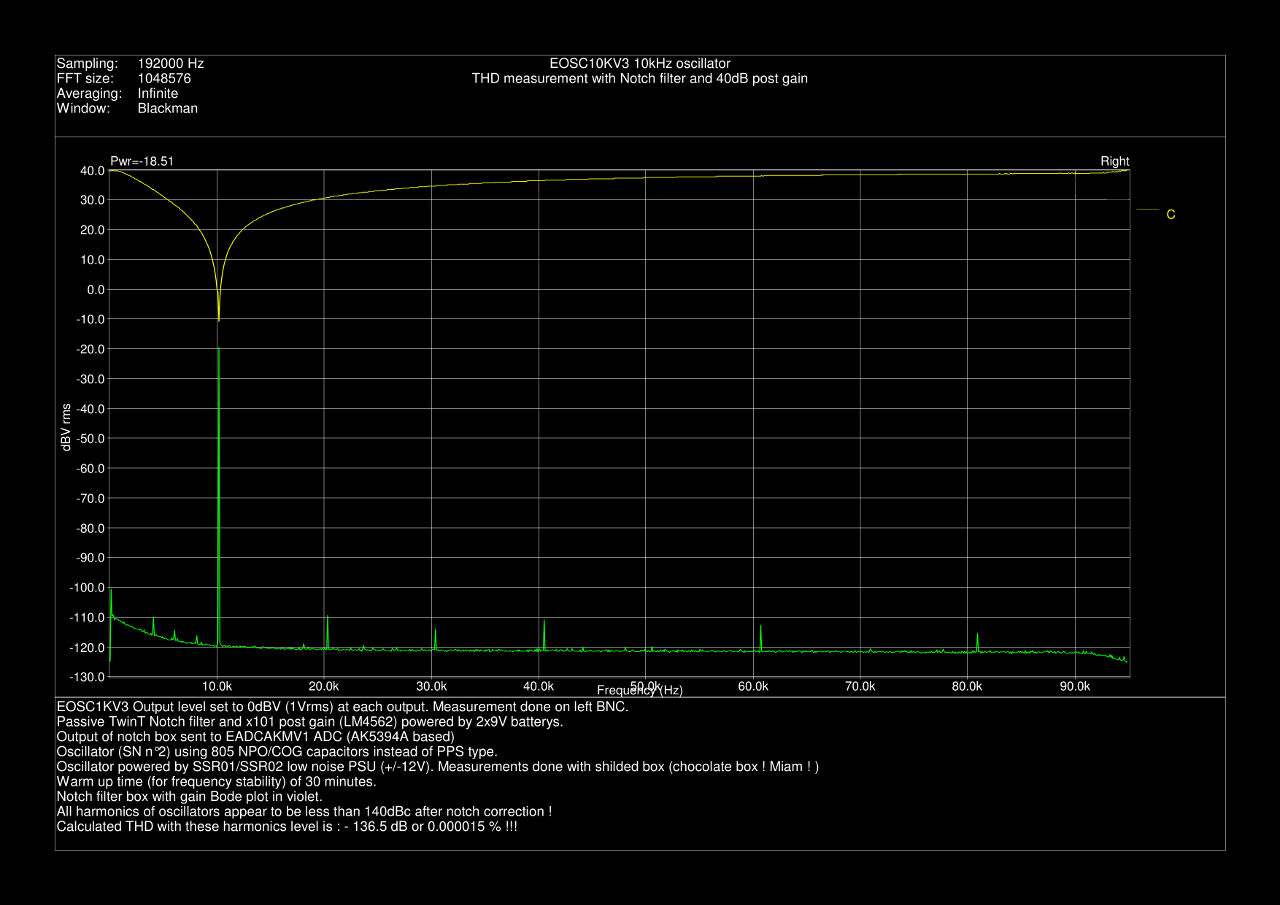

The measurement below, show the FFT result of the oscillator output
connected to my EADCAKMv1 ADC through a passive stepped attenuator.
The attenuator was set to -10dB attenuation to find the lowest thd point
of the ADC. (the measured THD come mainly from the ADC itself).
The EOSC10KV3 board is set to 1Vrms at output (single ended).
It is supplied by a +/-16dc linear PSU (Metrix lab PSU).
Photo spectrum
As you can see the spectrum plot is very clean, with all spurious much below -120dBV
and noise floor below -140dBV in the full measured bandwidth.
Here, and without notch filter, the measured THD is 0.00006% (-124.4dBc) !
So, we can assume with confidence that oscillator THD level is then much low this level,
because we reach here probably the lower thd available with any ADC IC !
That confirm the fact (confirmed by JensH and others here) that the AK5394A
is still the best audio ADC available...
(The full test setup is described in spectrum plot)

It would be interesting to see the distortion measured with a good notch filter.
I agree that the distortion measured is probably determined by the ADC. Using a loopback test I measured distortion of around -124dB to -125dB and somewhat lower at a certain level.
Is the capacitance of the solder mask really relevant? It is very thin compared to the PCB substrate.
Hello,
I have a notch filter box, but after doing many measurements
I noticed that I show higher H3 level as expected regarding the spectrum plot without notch.
With the notch filter, H3 is slightly less than -120dBV, and H2 inside noise floor (<-145dBV). No others harmonics are visible.
(Surprisingly, if i compare with the EOSC10KV2, the harmonics level are
inverted, H3 is in noise floor and H2 about -126dBV).
I don't understand how H3 can be -126dBV regarding the measurement
without filter
where i can obtain 130dB between fundamental and H3 (Fund=-10dBV,H=-140dBV).
I've done some modification on my notch filter to ensure that it doesn't introduce THD itself,
and it seem to work fine.

EOSC10KV3 performance measurements
Hello all,
These days i worked on the oscillator in two ways ;
1 / Wiring a second circuit board using NPO/COG capacitors instead of PPS.
2 / Improving my notch filter box to show more easily spurious below 120dB.
The notch filter box has been modified to add 40dB (x101) gain of the signal at the notch output.
Even with this 40dB gain, the level at the output is enough low to not produce significant THD in the ADC
(Level is about -18dBV, near to be the lowest THD point of ADC).
To verify this, i use a passive divider instead of the notch to check Gain block at same signal level.
The schematics of the notch filter box look like this :

The good news is that effectively the NPO capacitors seem to be superior,
i can get lower harmonics level than with PPS type.
First you can show the check spectrum where no significant harmonics are visible.
(Here the oscillator signal through the divider without notch filter)
You must note that the showed spectrum must be translated to -40dB down to give the real level
because of the 40dB gain of the notch box output.
We can see that without the notch filter, the amplifier output noise is very low with all spurious
below 160dBV (-120-40 = -160dBV).
So, we can resolve very low harmonics level with this amplifier, without introducing significant THD.
(Because we will get same level at the ADC input when we fit the notch in signal path).
Now, in the graph below we show the notch filter response (with the 40dB gain) and the oscillator signal.
We verify then that the attenuation of the notch at the oscillator frequency is equal to the attenuation
we have previously tested the signal chain to ensure no THD is introduced by the ADC at this signal level.
The attenuation is -58dB +40dB gain = -18dBV level at ADC input
==> This is well the signal level we have tested previously.
Finally, we can show the measurement result of the new EOSC10KV3 oscillator using NPO/COG capacitors.
The last graph show the notch filter/gain box Bode plot (violet) and the amplified output of the notch
filter.
As we see, all harmonics level are extremely low, below -140dBc (H2) !
The calculated THD using these harmonics levels is about -136.5dB or 0.000015 %

Hello all,
You can also show below some pictures of the box, and how it is connected to ADC input (EADCAKMV1).
filter.

Q: Have you looked at the phase response of the notch at 2H to be sure the angle isnt subtracting from the true 2H level ??
THx-RNMarsh
THx-RNMarsh
Hello Richard,
Why do you think phase shift of the notch filter will change the H2 level ?
I think that FFT show harmonics level regardless of the phase. No ?
(except if others THD products occur after the notch and are in opposite phase...).
Frex
Frex

Hello Richard,
Frex
Only because I have seen the notch affect the 2H level with other analyzers and notch filters.
You might change the notch Q and or depth to see if there is any 2H level change. usually, the affects are not an issue on 3H and beyond.
THx-RNMarsh
Ok Richard.
I've done many measurements and i am very confident about their validity.
But of course, when we speak about some hundreds of nanovolts, we must take much care when interpreting ...
So, i have finished my first oscillators with it's enclosure (updated pictures on my first post).
and i am nearly ready to send the unit to Samuel.
I think he could make some serious measurements with it's high-end setup that i can only dream....
Frex
