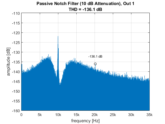

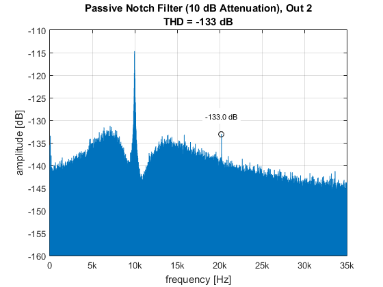

EOSC10KV3 Audio-Precision SYS2722 THD results from Samuel
Hello all,
This week Samuel as made some measurements on the 10 kHz units i sent to him.
After a little mistake from me about adjustment procedure, he finally found the way to adjust it.
I thank him very much for his patience and his effort to realize these serious measurements.
He's test has been done at 1Vrms, as for my previous tests.
He's first test has been done connecting directly the EOSC10kV3 outputs to the input of
Audio-Precision SYS-2722 analyzer. He noticed then, that all harmonics coming mainly
from the SYS2722 itself.
Then, to extend measurement capability, he has make others tests using a (very good)
passive notch filter between the oscillator and analyzer to avoid SYS2722 front end THD.
The attenuation coming from the filter at harmonics frequency is compensated by the
SYS2722 to show real amplitude level.
The resulting FFT measurements on each channel is showed below :
As we can see, the THD products is extremely low (as i expected). Much below ppm level.
The THD calculation give -136 dBV or 0.00005 % !
With only H2 visible and all the others flooded in noise floor.
I noticed also, that these results are very near my own measurements i posted on page 2
of the thread with my notch+AKM ADC setup.
It's a good new, and make me very confident about my setup accuracy.

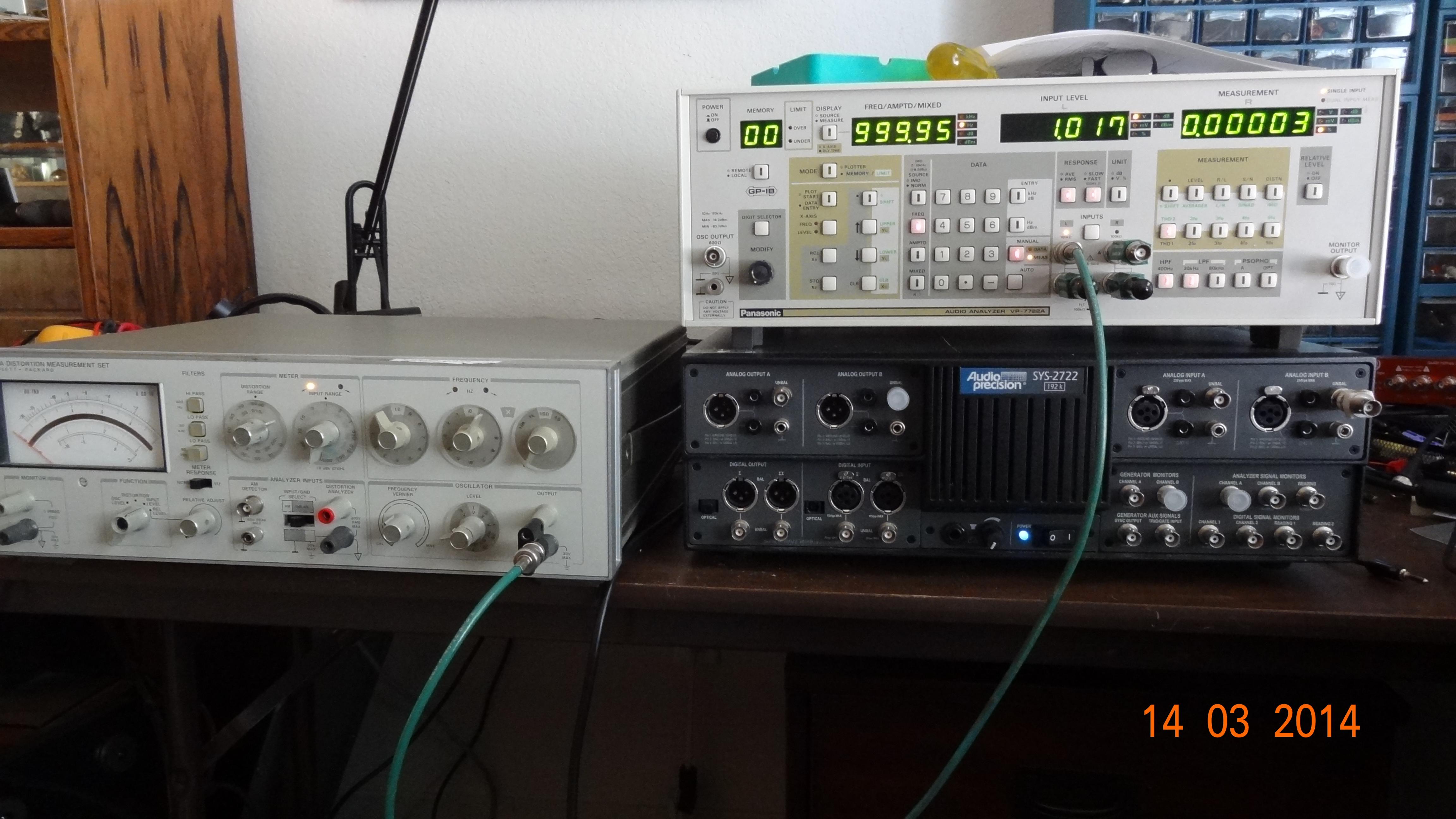

Very good.
Is there a way to calc the difference between your tests setup and SG's... as a correction curve?
This is 10X better THD at 10KHz than a modified HP339A and same if at 1KHz.
THx
RNMarsh

I think it is very difficult to create a real correction curve. Samuel can use a very deep notch filter
(i'm really impressed by his notch depth, probably auto-tuned with PLL) so the level at analyzer
input is extremely low giving THD contribution negligible.
With my setup, to show harmonics i need to add much gain and my notch filter attenuate (only)
to about -70dB so the level at the input of my ADC is much higher (about -20dBV).
Anyway, i alway tried to measure THD at a given level equal to notch attenuation to verify that
there is no (or negligible) THD contribution in signal chain.
Regards.
