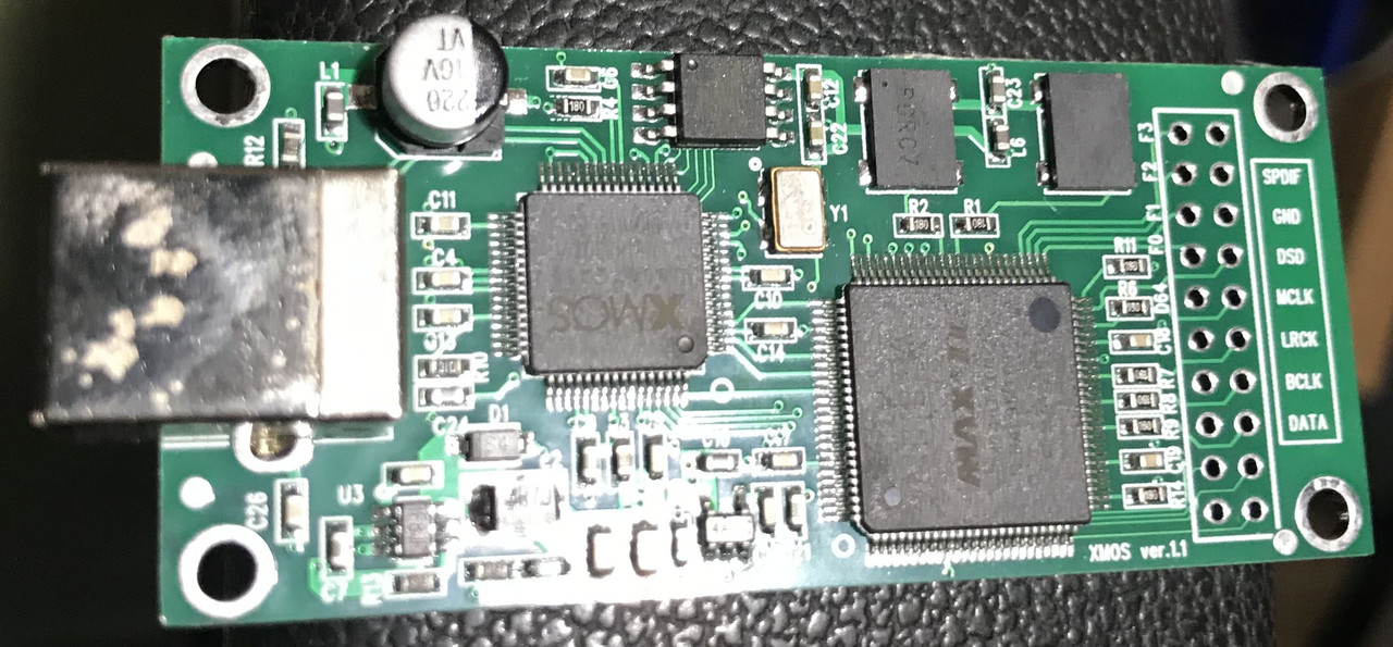

Well, fwiw, this is my actual board ... a bit of a bastard "mixed breed" ... have not used it yet. Probably will first experiment by installing in a classic Philips CD player. Wanna try to connect it directly to the I2S of TDA dac vhip. Not sure how that'll go ...

The dac chip uses I2S, verses one of the older/alternate protocols?
It worked from the first time using both TDA1543 and TDA1387 dacs (installed in the same Philips CD player), being fed from a Linux PC.
The sound fidelity was about the same as that from the default internal CD player's transport (i.e., CDM4 --> decoder chip). In fact, the USB may have sounded slightly inferior. But at least it worked, from the get-go, with no additional noise or distortion. And connection to Linux was transparent ( as always!).
The CD player was already quite heavily modded, with a discrete I/V and output stage, etc.
