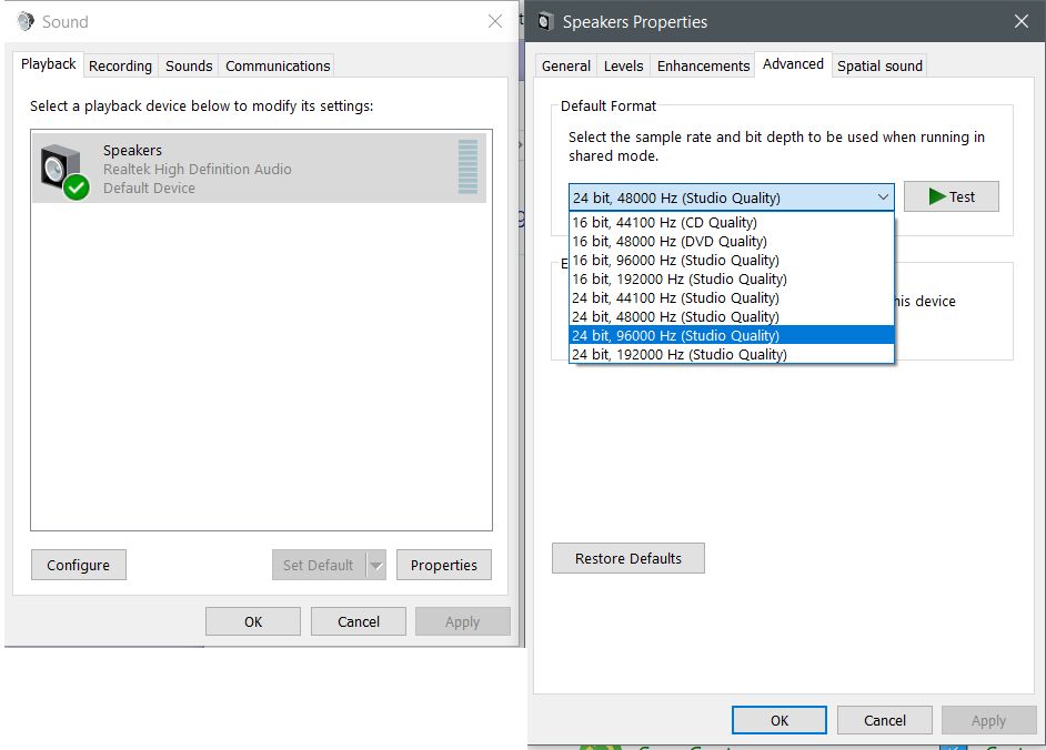

The Windows settings I was talking about are in the Windows Control Panel/Sound applet. In the screenshot below, one can see the green circle checkmark next to the audio device. If there is a green checkmark due the device being set as a Windows 'default' device, then sample rate will always as shown in the configuration panel on the right (and any automatic resampling will not be good). Therefore, at least two sound devices are needed, one to assign as the default device and the other to play music.
