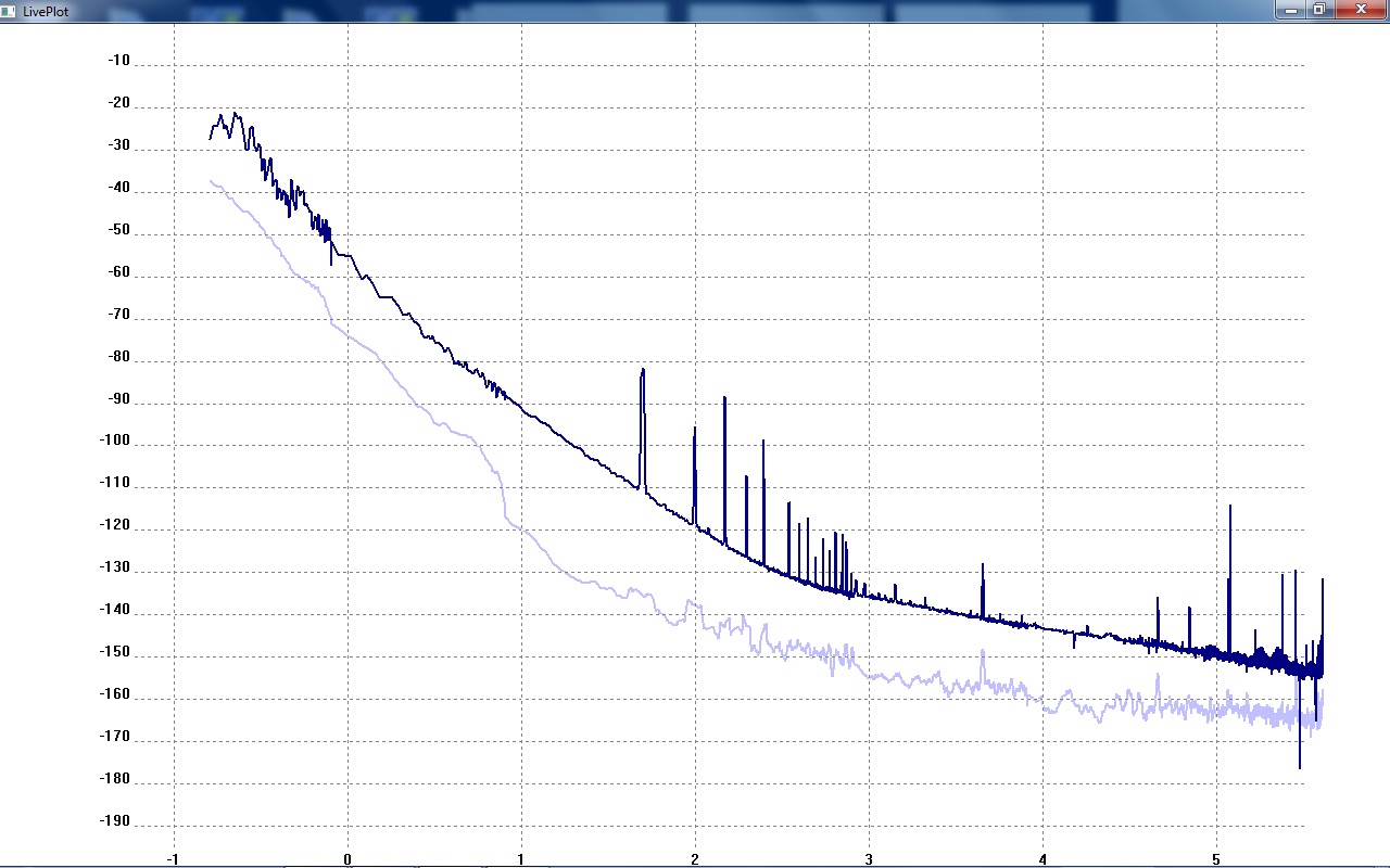

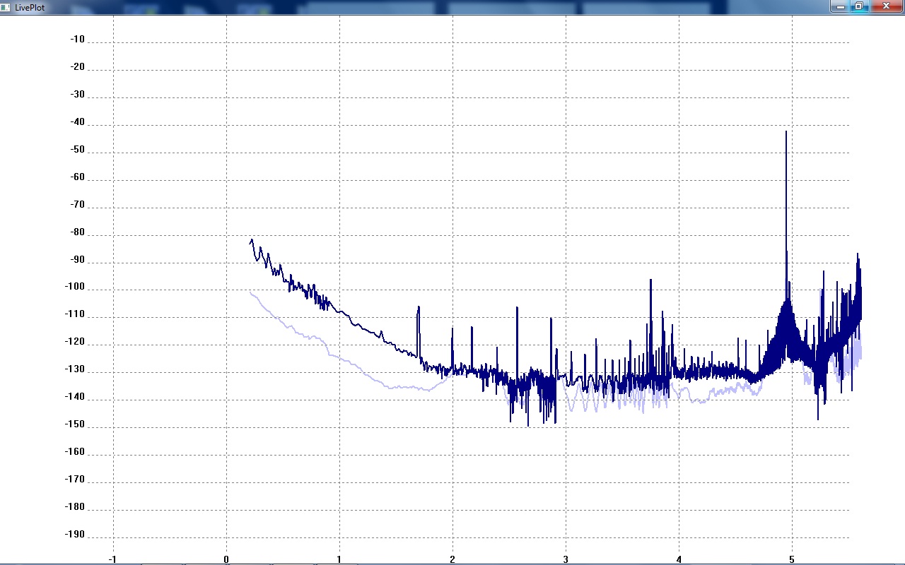

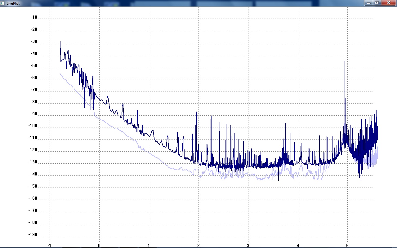

I think here I can contribute some.
These are phase noise plots taken at the MCLK output pin of a Diyihk DXIO 768k converter.
First is the 'default' output, with onboard (USB powered) supplies, and OLED display connected.
Onboard clocks are NDK SD 45/49MHz oscillators.
They get through a 74AC74 flip flop to be divided at the MCLK output by two, that is 22/24MHz.
Second is the same, divided by two output, but no OLED display included.
Third plot is the same MCLK, but an inner jumper selects a direct forward of the NDK SD oscillator, plus the provided external PS option is used. The frequency now 45MHz.
Have fun!

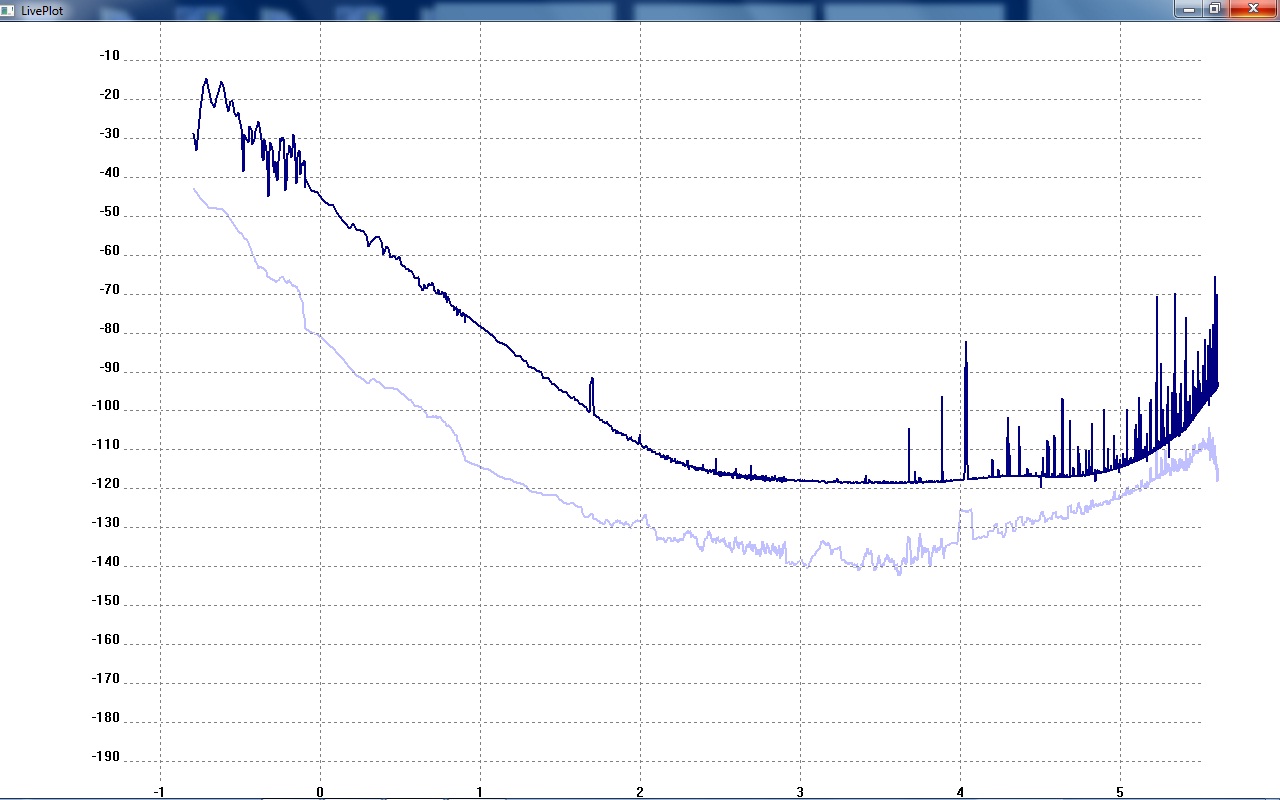

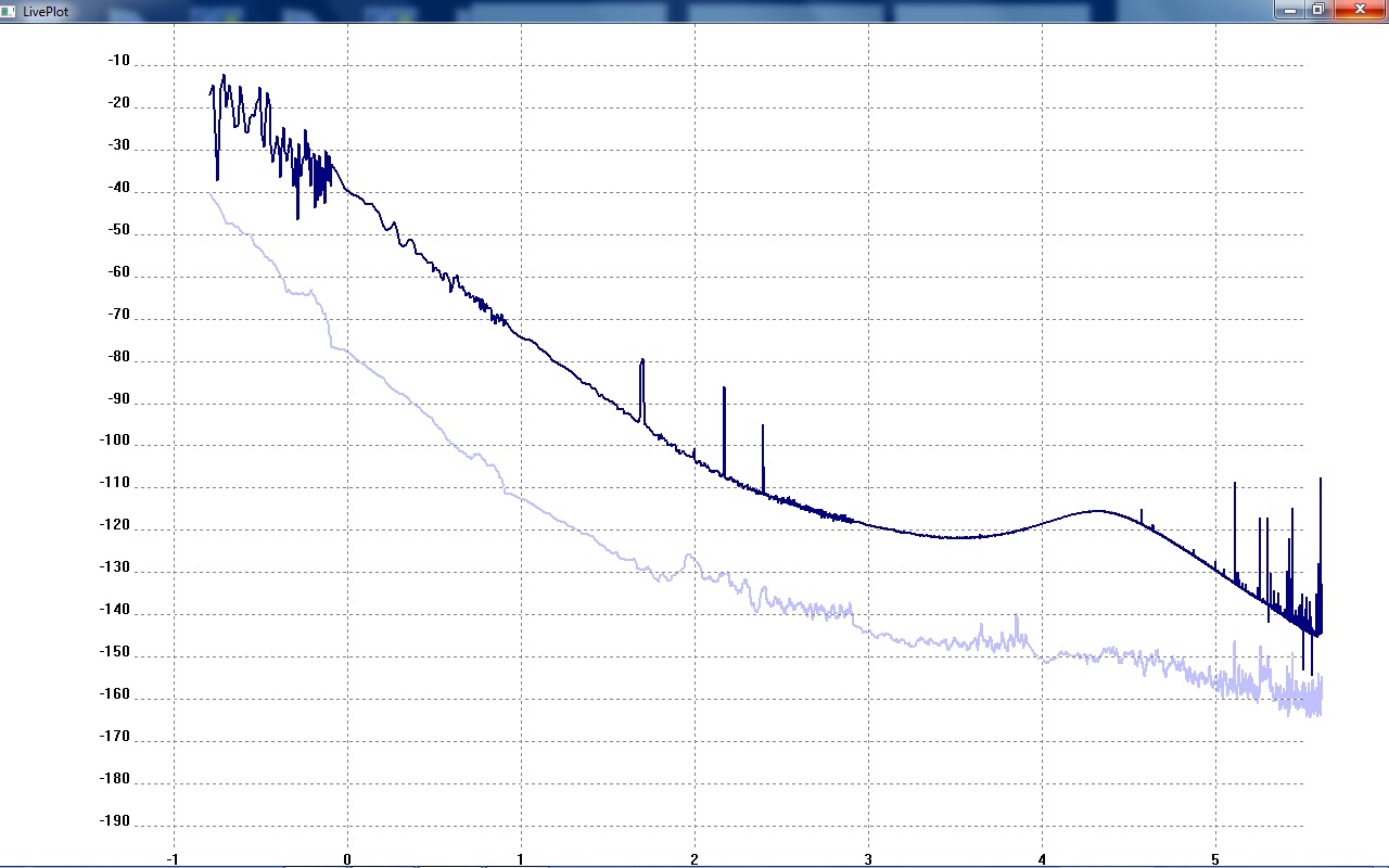

As in the Diyinhk board, also the JLSounds board permits also the direct access to the original, undivided oscillator frequency, in this case a FOX Xpress0 45MHz oscillator. Here it is the phase noise spectra of the 45MHz original clock.
The noise floor is lower, that was the contribution of the on board flipflop in the JLS board.
Also it can be seen that the FOX oscillator is a synthetized one, with the characteristic 'skirt'.
