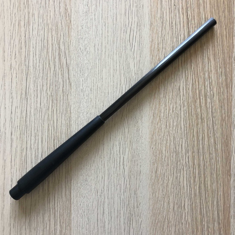

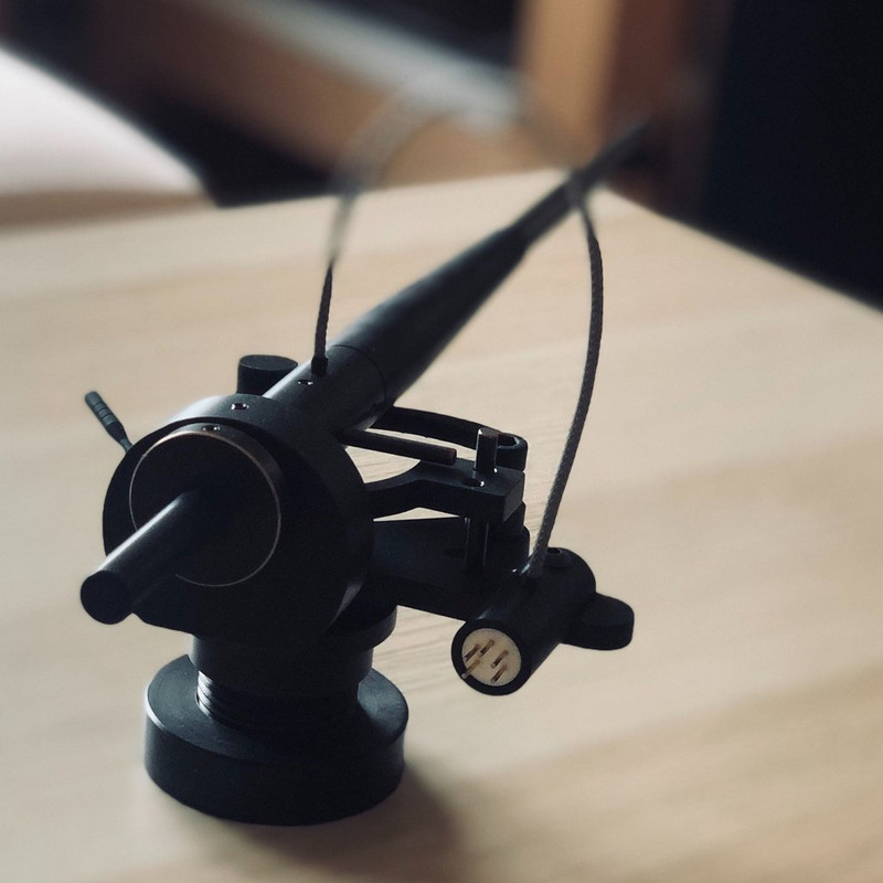

This is an excellent effort @warrjon - kudos. I know how difficult a manual taper can be.
May I ask - did you first machine the outside and then drilled the inside?
Have you thought about using dissimilar materials? For a few of my experiments, I used friction fit pultruded carbon fiber with aluminium and POM (Delrin), then machined together as a whole.
This is the only photo I currently have - will try to find the second armwand (I built several) and photograph it alone if you feel beneficial to the thread.

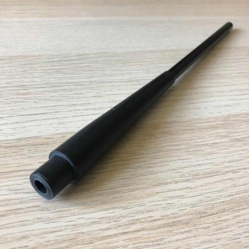

My initial approach was to build a "universal" bearing housing that facilitates easier armwand swapping. There is a potential loss in rigidity with said approach, but it allows for faster prototyping and experimentation. It worked as a final solution in my case because of the dissimilarities of the properties of the materials, but YMMV.
Here are two shots of a spare tonearm wand (some bits missing like mounting holes and slots), but you should get the idea of how, in my case, different materials are first mated and then machined together.
