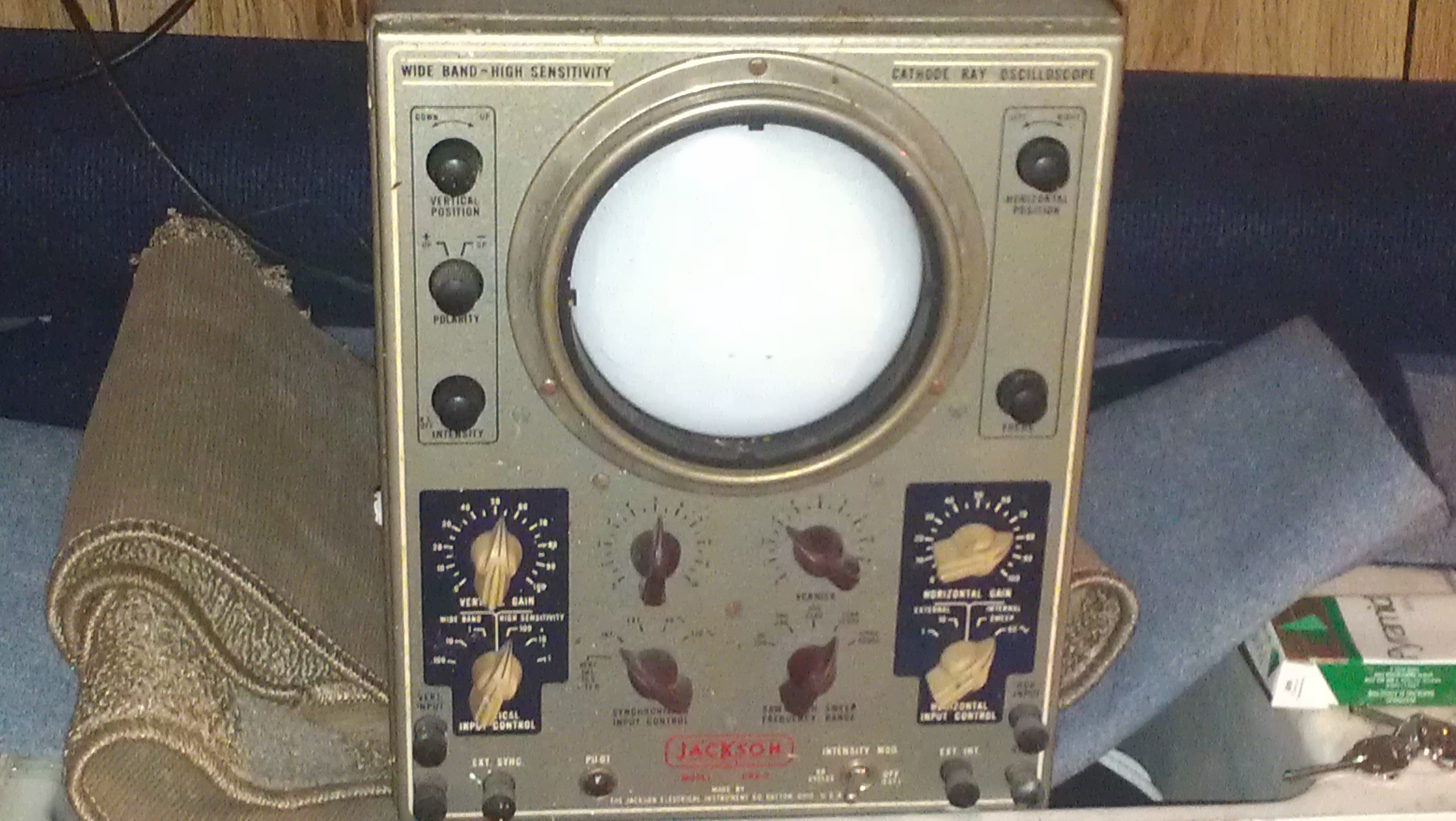

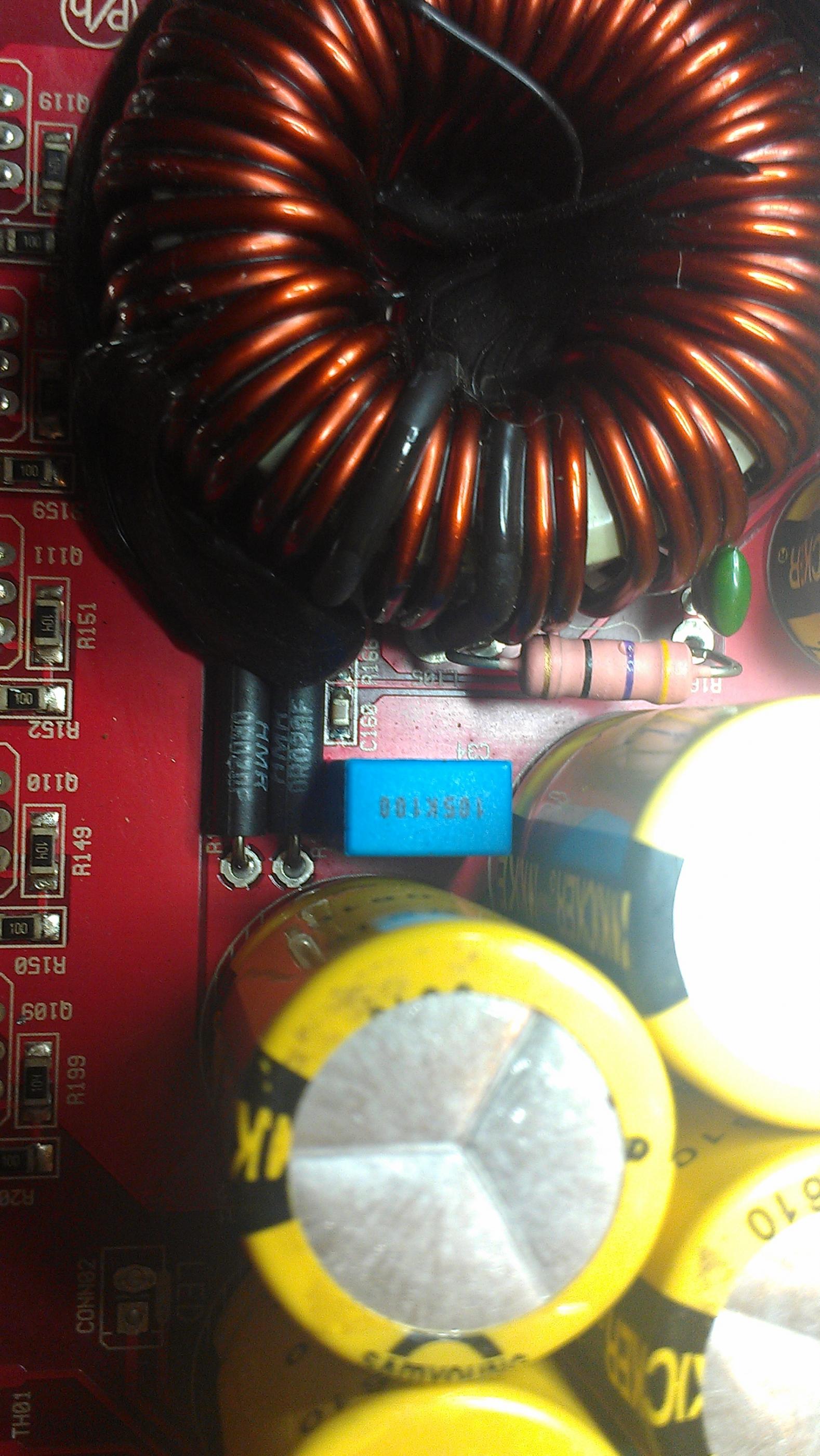

Ok I went over the board with a magnified lamp and the only thing I found was a possible bad connection on a blue rectangle close to 4 capacitors marked 105K100, I resoldered it, should I put the rectifiers back in and try it or should I wait. My dad mentioned my grandfather had an old scope in the basement would that possibly work? Im not sure how old it may be.
Post a photo of the component that had the bad solder connections.
Old scopes are OK as long as they have a triggered sweep. What make/model is it?
The scope I have access to is an old tube type scope so Im not sure it will be what I need. What would the scope allow us to do?

Post a photo of the front panel of the scope you have after confirming that it works.
That scope would do everything that you'd need for most all repairs. Do a completed item search to see what they sell for. I'd expect it to sell for over $200.

I doubt that that would be usable.
