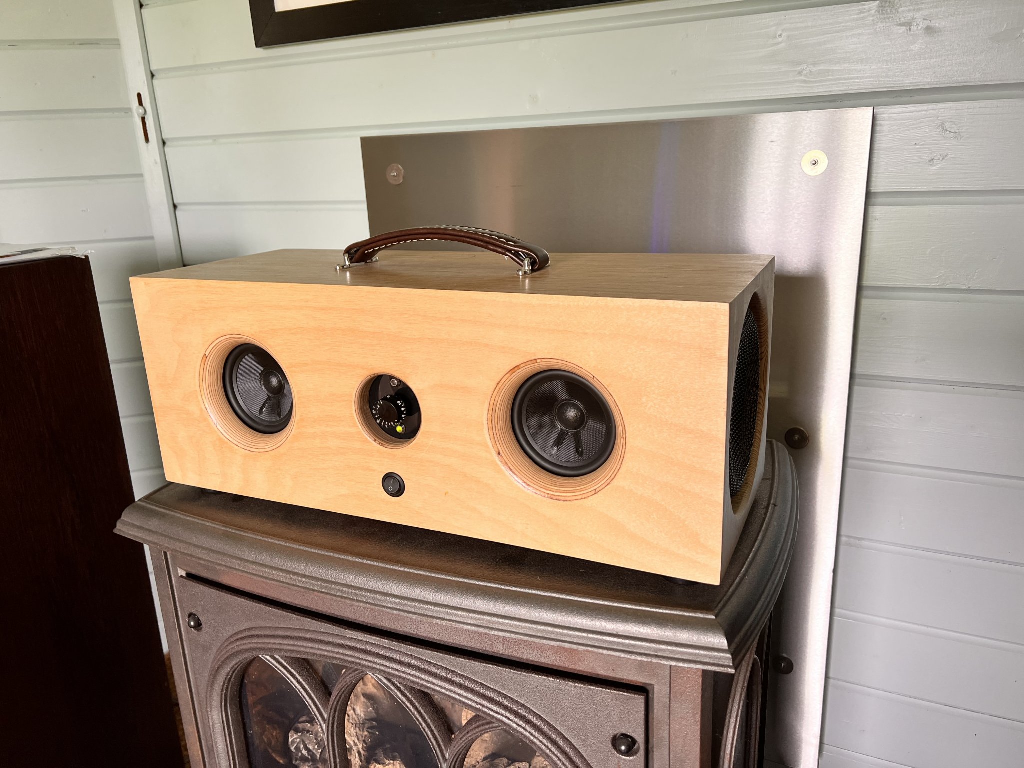

I have finally found some time for myself and have downloaded V2.10, done a few REW sweeps, and added some EQ to my 4x fullranger (diploe) boom box. Nice.

Nice looking box! How did you do the "chamfer" around the smaller driver cutouts?Thanks.
The box is made from 12 pieces of 18mm plywood laminated into one piece.Nice looking box! How did you do the "chamfer" around the smaller driver cutouts?
I cut the driver holes with a straight router,before assembly. I then made another hole on some scrap wood and temporarily screwed it to the rear of the baffle. I then used a 24mm roundover to create the "waveguide" and afterwards removed the scrap wood which had aligned the bearing on the roundover bit.
A sculptor friend said that he enjoyed the "conflict" between the sharp straight sides and the smooth roundovers. That is what I was aiming for.
The box has three chambers, the middle one accessed from the bottom has all the electrics (Jesse's board and a 6s6p Li-Ion battery. The speaker chambers are accessed by the passive radiator cut outs at the ends. The drivers are obviously rear mounted.
