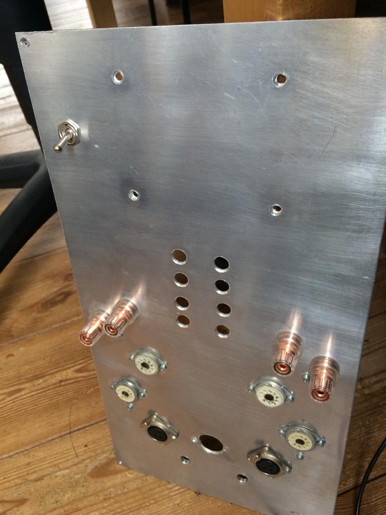

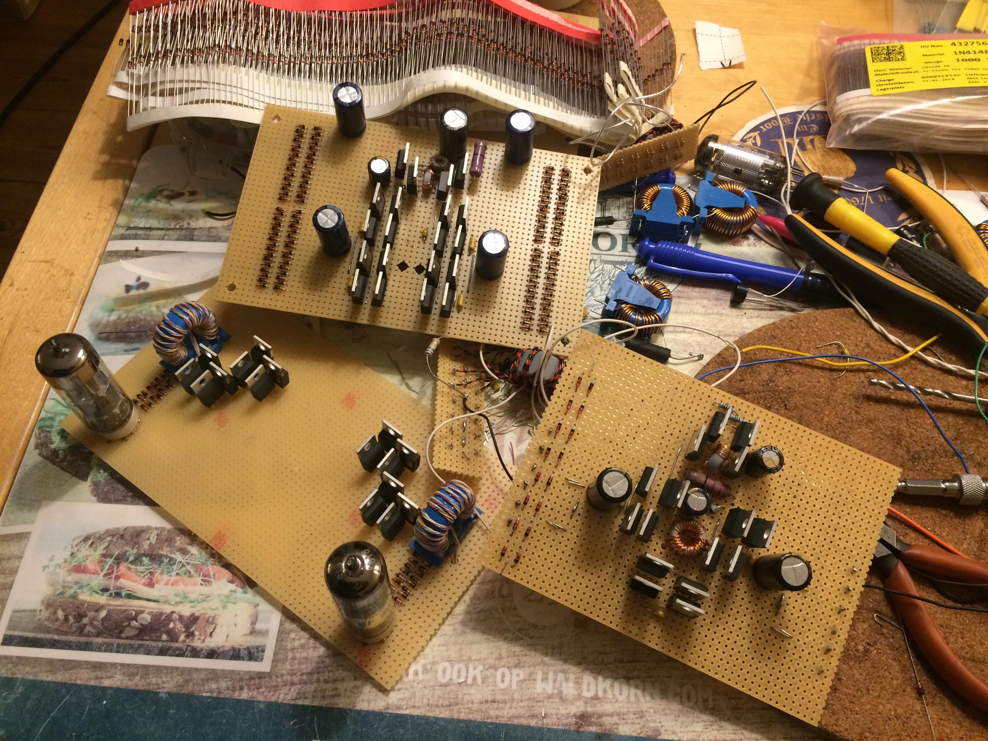

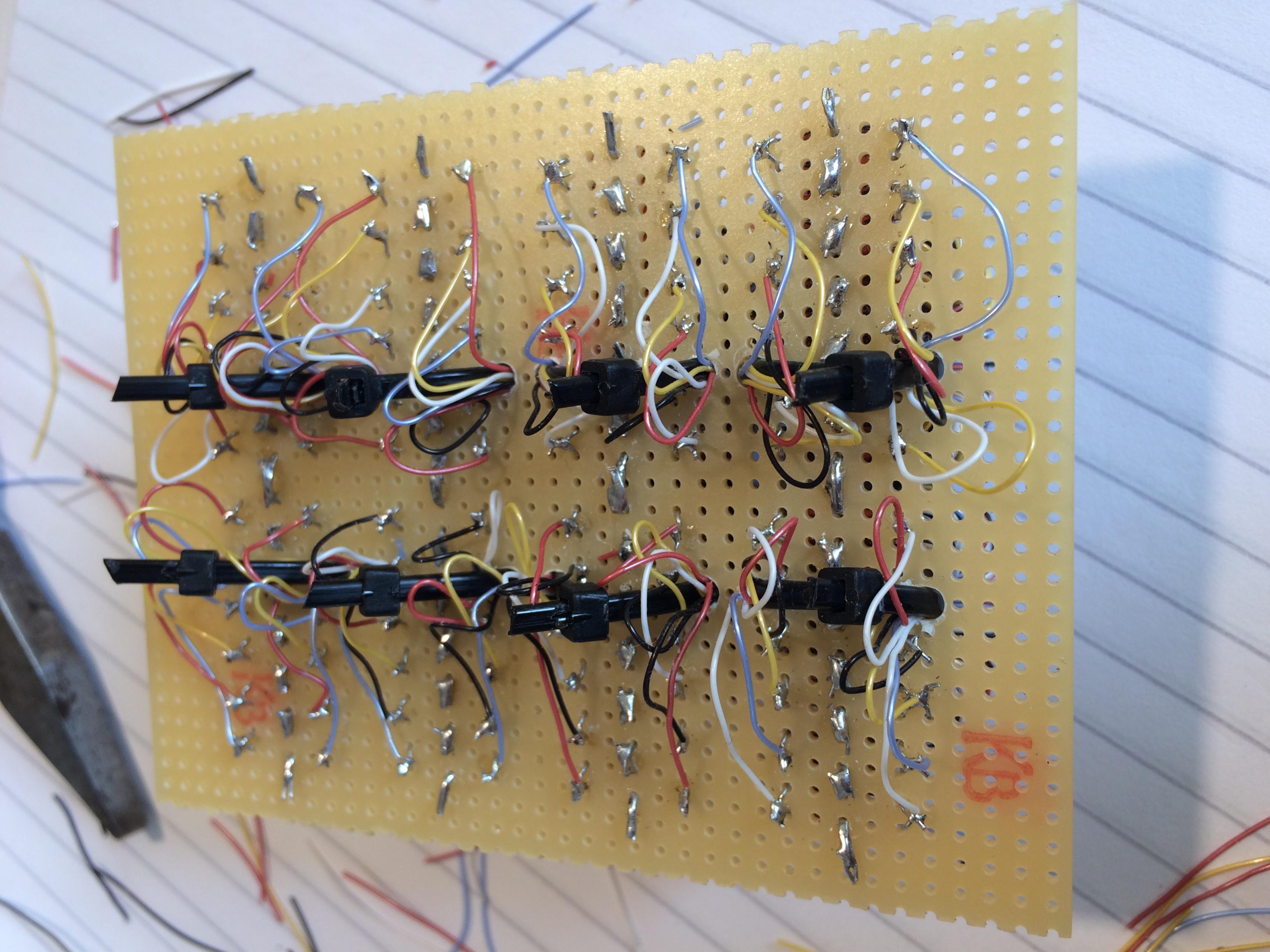

Finally i started on my Quadrature Z amp... i will place some pictures of the progress....
First the driver stage/phase inverter using a EF80 or EF184 in ultra linear mode. With this i will try to drive EL84 output tubes as these are easy driven. Later i will try other tubes depending how the driver performs.

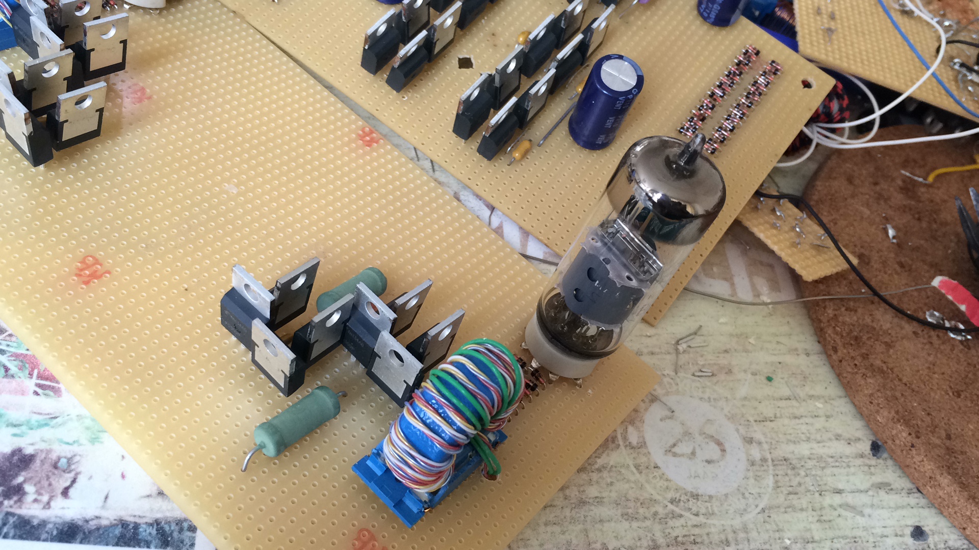

The driver/phase inverter now works fine but it has not enough voltage swing to drive any screen grids. Naturally i could change the ratio of the transformers but then i prefer the old fashioned driver with high dc voltage as changing the ratio also requires higher DC voltages.
This driver stage is perfect as headphone amp (Quadrature Z) or balanced line driver where current is needed.

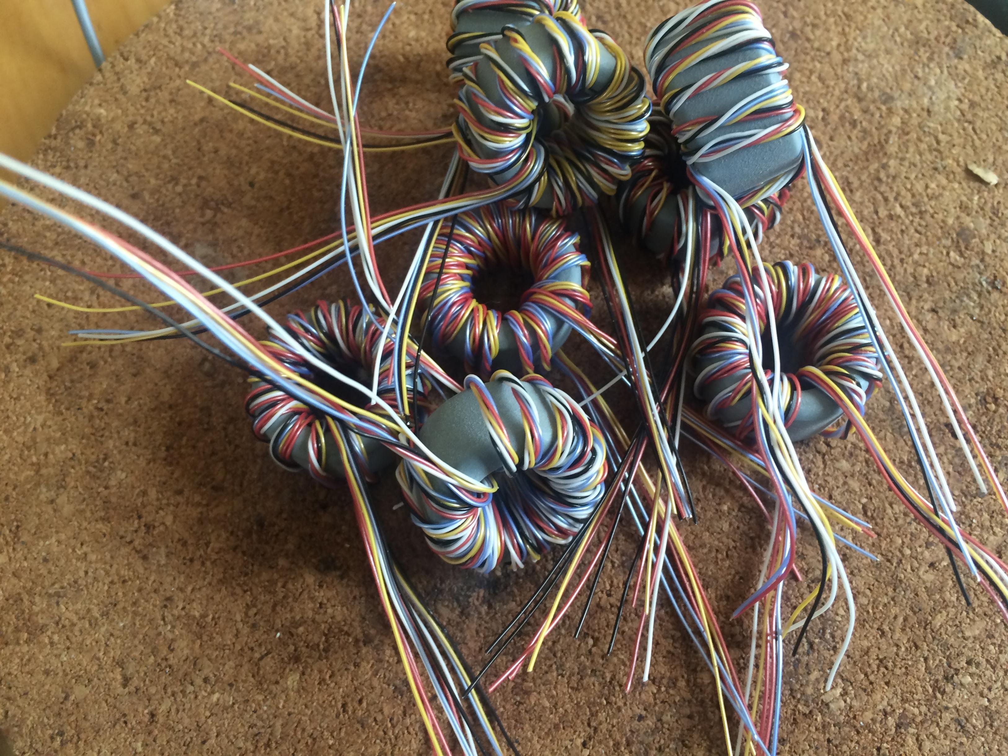

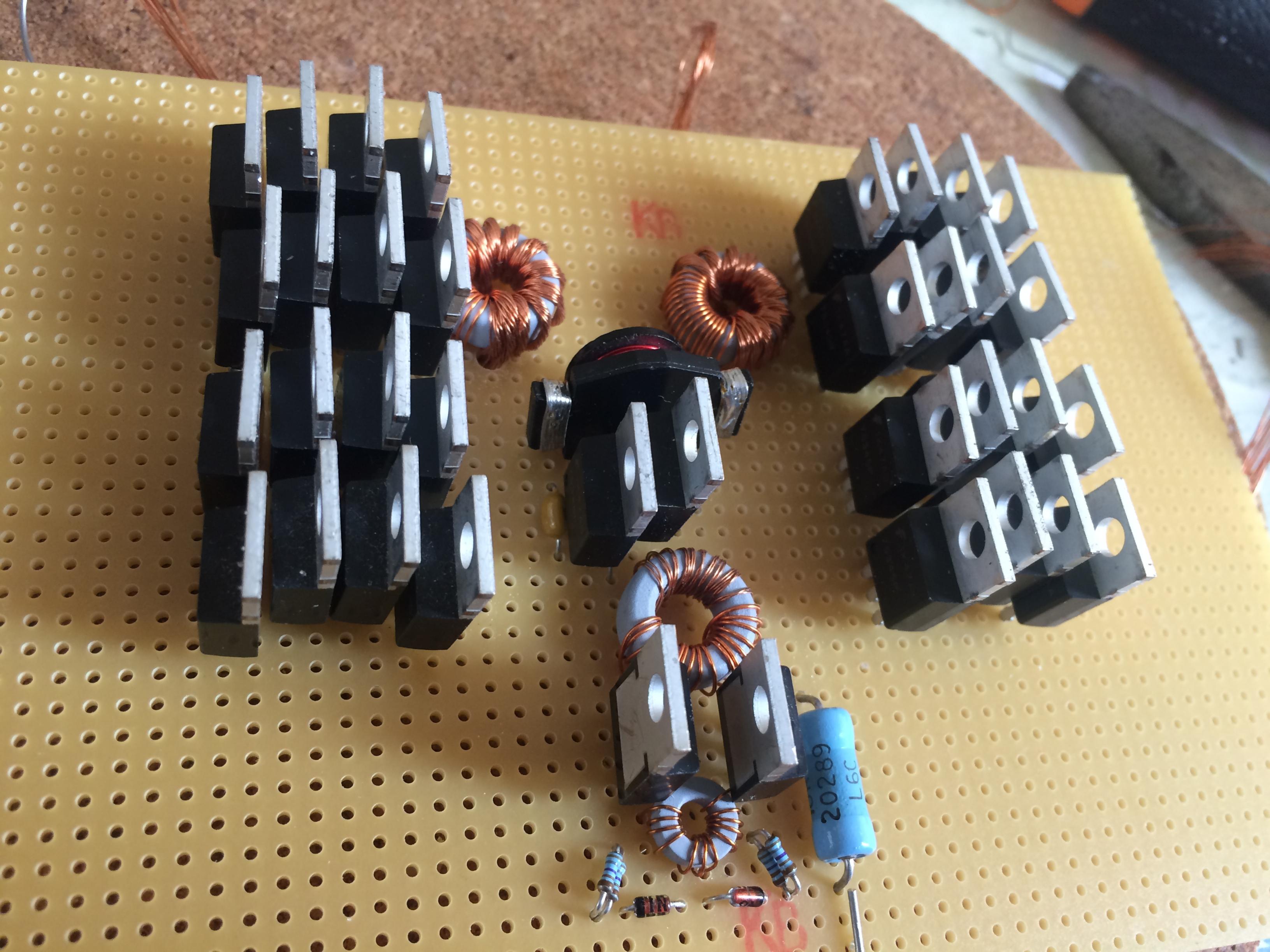

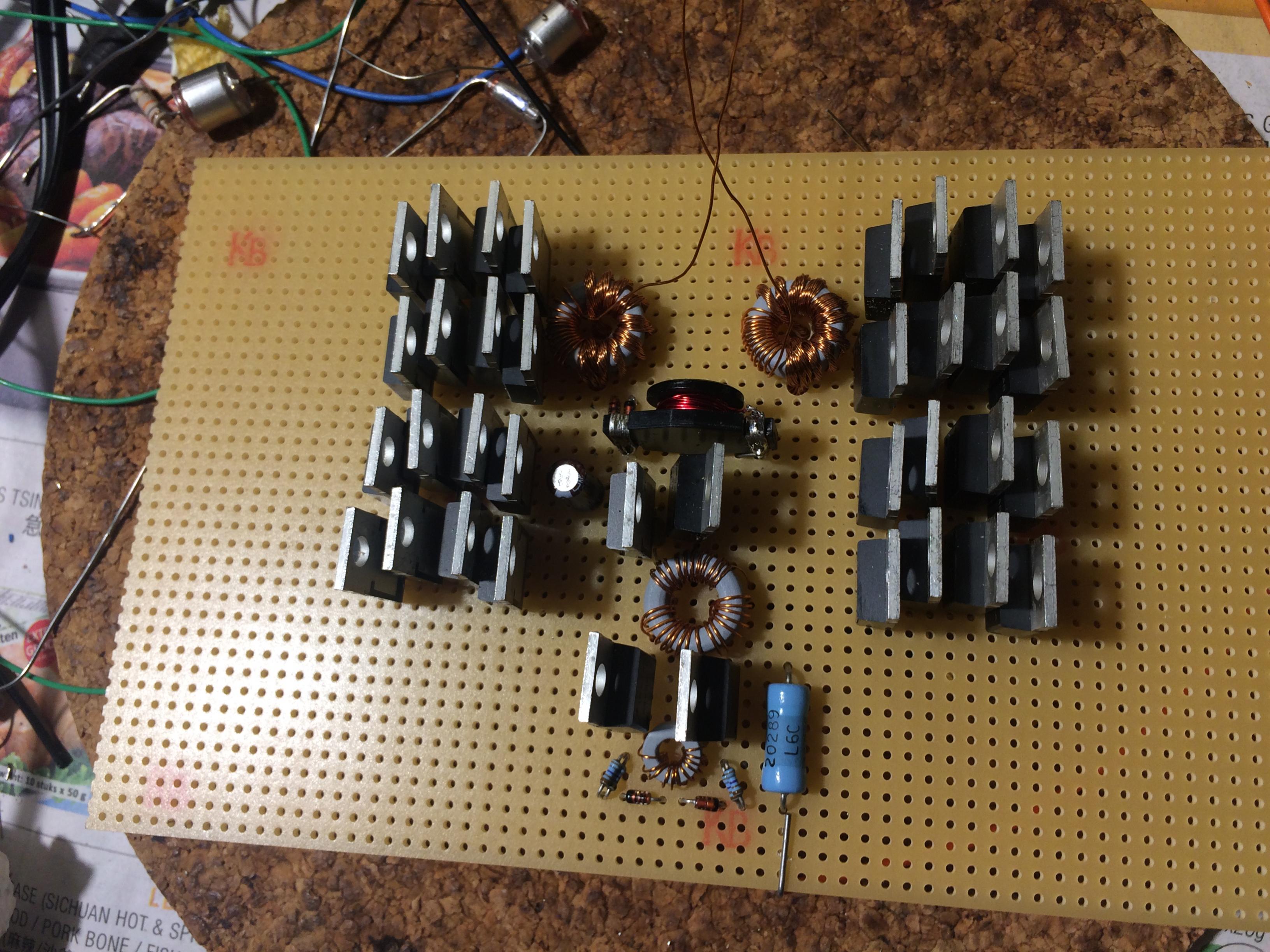

The core material is from a standard PSU common mode choke i found in an electronics dump store. Therefore i am not sure about the exact value. I tested this and found it satisfactory...
... Building big Zotls need higher voltages and big Mosfets plus double/parallel impedance converters....
Thank you for the links. I was just trying to get rough idea on the core that works for you, I have a few contacts in recycling business selling harvested cores from broken atx supply. I am guessing that 2 pcs of a 33 mm OD would do for an EL34, probably stacked. It will be a very long journey for me so any help and share of experience is greatly appreciated.
Common mode chokes work best for me but the ferrite transformers used in SMPS power supplies are no good as these work at about 30KHz. Best thing you try with less power first and then crank it up until it starts to distort (not too long otherwise your transistors will fry) , that's how i do it.

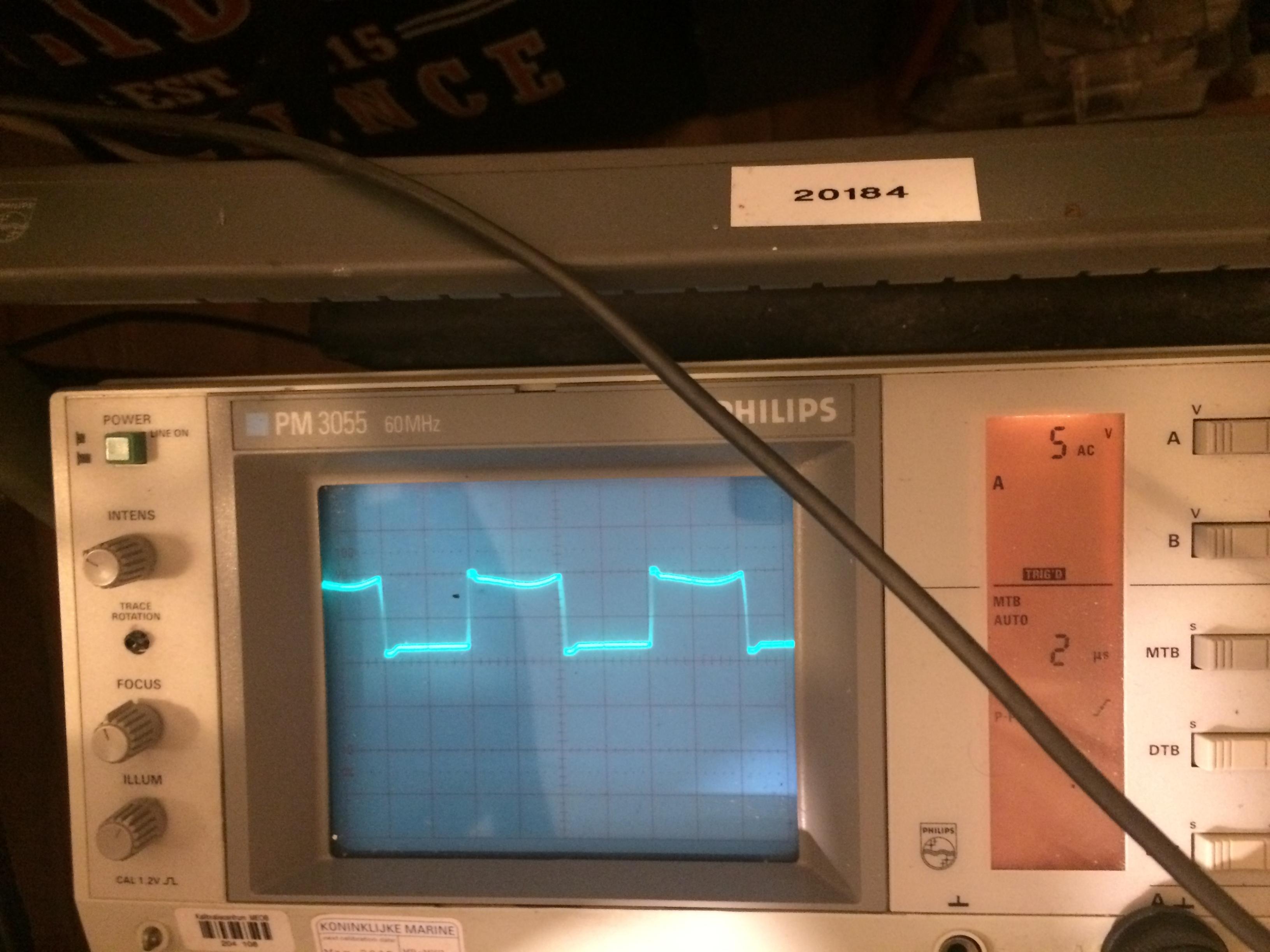

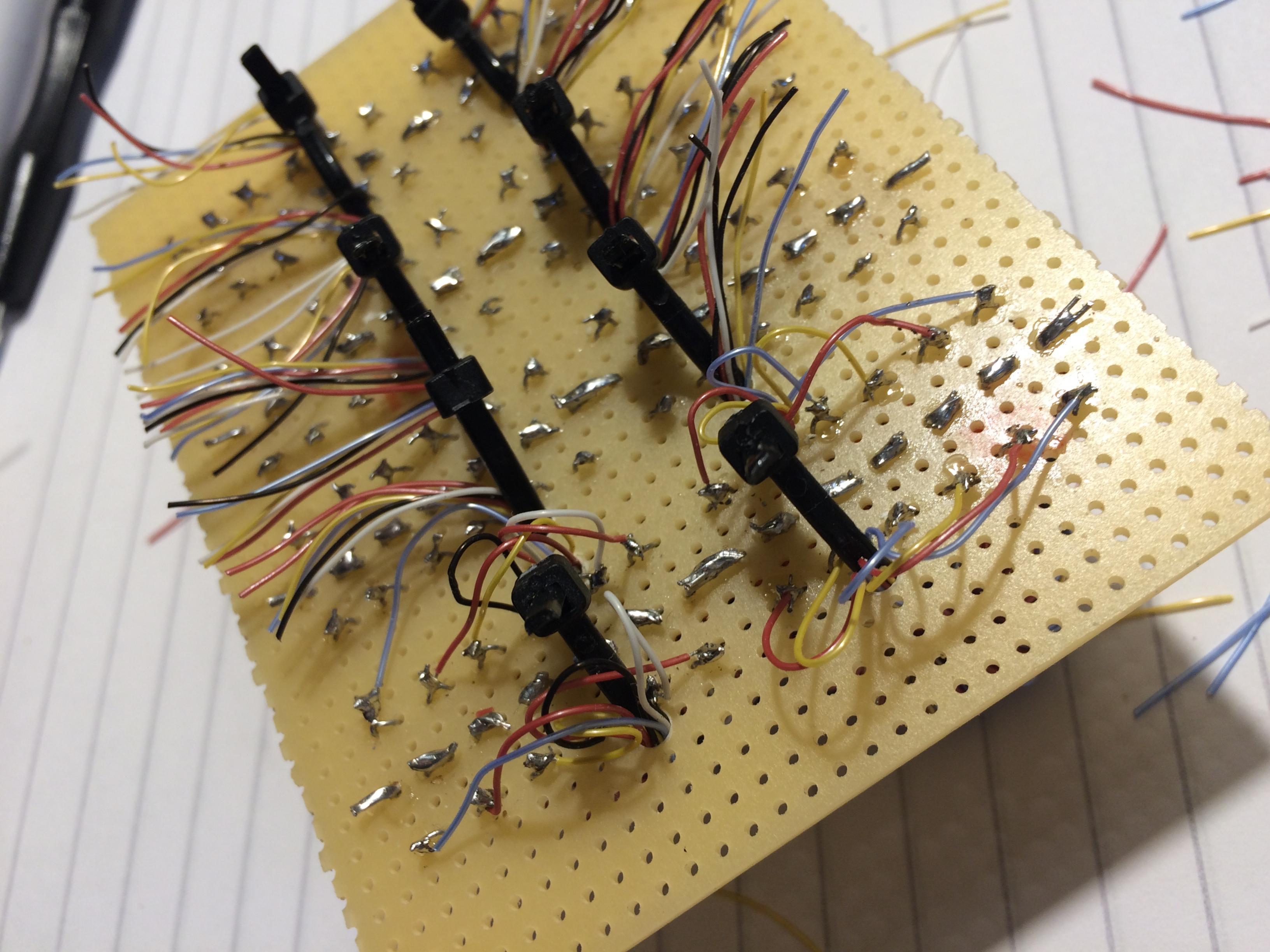

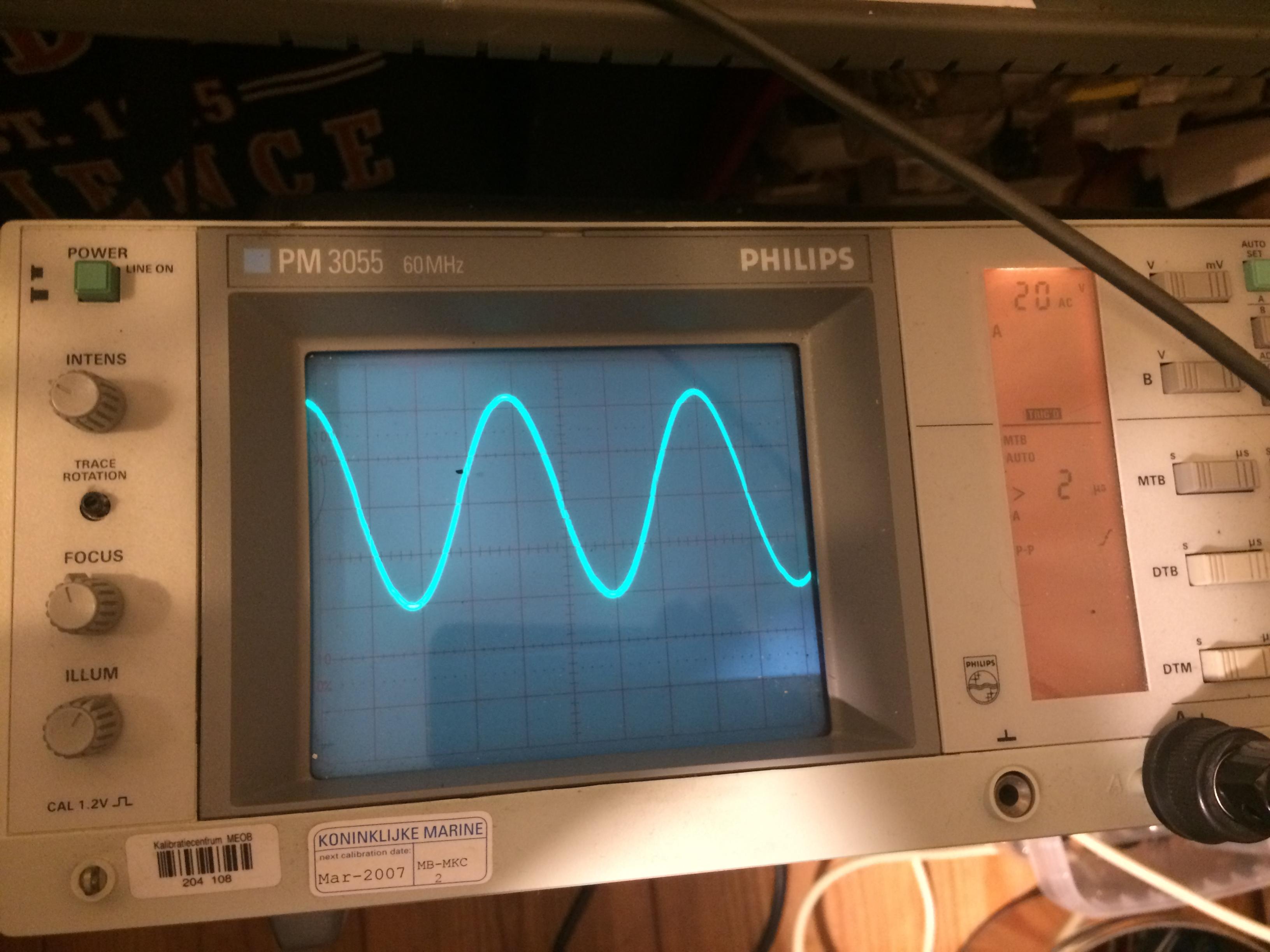

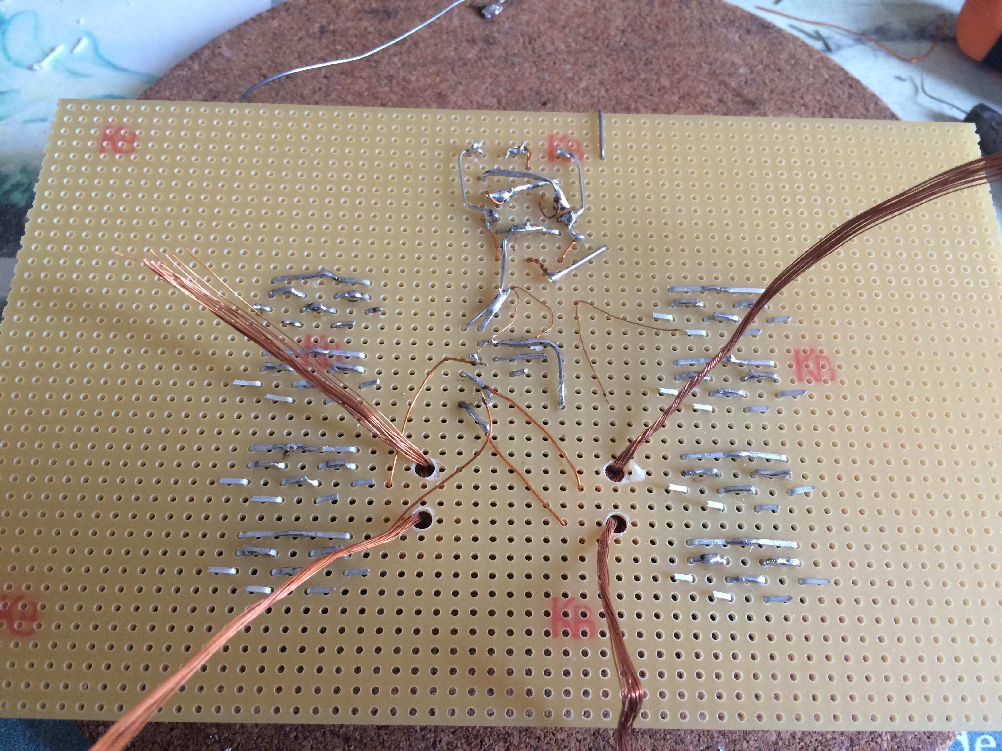

Not the most beautiful square wave but it will work just fine... all 32 mosfets will be switching... (i hope).
