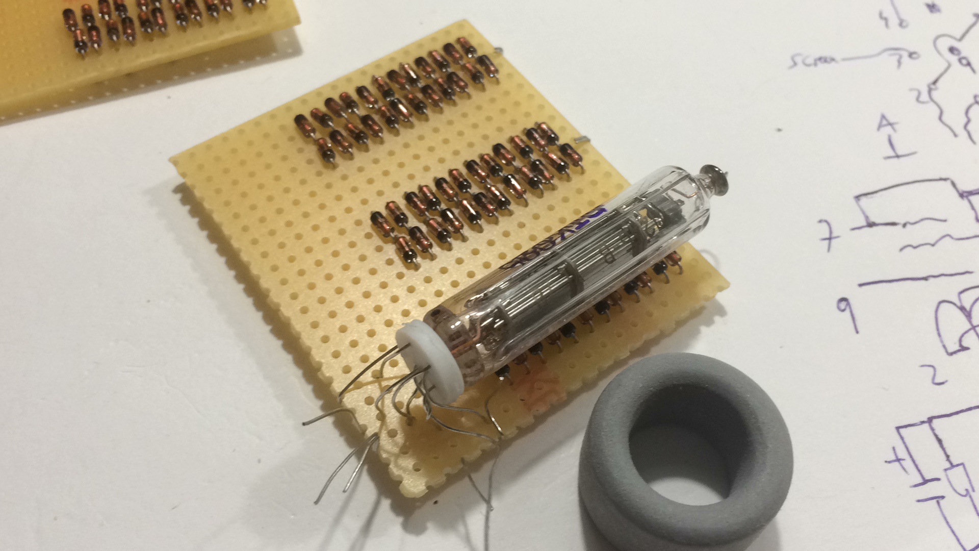

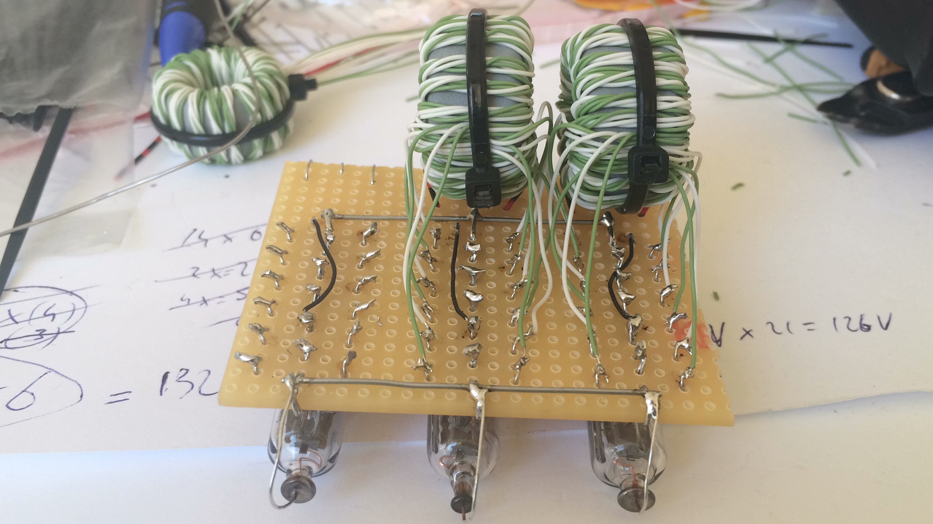

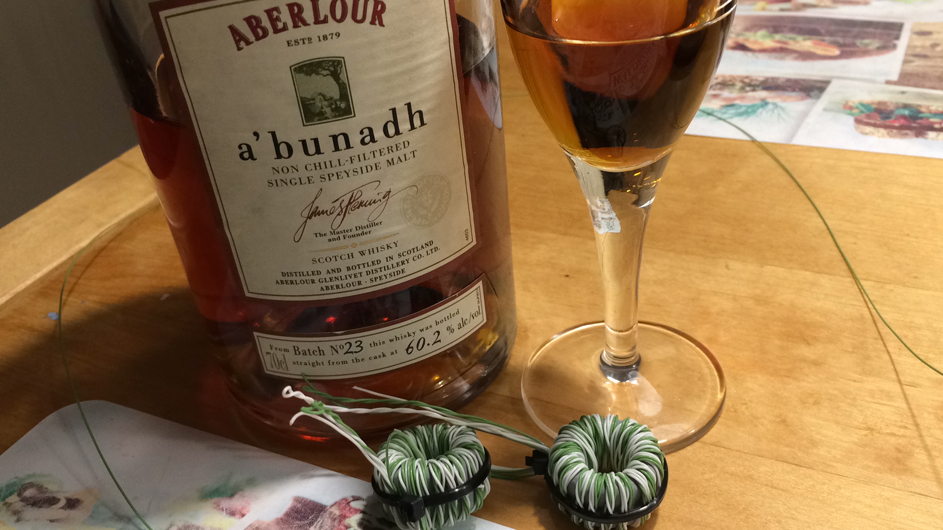

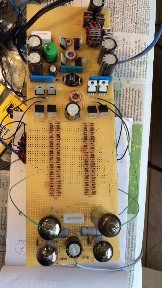

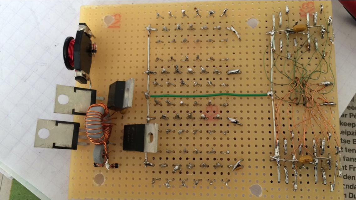

The core material is from a standard PSU common mode choke i found in an electronics dump store. Therefore i am not sure about the exact value. I tested this and found it satisfactory. The schematic of the amp is attached but the Zotl part can be found on David's website (user manual of Microzotl). Instead of 12v i used 7v as it was convenient for me.

And how does it sound? It kinda has a carrier of 250Khz as I remember... I've done classD amps and I can say that with the right parts and the right filtering you can't hear the difference from solid state AB to solid state class D.
Can you share some more of your ZOTL experience? I find it fascinating being a switching guy that started playing with tubes :D
This is not my first Zotl (i am a fan). I can say from my experience that it sounds very clean like any good OTL amp and you can hear the differences of the used tube but the class is not class D or C at all. It is class B or even A if you would like. However it switches the tube on/off therefore the duty cycle is 50% and the tube will get less hot even in class A. In my case i use 500Khz as a carrier frequency. It has a bass response of a transistor amp and goes all the way down to 20Hz (easy) even a small amp like this.

I have some dual mosfets for classD (halfbridge TO220 looking but with 5 pins) and some HIP4081 I was thinking to buy some ferrite pots or toroids for the HV transformers.

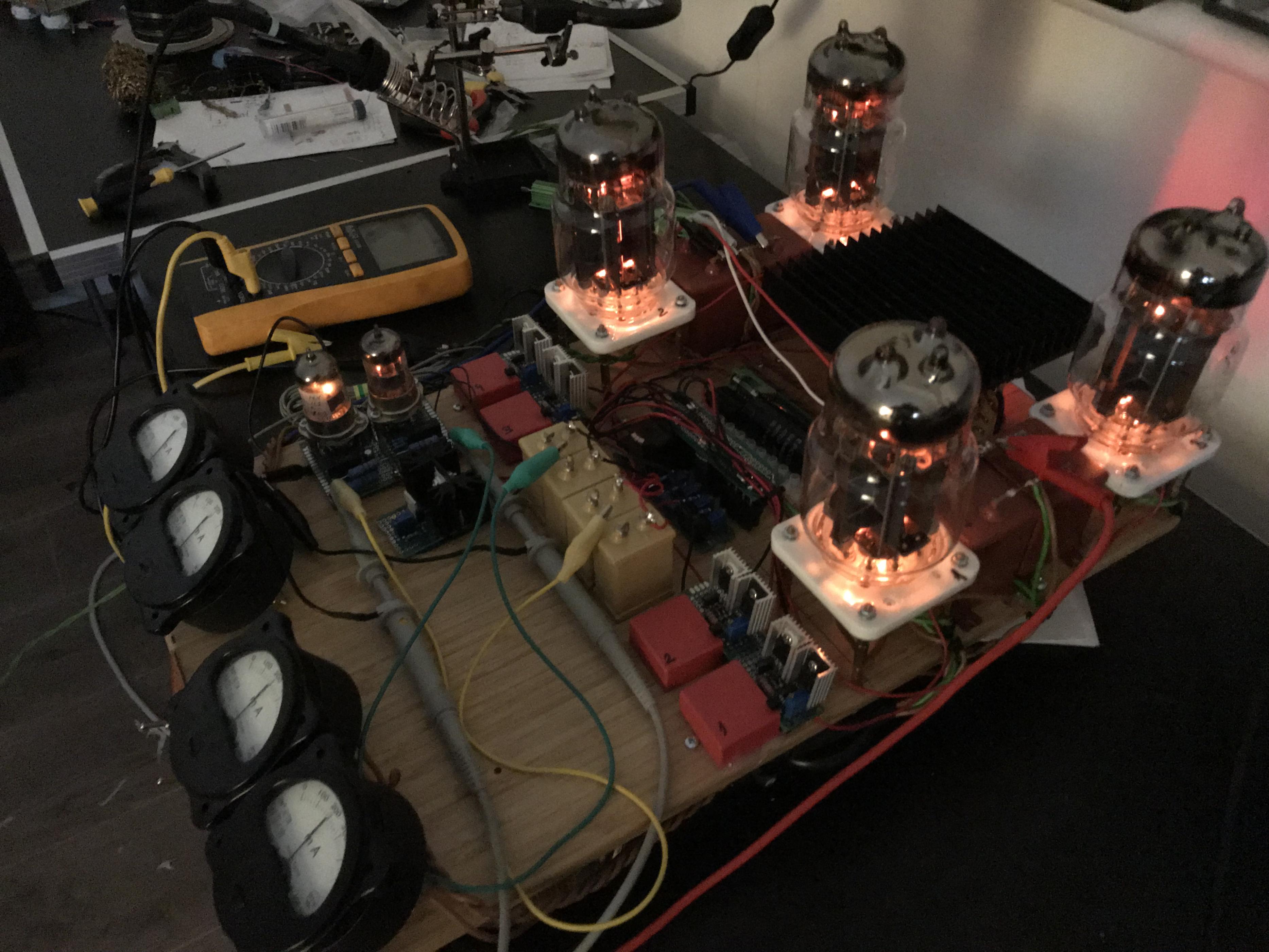

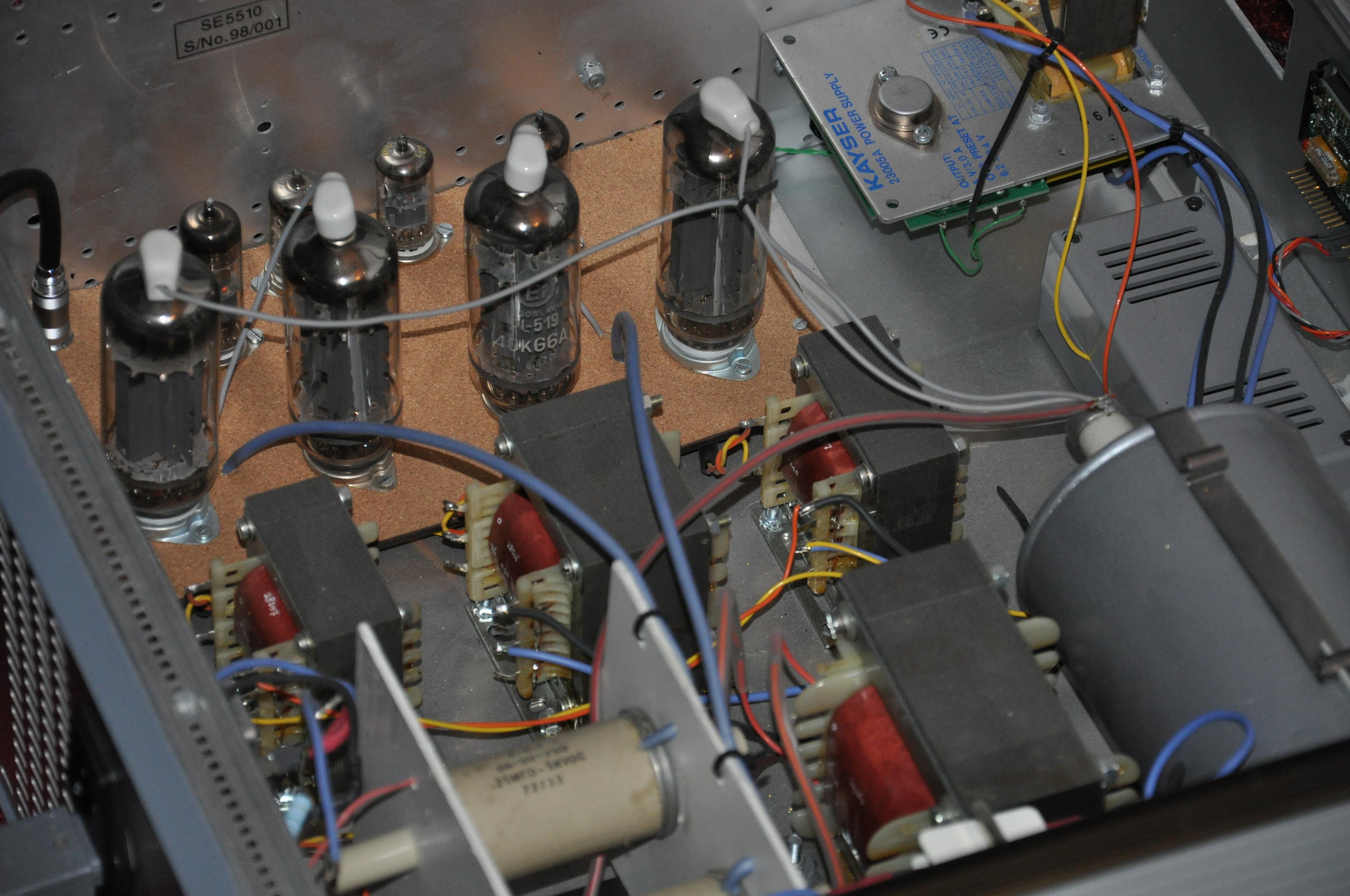

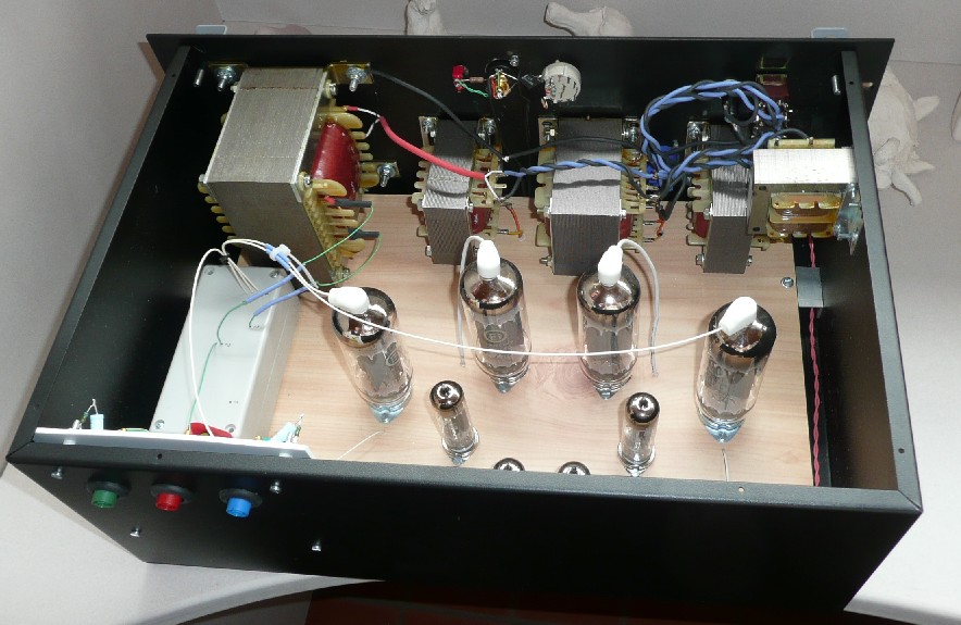

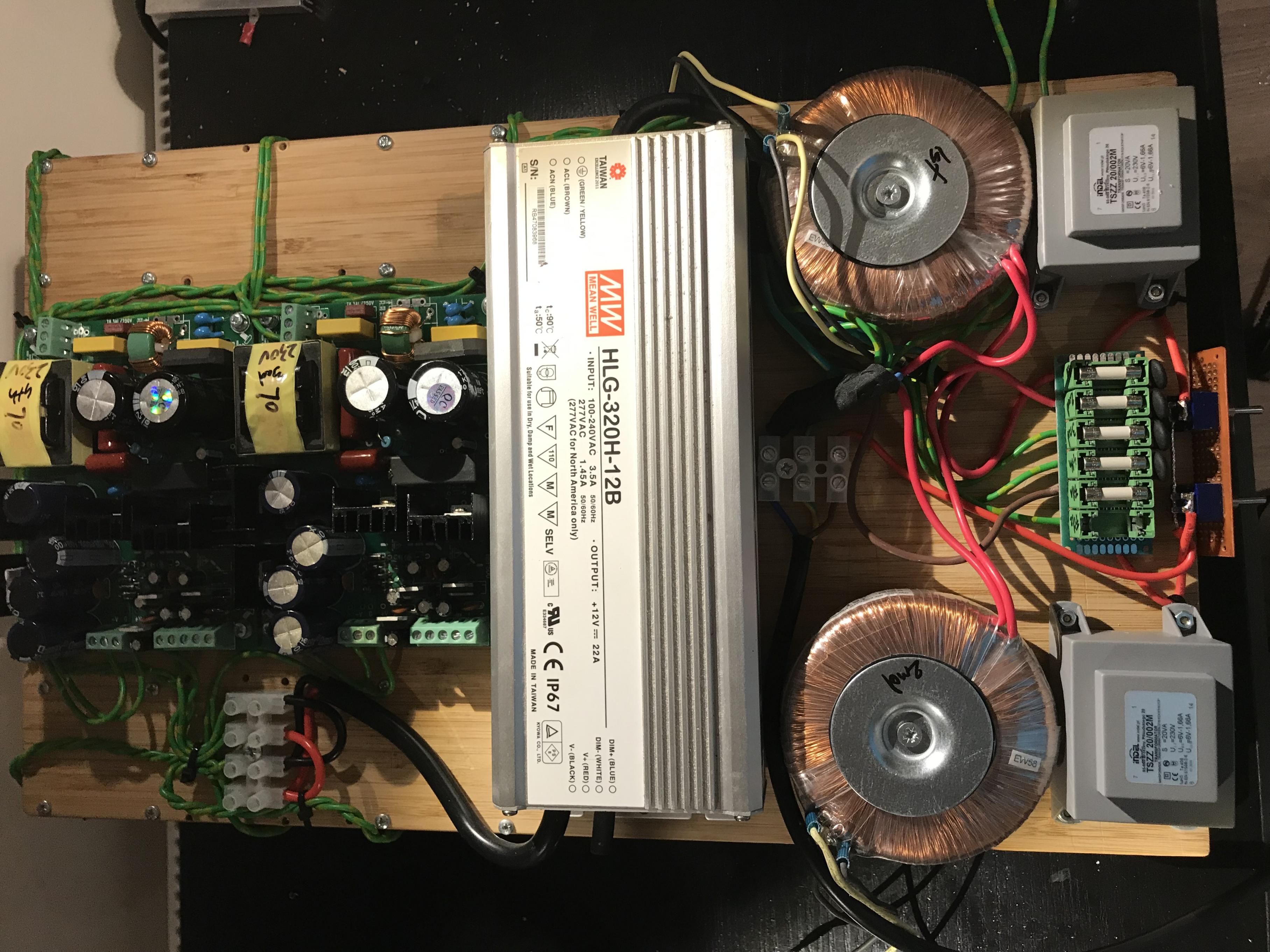

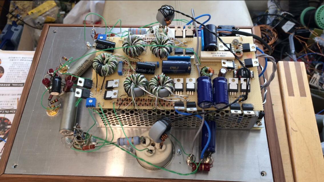

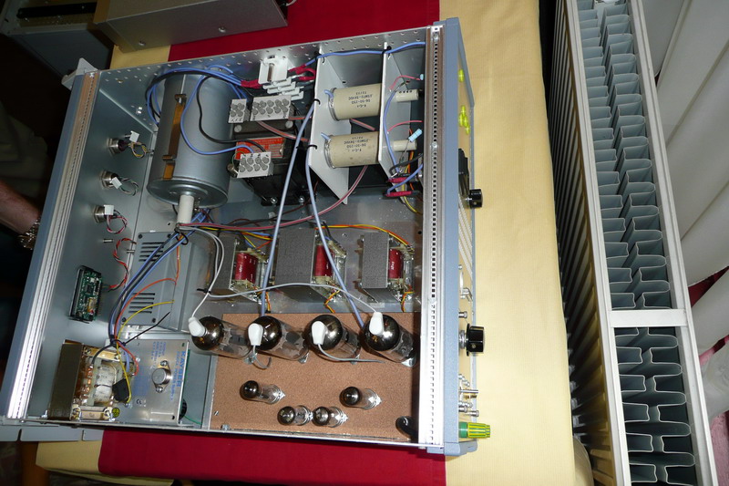

I have build a single ended Zotl (300b, SV527-10 and 6L6) plus some small push pull amps. Nothing real big until now. I have build HV amps as well (direct drive ESL amps).Please see images.
Building big Zotls need higher voltages and big Mosfets plus double/parallel impedance converters. Big tubes are not required with Zotl because with small tubes you can get enough power, opposite from standard OTL's.

That's the most beautiful thing I have seen, tubes and switching electronics... It can't get better than that...
You use pulse transformers because it's easier to wind or because you don't need the precision that specialized PWM mosfet drivers have?
Have you considered using SiC diodes for the output bridges?

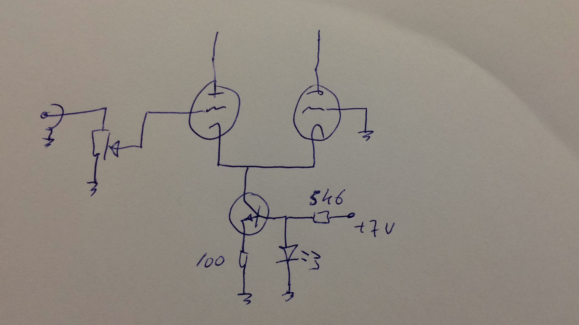

How do you manage the single ended? You sit it on a CCS?

I use the transformer cores as these were at hand , no special reasons.
No SiC diodes here as these are too slow (maybe). IN4148 are faster anyway and sufficient in my case.
No CCS as load but simply a heater of an unused tube (EL86 in this case depending on output tube used as i am lazy).

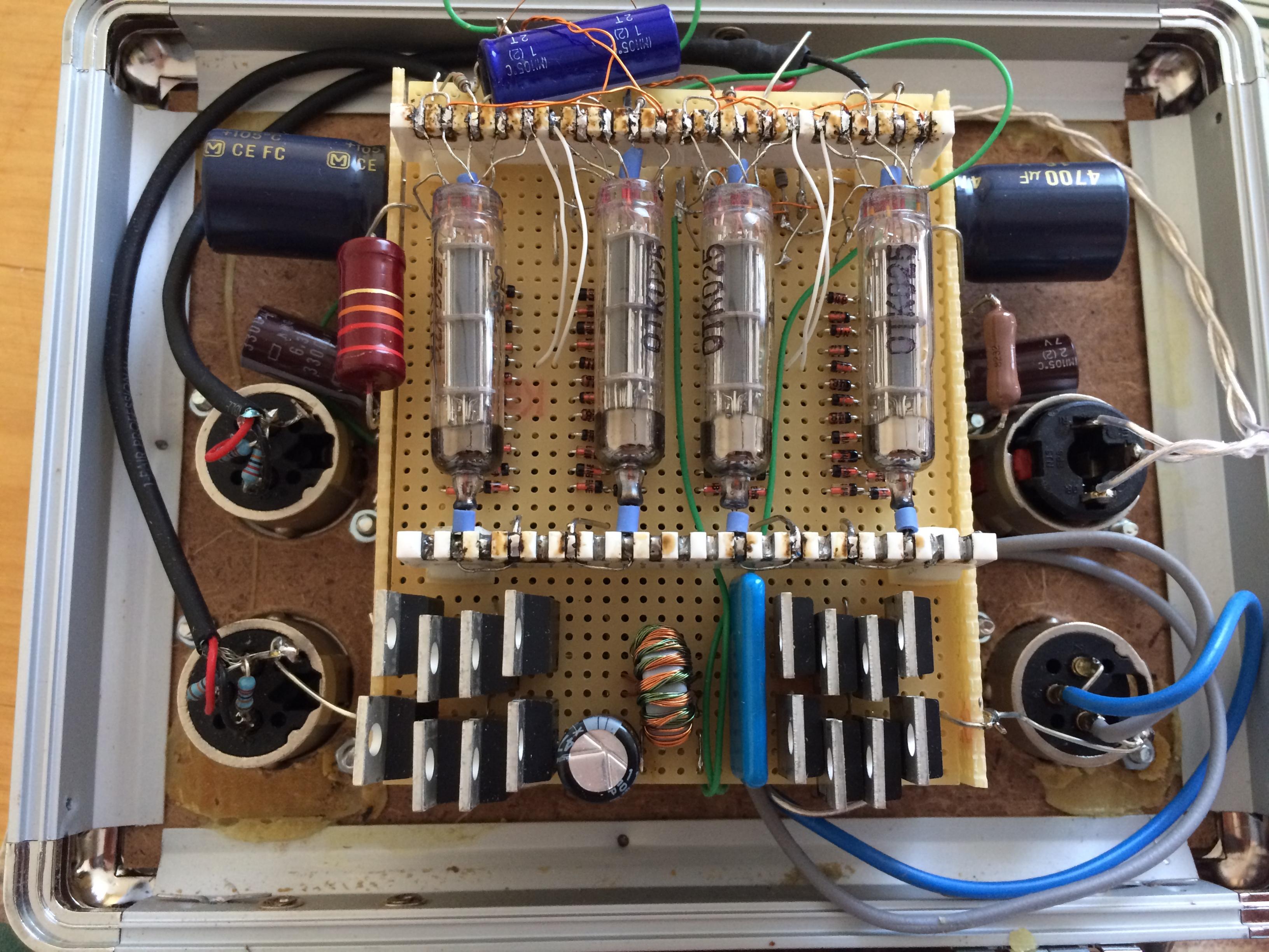

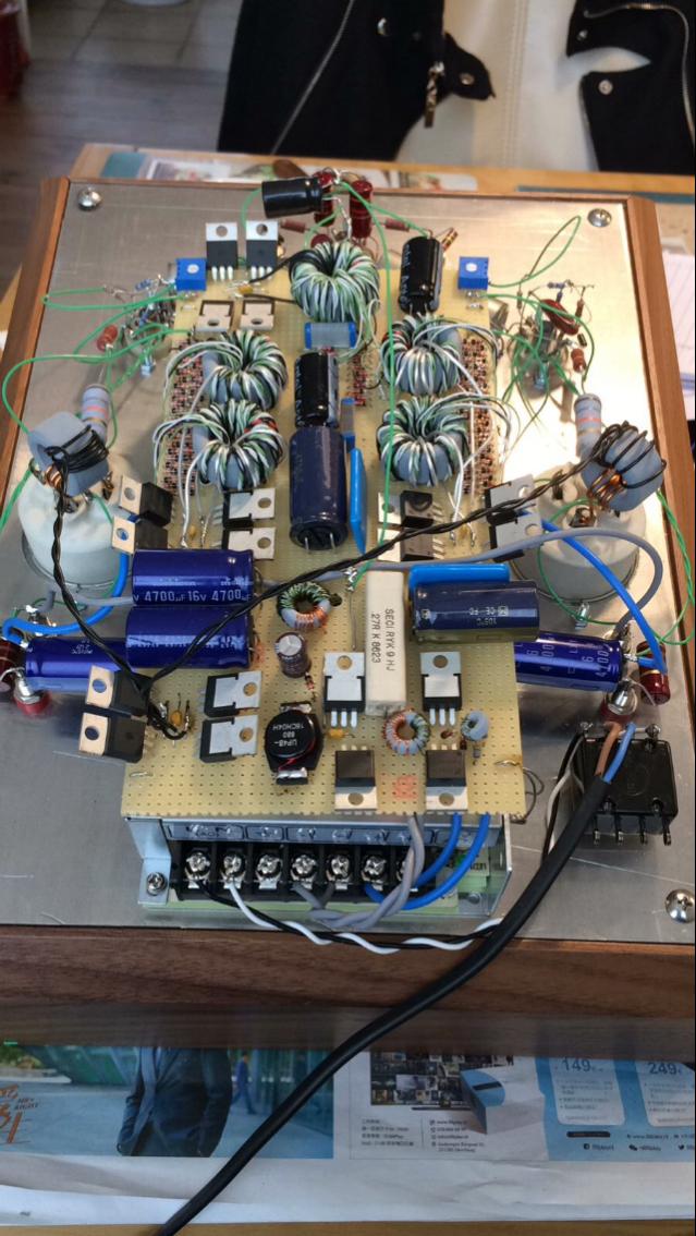

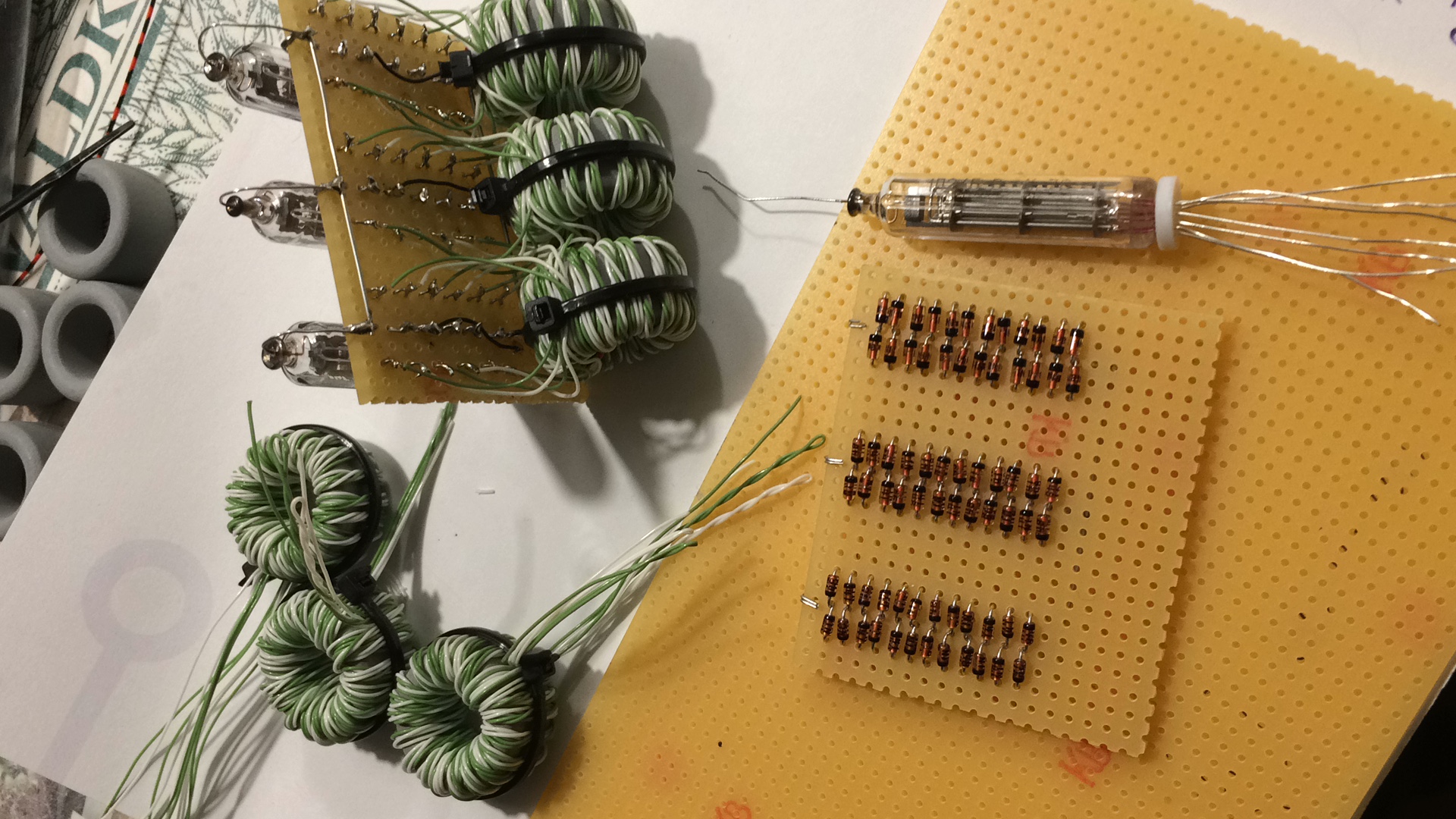

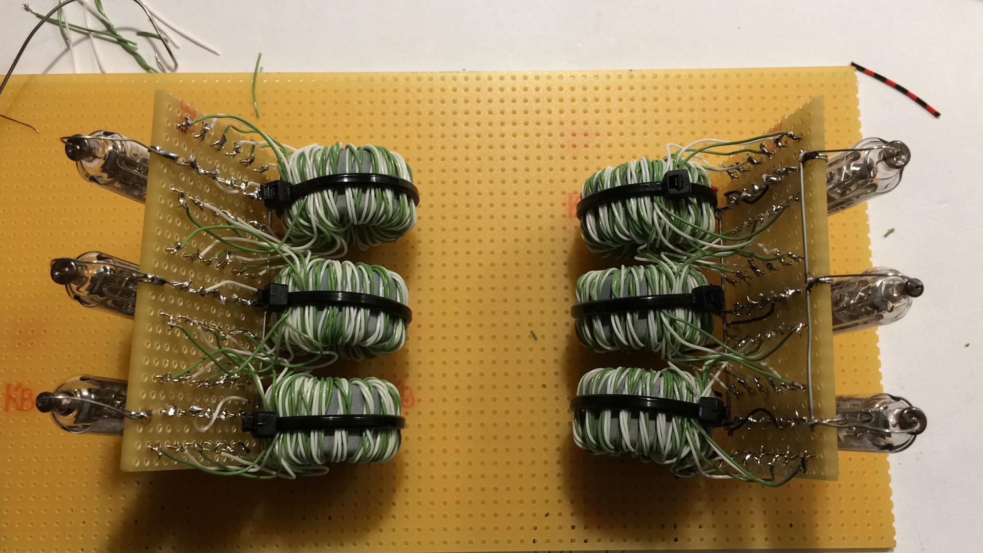

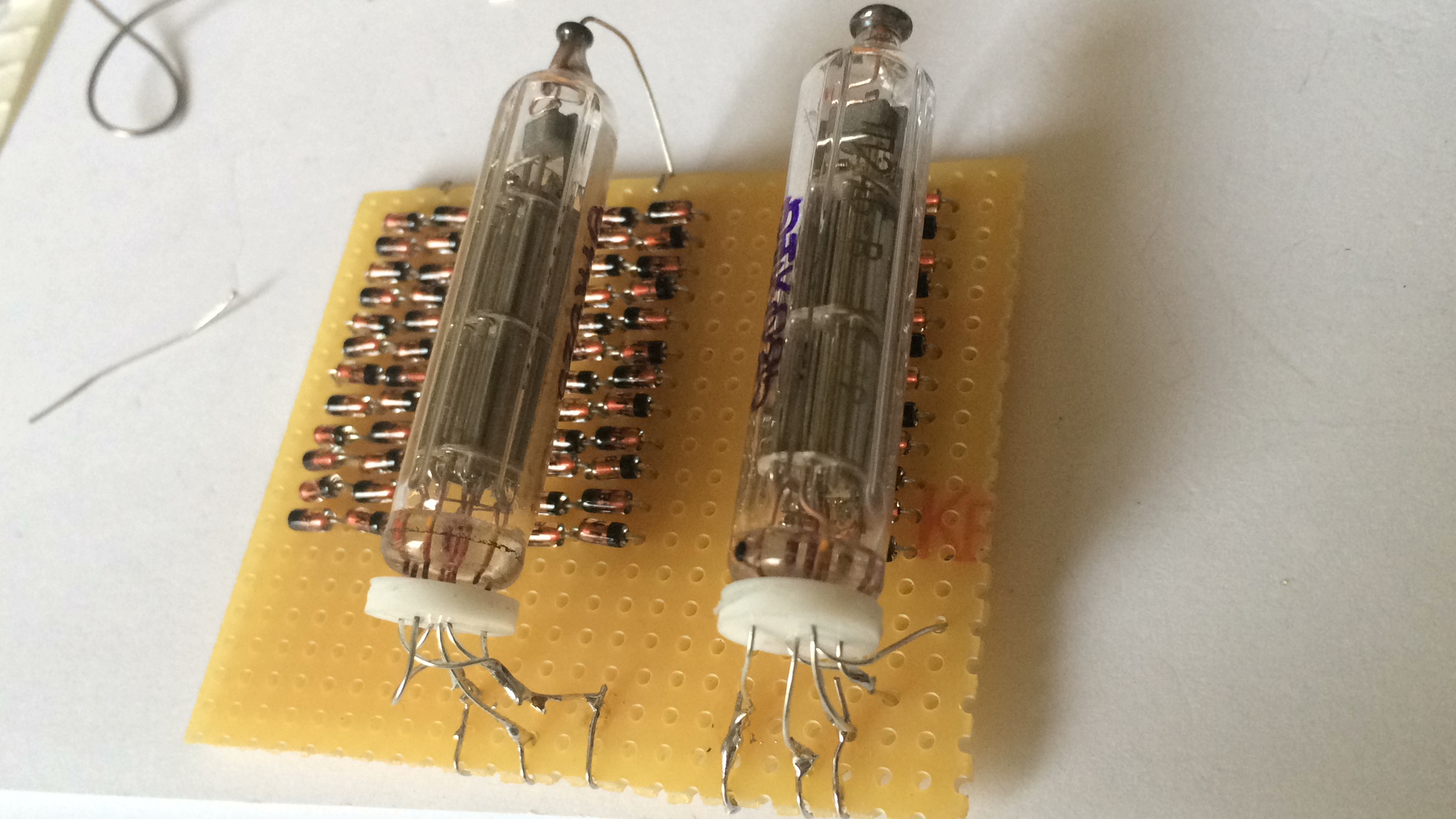

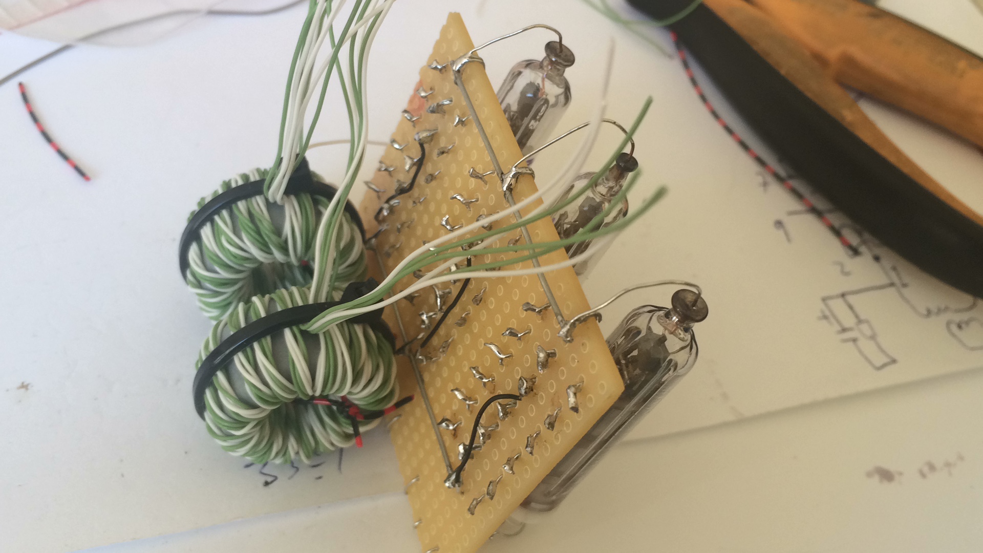

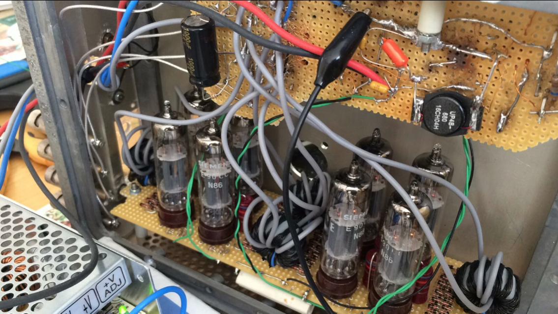

I am building a new Zotl amp at this moment to see if i can get more power with six 1P24B tubes per channel and still using a low voltage PSU (12V). I have a lot of these tubes plus they sound great in my headphone amp (two tubes per channel).
