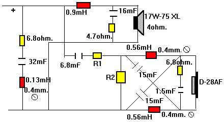

I have seen a lot of for / against opinions on the use of a zoebel network on high frequency drivers. In my case, I have a Dynaudio D280 paired with a 17w75 bass driver.
I have checked the numbers on the 17w75 vs 17w75XL and electrically, they are almost identical. This rings true with the difference between the D28-AF and D 280 tweeters (the only "main" difference is between the resonant frequencies of the two drivers).
Anyway, back to the zoebel on the tweeter question: what, sonically, can we expect to gain from this?

I disagree, it's to flatten the impedance curve and both for tweeter and woofer with a view to match 1st order butterworth xovers.
On the tweeter side it' s necessary to help the phase correction network between the cap and the zobel to work correctly.
6db oct slope is very low and the huge overlap between ways requires strict phase tracking to sum ok.
Btw, all Dynaudio filters use this topology. Of course the design can be cheated, aiming to similar targets, quasi-LR1, or LR2, involving reversing tweeter polarity, crossing -6dbs instead of -3dbs, etc...😱 But these are good and well behaved drivers, and it might still sound ok.

The criss-crossed capacitors around the two inductors in the tweeter circuit form an all-pass filter (delay network). These are sensitive to their load through the passband.

I know Dynaudio uses 1st order summations. There is not a peak in the top-octave as I recalled, BUT- it will still induce a tilt to the top-octave. I use these CR shunts on tweeters often in tweaking the response, and it will reduce the level above the Fc of the cap, as well as change the impedance.
Also of note, the 6.8uF on the tweeter starts its rolloff much lower at a shallow slope, coupled with the inherent 12dB rolloff of the tweeter yields a third order acoustic in most situations. It is also large enough to come into play below the inductive rise. In this case the all-pass ladder delay is actually employed for time-arrival to match up the drivers at Fc. Being that Ladder-delays are not full bandwidth consistent, and tend to target an area of response around Fc, I still feel that the zobel isn't really going to help in terms of time and/or phase alignment in conjunction with the ladder-delay.
Being that it isn't helping the top-octave smooth out either, it's likely a superfluous circuit.
Of course- this is all speculation, as I've not modeled it.

It is not in the midrange of course. Dynaudio tweeters can produce HF up to 30k or 40kHz. The zobel behaves as if it rolls-off the HF.
If the recording or the input has problem with HF, you will hear it. Many recordings have problematic HF (depends on your source), and without the zobel your speaker will be more discriminating.
The zobel will make the HF sound cleaner, more snap and "soundstage" too...
What I don't like is the effect as if the excitement or enjoyment or musicality is lost/lessen (no, I don't think the HF or details or distortion is responsible with excitement). I guess this is because the zobel affect the phase negatively.
