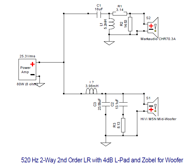

I am building a 2nd Order XO for a 2-Way speaker. I have it pretty much figured out, but I am not sure if I will need a Zobel or not. At this time I have the speakers dialed in at a XO frequency of 520 Hz. I am using an active XO (24dB) and it is the best setting. I would build a 4th order, but simply put, it is too much $. At 520 Hz both drivers are at their flattest impedance curve. For one driver, Markaudio CHR70.3A the rise in impedance starts shortly after, and for the woofer, HiVi M5N, the rise in impedance starts shortly after also. Since, at my XO frequency of 520 Hz my drivers are at their almost flat impedance curve point, do I need a Zobel, or not much needed in this case?

Enclosed is an schematic of the XO.

The Zobel network needs to be directly across the driver's terminals to flatten the impedance of the driver, that will give the LP filter a more constant load. The way you show it won't do anything but add an extra frequency dependent load on the amp.

This is what common sense told me, but for some reason a tutorial I was reading
said that the Zobel goes after the XO. But, now thinking about it well, the signal comes from the amp to the drivers, so after the XO would be just before the driver; now makes sense.

The primary function of a Zobel is to shape the FR of the driver
whenever you can't do that with a typical LP filter only. It doesn't
have to flatten the impedance of the voice coil at all, it can be
of values whatever makes you feel that the job is done correctly
and this you achive by measuring or modelling.
Mostly you can get away without one. When there is a FR hump just
before the slope of the low passed response starts to dip down, then
an RC filter (Zobel) may be desired.

There are many true statements. By flattening the impedance of a single driver you can get a more consistent high-pass filter slope for that driver.
There's a hidden secret there only a few guru's know or will share. Tweaking the values of a Zobel you can use it to nudge the phase 180 degree crossing point left or right letting you optimize that independently (within a small range) of the crossover settings and getting near perfect phase matching.

try this in XSim: enter your crossover, note the FR curve, then delete the zobel, & up C3 to ~39uF .... same result

I modelled your two drivers and found the two circuits below were effectively identical... and quite good, in fact! 27uF or 33uF. 🙂
I've used preferred values, of course. It makes little difference.

Guys, thanks for all the help. If it helps with anything, and someone wants to have fun doing better modeling than what I do. Design is a hybrid OB bookshelf with HiVi M5N used as woofer in a ported 0.25 cu.ft. enclosure with a 1" dia. x 2" long vent. A full range Markaudio CHR70.3A is used in an open baffle for 520 Hz to 20k Hz. The open baffle for the full range driver is 7-1/2" wide x 16" high, and the pair of speakers is mirror image with the driver's center located at 2-3/4" from the inside edge of the speakers and 2-15/16" from the tope edge of the baffle. Here is a VIDEO for those who may not have seen it in another thread.

You are filtering so low (500Hz) that the drivers are effectively flat and resistive.
So second order filters give second order slopes. ie 12dB/octave. Hence negative polarity LR2 when roughly time aligned.
Thanks, you confirmed what I had modeled with my basic XO knowledge. So, happy for that. Yes, I reversed the polarity of one of the drivers, but not because at the time I knew why it had to be done, but because I have read that with LR2 you have to do it as a rule of thumb. When I connected the speakers to the active XO, they didn't sound right when played with the same phase response, once I pressed the 180D phase reverse button for one of the drivers, the sound totally changed, it became "sweeter", but more importantly much more coherent.
