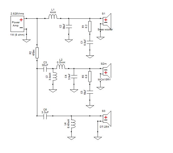

Midrange is SEAS MCA15RCY, tweeter is Monacor DT-254. Crossover frequencies are 500Hz, 4Khz pure 2nd order filters in this 3-way speaker.
I used for Zobel at the midrange 1,5ohm+10uF because people and speaker designers mostly used these values. Somebody used 1,8 ohm+9,2uF other used 1,2ohm+8,2uF or 1,5ohm+12uF.
But according to an online calculator need 7,2ohm+14uF.
My question why people not used values according to the suggested calculation? Other question with my values I cannot damage the midrange or the amplifier? Am I safety?
What exactly the R and C influence? Is it really better to keep the suggested values or not?
Thank you.

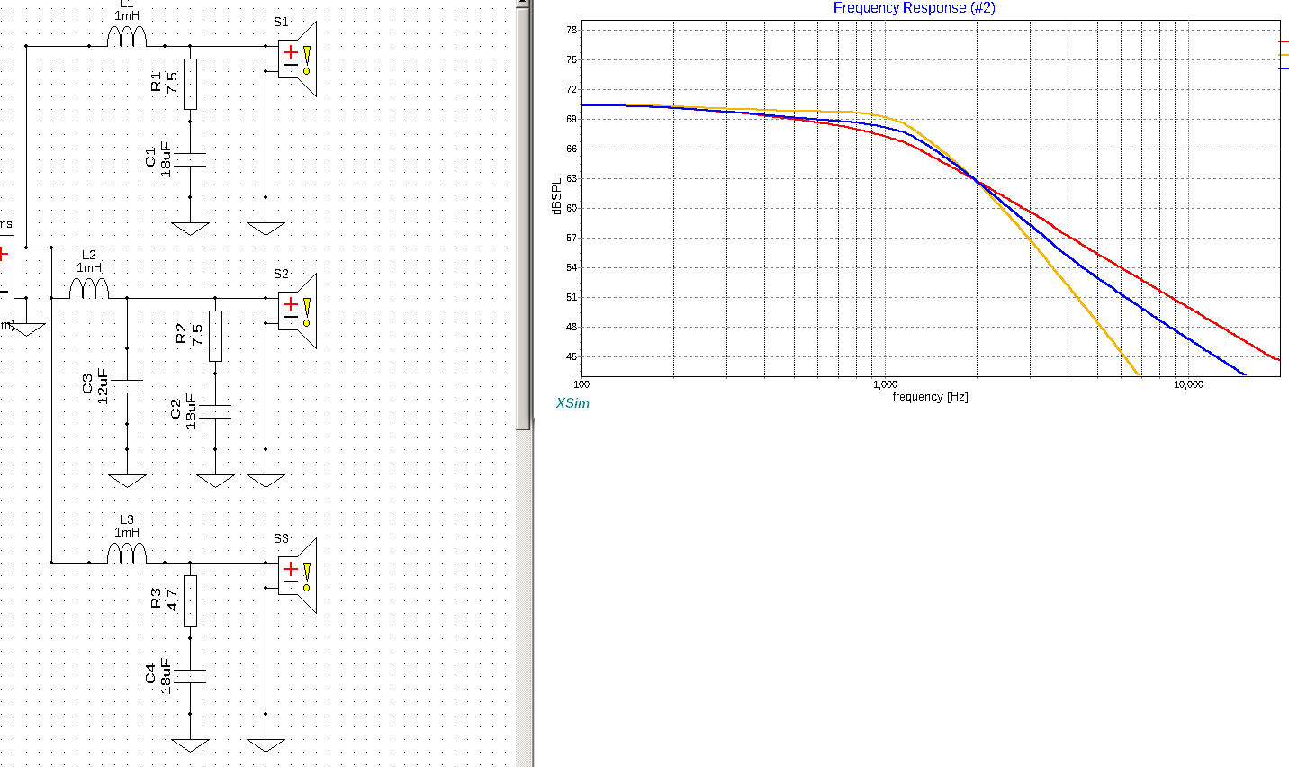

I don't think those are zobels you are looking at, just a lifted parallel section of an even order crossover. There are inductors in front of those, correct?
Reducing the value of the resistor could be used to bring the circuit and the response somewhere between first and second order.

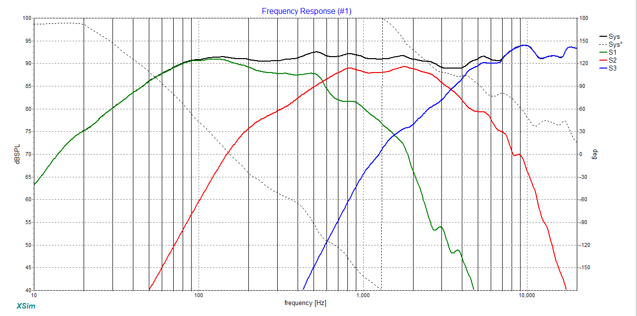

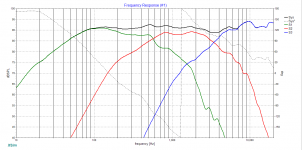

I made a simulation in Xsim but it is a very ideal case. Here the mod delay at all the 3 drivers are 0. What value I have to give them for mod delay?

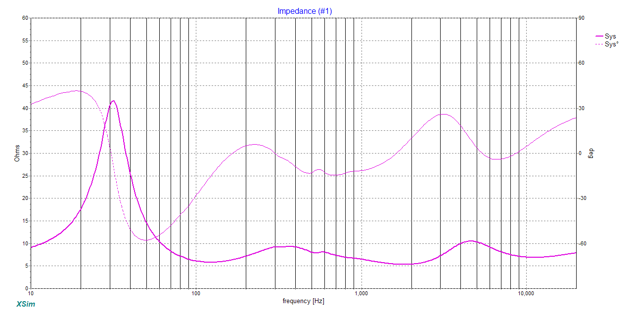

Passive crossover networks are constant k filters. The filter load aka the speakers impedance is needed to calculate the crossover frequency. If the impedance is flat purely resistivity filter shape and frequency are as calculated.Any speaker with a round voice coil has a rising impedance due to inductance and will alter the filters Q and shape. Zobel networks flatten impedance so the crossover network sees a more restrictive load. Having said all that I have used Zobel's in some of mt designs and some i haven't.
