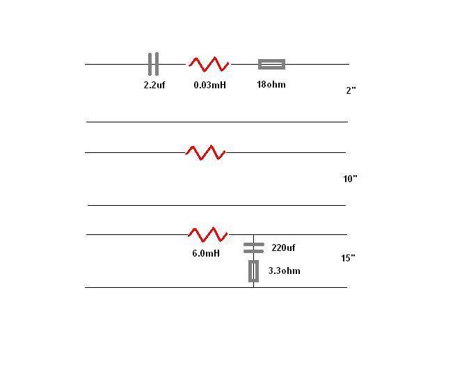

Midrange is SEAS MCA15RCY, tweeter is Monacor DT-254. Crossover frequencies are 500Hz, 4Khz pure 2nd order filters in this 3-way speaker.
I used for Zobel at the midrange 1,5ohm+10uF because people and speaker designers mostly used these values. Somebody used 1,8 ohm+9,2uF other used 1,2ohm+8,2uF or 1,5ohm+12uF.
But according to an online calculator need 7,2ohm+14uF.
My question why people not used values according to the suggested calculation? Other question with my values I cannot damage the midrange or the amplifier? Am I safety?
What exactly the R and C influence? Is it really better to keep the suggested values or not?
Thank you.
I don't think those are zobels you are looking at, just a lifted parallel section of an even order crossover. There are inductors in front of those, correct?
Speaker is 3-way, crossover is so simple 2nd order.
Bass 10" low pass: 4mH+30uF, Zobel 8,2ohm+6,8uF
Midrange high pass: 30uF+3,5mH
low pass 0,5mH+3,9uF, Zobel 1,5ohm+10uF
Tweeter high pass: 3,3uF+0,47mH
Reducing the value of the resistor could be used to bring the circuit and the response somewhere between first and second order.

Passive crossover networks are constant k filters. The filter load aka the speakers impedance is needed to calculate the crossover frequency. If the impedance is flat purely resistivity filter shape and frequency are as calculated.Any speaker with a round voice coil has a rising impedance due to inductance and will alter the filters Q and shape. Zobel networks flatten impedance so the crossover network sees a more restrictive load. Having said all that I have used Zobel's in some of mt designs and some i haven't.
