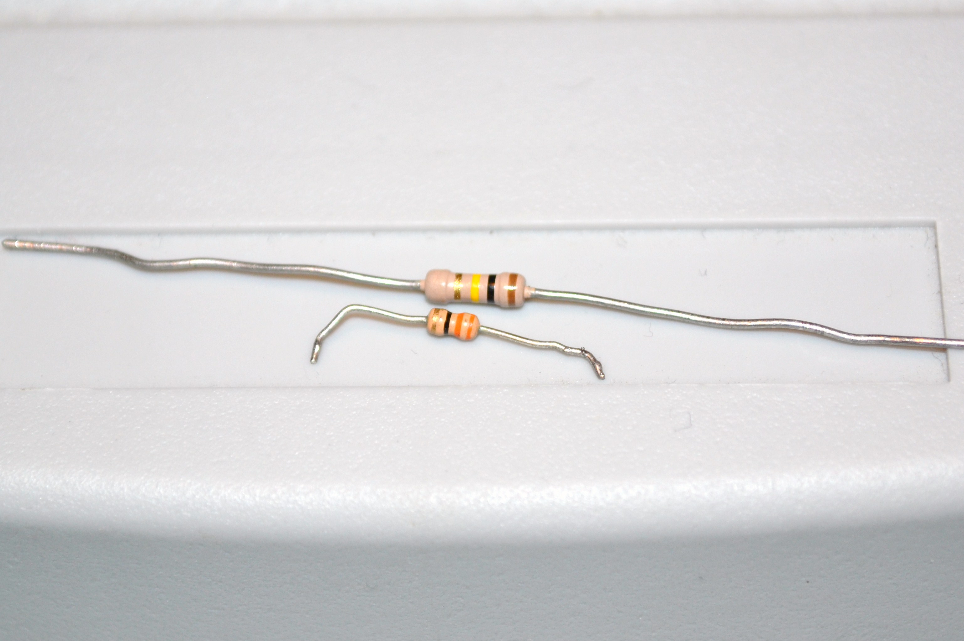

Could I use a 10 ohm 1/10th watt resistor to save space or is that likely to get too hot?

The only 0.1W resistors I'm aware of are SMD. It's going to have to be a reasonable size to wind a coil round it, anything smaller than 1W is going to be very fiddly

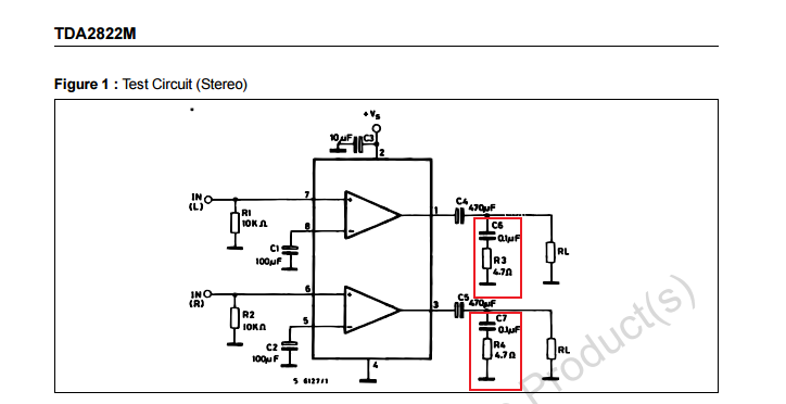

By zobel network I'm only referring to the Boucherot cell as shown in the example circuits of the datasheets and not the optional extras that many people here include.
Non of my speakers have any extra components across the terminals so all of the HF filtering is done on the circuit board by the RC Boucherot cell at the output of the chip.
So just to confirm its better to put R3, R4, C6, C7 before C4 and C5? That is connecting directly to pins 1 and 3 and ground.
They are through hole carbon film and are about half the size of regular 250mW resistors, usually found in cheap Chinese equipment which is where I pulled them from.
It's to ensure stability, so place it as close to the amplifier output as possible.................If you plan to run/test at high power/frequency, use a Zobel resistor of several Watts rating.
It is an HF load on the amplifier. ...............That requires the amplifier Output Zobel to be VERY close to the output and input pins.
Fig 12 is the correct placing...............
Thanks everyone, it looks like I'll connect it directly to the output pins then....................

don't use those tiny carbon film resistors.They are through hole carbon film and are about half the size of regular 250mW resistors, usually found in cheap Chinese equipment which is where I pulled them from.
The Boucherot Cells in the BTL circuit design of the TDA2822 data sheet are connected from the outputs to ground. In principle one can also use just one Boucherot Cell between both outputs.
