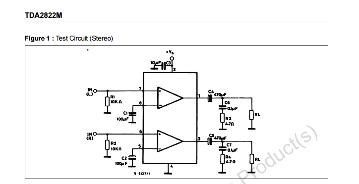

Its a one off spare parts project using a chip I found in my box so I'll include it as an experiment, its kind of exciting doing things that I've not done before.

Guys, I think some of us are getting confused.
By zobel network I'm only referring to the Boucherot cell as shown in the example circuits of the datasheets and not the optional extras that many people here include.
Non of my speakers have any extra components across the terminals so all of the HF filtering is done on the circuit board by the RC Boucherot cell at the output of the chip.
So just to confirm its better to put R3, R4, C6, C7 before C4 and C5? That is connecting directly to pins 1 and 3 and ground.

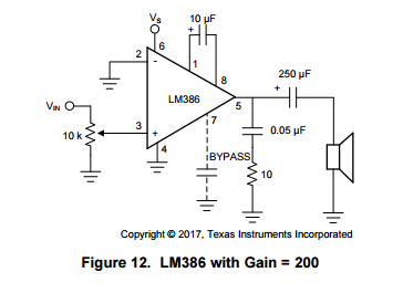

It's to ensure stability, so place it as close to the amplifier output as possible.................If you plan to run/test at high power/frequency, use a Zobel resistor of several Watts rating.
It is an HF load on the amplifier. ...............That requires the amplifier Output Zobel to be VERY close to the output and input pins.
Fig 12 is the correct placing...............
Thanks everyone, it looks like I'll connect it directly to the output pins then....................

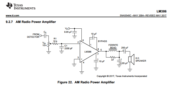

Almost no manufacturer/Designer offers a power amplifier that is stable for all loading conditions and omits the Output Inductor. I know of at least one Designer mentioned in this Forum that does omit this stability component. But they are probably alone in doing so.and not the optional extras that many people here include.
In my (amateur) view the output inductor is not an optional component. Low current outputs can save money by replacing the damped inductor with a single resistor and you will often see this recommended in opamp datasheet and ap notes.
Then that points to penny pinching and hoping not too many come back under warrantyView attachment 619798
