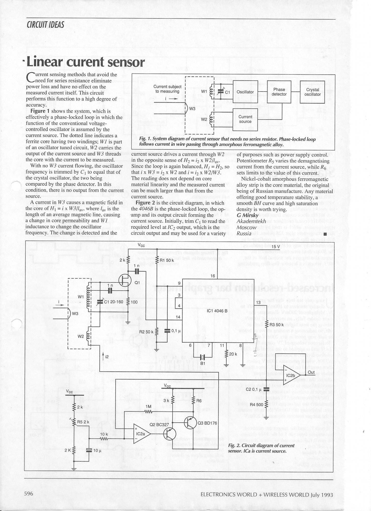

George;
The DCCT measures a DC current flowing through it. It drives a 17 Khz signal through one set of windings on two cores in opposite directions (to cancel the 17Khz and prevent coupling that to the wire being measured). The overall circuit watches for core saturation asymmetry, I think it generates second harmonics and produces an offset signal. There's more, but I'm not sure where IP comes into play so can't give more info. I believe there are some very good pages out there describing the operation. The even spacing seems to have been about accuracy, down in the tens of PPM level.

John, sorry I experience memory gaps. What is this DCCT and where has it come into our discussion again?
Your description matches a circuit in WW ‘Circuit Ideas’ about a non invasive DC measuring instrument.
I just called a member who has built it (https://www.diyaudio.com/community/members/mkerk.414571/) and he sent me the documentation (attached).
George

That is the exact mechanism of operation. The second coil, w2, tries to zero the net DC current through the toroid. So if 50 amps are flowing through the single turn of the measured wire, and w2 has 500 turns, the circuit will push 100 milliamps through w2 to zero the net current.
The caveat to that circuit is that the oscillator coil w3 will couple and inject some of the hf signal into the wire being measured. If you double the toroids, lock both w3 coils together by running in series but put one opposite the first, the coupling to the measured wire is reduced to zero.
I only mentioned the DCCT because that is why I built the winder. But using it to wind cores for a bridge would also be fun.
John
John I guess you mean W1
The builder of that instrument has remarked that the circuit is marginary stable. Perhaps what you suggest may be the cure to the oscillation.
George
George
Yes, you are correct. I would have called the tested wire w1, so made that mistake.. Should start the morning with coffee before reading, not the other way around..
