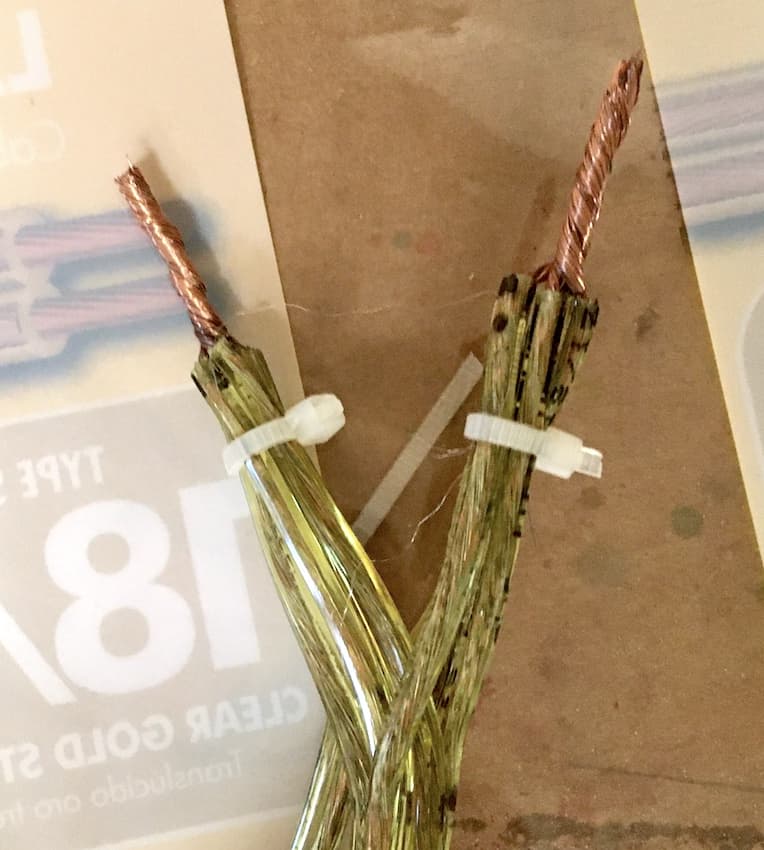

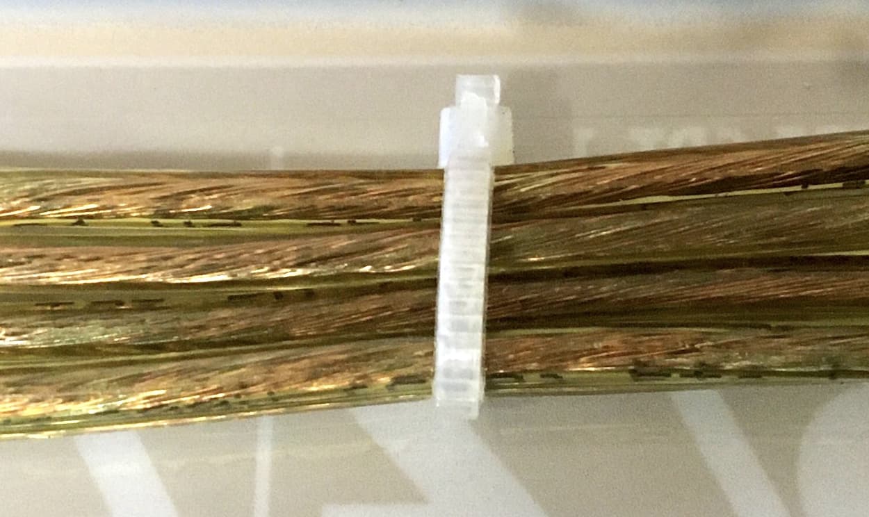

OK JNeutron. I've cut and stacked the zip cords and joined the ends.
The are stacked as flat as is reasonable, but could be tightened up with some more work. I hope this is what you had in mind.
All the negative leads are twisted and all the positive leads are twisted together at each end.

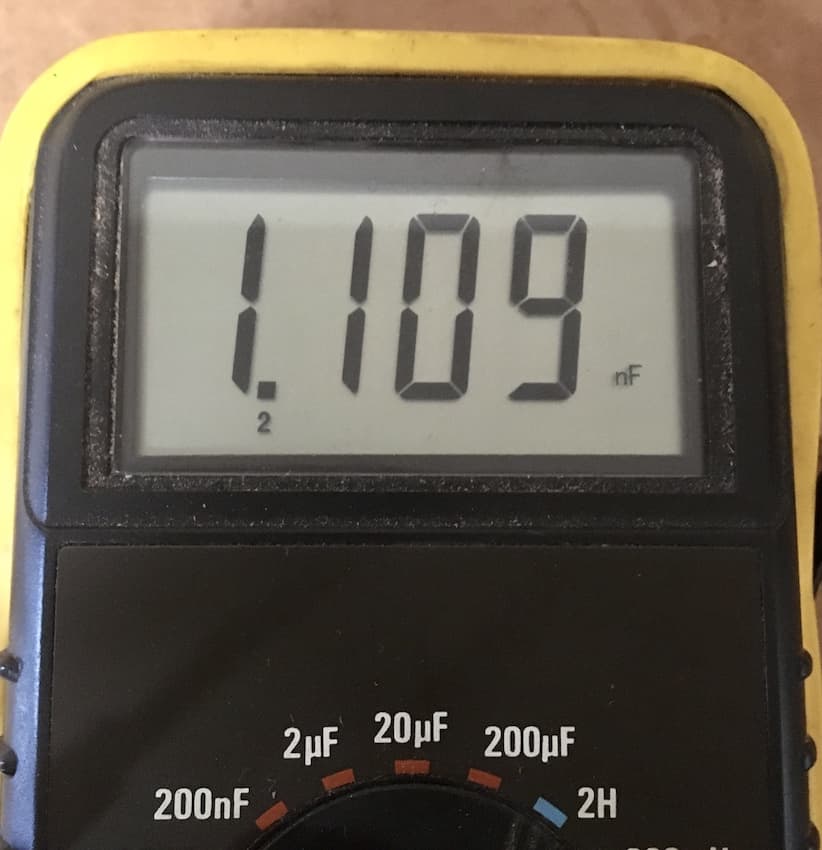

My L/C meter says the stack is 1.1nF between positive and negative.

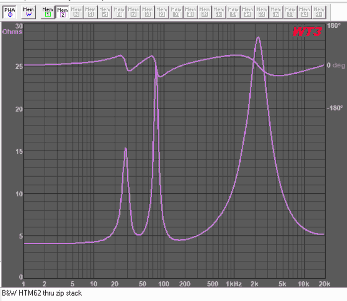

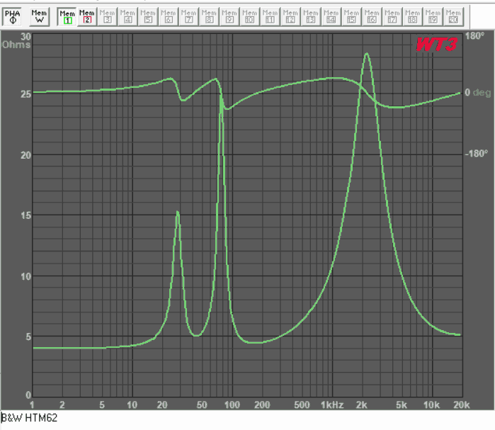

Here we see an impedance plot of a Bowers & Wilkens HTM62 center speaker.
First plot is the WT3 connected to the speaker terminals, the second plot is the same speaker thru the cable stack. All I can see is that the DCR is just a tiny but higher thru the cable. Otherwise I can't see a difference.

Don't tie the cables together. To achieve a RFZ consistant with 1/4 of a single cable, they cannot be coupled magnetically. An inch or two spacing is good enough to decouple, tying them together doesn't do that.

Well darn, that was not easy to do.
Un-bundling them won't be difficult. Keeping them away from each other will be.

I was not able to measure inductance either bundled or spread. It seems to be below the threshold of my L-C meter. Capacitance went from 1.109 nF to 1.453 nF. Disregard the last digit, it's noise.

While I use transmission line theory to calculate the settling time in the tens of microseconds domain (that falls apart after 10's of microseconds), it could just as easily been evaluated using a simple LCR model.
For your speaker, the 78 hz and 2.1Khz peaks will have zero settling time if you use a 25 to 30 ohm RFZ cable. The 5 to 10 ohm midrange band will also have very little settling time as well, the ratio maxing out at 5 to 6:1, represented on my graph by the 20 to 16 ohm impedance which settles to 90% in 1.2 to 1.6 uSec.
If the RFZ of the split zips is 500 ohms, then the peaks are 20:1, settling to 90% at 5 uSec, but the midrange valley is 100:1, settling quite off my chart, the 50:1 hits 90% at about 15uSec, 100:1 I'm estimating at about 20 uSec.. So the midrange settling time is much longer.
Raising the cable RFZ should then cause a temporal shift of the midrange band in the 20 uSec range (granted, to 90%), a delay in the frequencies we are the most sensitive to ITD. The shift at 78hz of 5 usec is meaningless to human perception, we will focus instead on the amplitude and see that content as centered and unmoving..at 2Khz, 5 usec is probably below human discernment as well, but there is a dithering grain of salt there so I cannot say that with full confidence.
My test is designed to look for that delay with respect to the centered image content around the 78 hz peak, as it will shift far less and we are not sensitive to ITD in that band. The 2khz content will also be more time stable, so even if it is within the ITD sensitive range, the shift is far less.

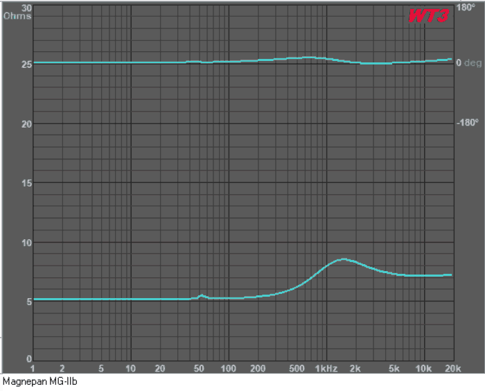

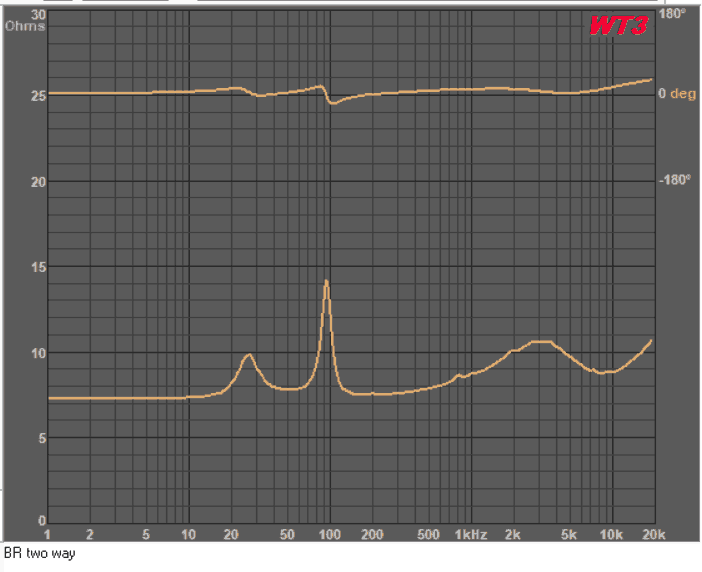

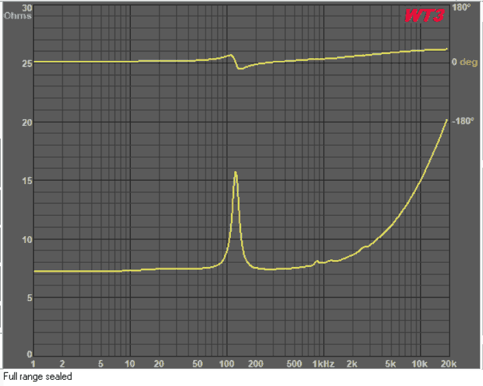

Here are plots for 3 other speakers that can easily be tested. A small fullrange in a sealed box, a cheap 2-way in bass reflex and a vintage Magnepan MG-IIB. If any of these look like good test mules, please let me know.

Your first plot, the WT3, is by far the best candidate as it has the low impedance midrange with the highs on either side. A speaker that has very constant impedance through the entire audio band will be useless for this experiment, as nothing is varying.You're welcome! Just please let me know exactly what you need as this is new territory for me. I want this test to clearly show what you are looking for.
The crux is to find a set of frequencies where the amplifier helps to suppress IMD caused by the speaker, and the high RFZ cable gets in the way of the amplifier doing that. I've no idea what frequencies, but the test signals should be centered in the midrange valley.
jn
Pano, was thinking about it. Perhaps a test signal near but above the 78 hz resonance (maybe 80 or 90 hz), and a second somewhere in the impedance valley. The excursion of the LF will be trying to change the eddy losses of the higher frequency due to pole and front plate conductivity, so that might produce some interesting phenomena that the high RFZ cable is not as well equipped to keep under control.
