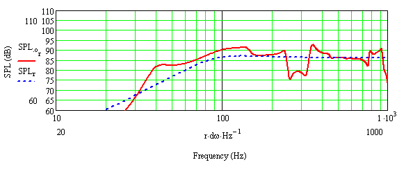

I just finished the zigmahornets. I'm an ok woodworker, and the project from start to first listen was about 5 hours for me. It took more time than that because glue needed to dry and such, but the box is really simple and easy. Especially if you have a table saw.
Honestly, I was a bit disappointed with the zigmahornets. I think for the price they're pretty good, and they'll work fine in the future for surrounds for me, or maybe in the bedroom.
Positives: the imaging, the cabinet is attractive and wife-approved, the price.
Negatives: somewhere in the bottom of the mid range, or the upper end of the base, there's just something completely missing. I'm listening to rock music, and sure, it needs a sub, but short of that, there's something missing closer to the mid range. It also gets sloppy sounding at even a medium volume.
I'm trying to figure out how to improve them - maybe try the fostex driver? I am thinking to maybe experiment with different baffling.
I really like the full range speaker benefits, and so here I am making my first post in this forum as I start researching everyone else's projects. If you have any suggestions for a second project, I would appreciate it.

btw, have you ever tried a baffle-step compensation?
if the lower midrange sound "to small" and without substance, this might be the problem.
Naturally there's something missing in the lower mids. There's a 10db hole in the Zigmahornet response 100Hz wide & centred at ~275Hz. This will be audible. 😉 (see attached 1/2 space plot). There's not a whole lot you can do about it either. You could stuff the pipe to ~aperiodic levels for an acceptably flat response, but you would have no LF gain at all (not that it has much to start with), so woofers would be mandatory. The -3db point due to step loss is at 960Hz, so 6db of correction is really required whatever you do, although you might get away with less if they are rammed into corners.
