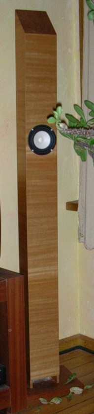

Built one speaker
Well, as "easy" as the zigmahornets are to build, they were REALLY hard for me! Learned a ton about working with wood though.
Very sad thing though is that I struggled with the top "trangle" part and finally gave up and cut it off despite all warnings. I thought if it made a difference it would be very minor.
Well, I have one speaker finished and I just don't hear any bass. None. I'm listening to Jazz, trying to hear the plucking of the bass that I hear nice and loud in my 25 year old Technic three way speakers... I can hear it but very dim.
Is it because I lost the top triangle.. or should I have expected the bass to be this minimal?

I don't think triangle would help. Did you make the cab go up all the way or cut it of on the lower edge (begining of slope) ?.
Anyway this speaker is a 70Hz tuned pipe with 4" driver with minimal excursion . Everything below 150-100Hz is going to be a sonic mud ,no matter what driver will you use . Sub should help a lot. Regards, L

kumaraka said:should I have expected the bass to be this minimal?
yes

Regarding hacking my 3 way cross over:
The middle sized driver on the 3 way is the same size as my DCA driver. Can I just disconnect that one and connect the wire that went to it to my zigmas? Doesn't that speaker do the mid range?
Akash
Akash
Well , its time for you to read a little more about the speakers and how they are built/work. Let the Technics be .If it's midrange is the same size as your zigma woofer you may try to swap it (if impedance of both matches) maybe you like it better that way. This is a less bright side of DIY -you never now what you're going to get (well, to the extent) with unfamiliar projects. My advice is-

No. Size of driver is immaterial. This is a bit like the old adage -my dog has four legs. My cat has four legs... therefore my dog is a cat. If you want another analogy, a Lotus Europa had the engine from a Renault 16, but that didn't mean it was a Renault 16.
Unless you get very lucky, the drivers will have very different technical specs, motor power, sensitivity & behaviour, ergo the existing XO will be completely mis-matched. You can try it, but I wouldn't bet a brass farthing on it working out. Sorry.
Leave the Technics alone - and for under $250 (shipping included), a pair of
