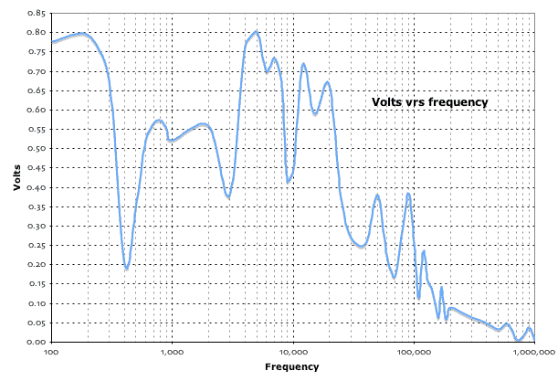

In response to Grahams post about the transformer characteristics I ran a test using the 75 watt transformer with 50 ohm source and 50 ohm load to see what was happening at the top end.

Notes:
As the setup isn't properly designed for the higher frequencies there are some bumps.
Yes, I can measure to 4 decimal places.
Yes, final measurment is 1 GHz.
Best wishes,
Susan.

Susan-Parker said:a test using the 75 watt transformer with 50 ohm source and 50 ohm load
Numbers converted to a picture

Upupa Epops said:Realy high fidelity, Susan.![]()
i might be totally ignorant here, so correct me if i'm wrong. but statistics is the science (or art, really) of making the data say what you want. aren't we generally used to seeing graphs such as this in db (probably because they *look* better)? and then isn't 3db twice (or half) the voltage? again...i might be off a bit on specific details...but hopefully what i'm trying to convey gets through. and basically...it is that this graph seems more drastic since it is provided in volts? aside from the dip at 400hz...wouldn't the 100hz to 20khz performance then be *within* 3db (ie: +- 1.5db) since the range is from about .4 to .8 (ie: a doubling of voltage). if that is correct...then the whole thing can even be within +- 3db, or even less (including the dip at 400hz).
again...my figures might be off...so correct me if i'm wrong. i just thought this when looking at it (and remember statistc courses in college).
ran the math...and somehow i was off (i guess 3db isn't twice the voltage?! is it twice the power or something?). anyhow...i show the difference between .2v and .8v to be about 12db. so that would be a +-6db over the whole spectrum, or +-3db save the dip at 400hz.
