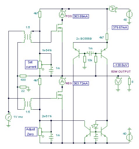

Hi Susan,
There have been three reasons why I have never contemplated constructing your amplifier;
1. I am not sufficiently up to date with current Mosfets.
2. I do not like output transformers in audio amplifiers.
3. I don't normally use 100W-8R, but I do want that sort of capability for dynamic reserve.
My own high power experimental class-AABB agenda turned out to be sonically flawed due to the biasing mechanism within the JLH class-A topology causing problems for my non-linear output stage, but I have never stopped thinking about your design.
For (1) above I must rely upon the advice of others, but for (2) and (3) I offer the attached solution. My simulator does not offer a three winding transformer, so I have been obliged to draw two separate transformers and parallel the primaries. The secondaries need to be separate.
With suitable Mosfets in this circuit, there is no reason why your circuit cannot now be constructed to *any* desired output power as long as the input transformer has sufficient step-up ratio and the pre-amplifier a low impedance driving capability, say not more than 500 ohms. Of course zeners etc. are additionally necessary - it is only the basic circuit I've shown here.
In simulations I note that the power output can far exceed normal class-A bias limits without suddenly distorting, and indeed, near rail to rail low distortion output is possible with just a few hundred milliamps of quiescent. The damping factor tends to be about 50; good - bad ?
I am starting to become impressed, but not yet converted, even though it might be the case that I should be. This is because simulators do not tell the 'sonic' story, as with my own recent efforts.

Hi Susan,
( Lack of capacitors - yes - used only for the bias control which is soft start. )
My circuit is of slightly different nature to yours, but it still retains the input transformer step-up / balanced push-pull / Mosfet follower power gain you have championed.
I do not know the maximum ratings for the IRFP150, but with these in the circuit of post #703 and 500mA per device (20W each) I have observed
the simulated 1kHz 50W-8R distortion was 0.07% for 1V.rms input.
( I had not checked this before and am surprised ! )
the -3dB point due to the simulation device model capacitances was 50kHz.
( the higher the drive impedance, the lower the -3dB point, but you already have this covered. )
Cheers ........... Graham.

Hi Graham,
For some of us simpletons out here could you explain the basic operation of the different elements of your cct - I more or less got some of the i/p side but other bits like the LTP & mirror I can't get my head around.

Hi Mike,
With these split halves the output pair do not need to be identically bias matched.
Start with both potentiometers at zero ( both output halves turned off ) and a power resistor in place of the loudspeaker
The upper half is conventional, and bias set for a desired quiescent current.
The lower half is set by its potentiometer to pass slightly more current than required, but at the same time its bias voltage is pulled down by the mirror reflecting some current and the error sensed at the output terminal with respect to centre rail zero by the differential pair.
There is an interaction between halves whilst setting up, but two or three 'current then zero' sequence adjustments at normal working temperature should establish the required quiescent conditions
Note; maybe the 1mF capacitor I have at the differential is a bit large and would make a loudspeaker cone breathe slightly at start-up. Maybe 100uF would be better, with this same value for the mirror capacitor.
