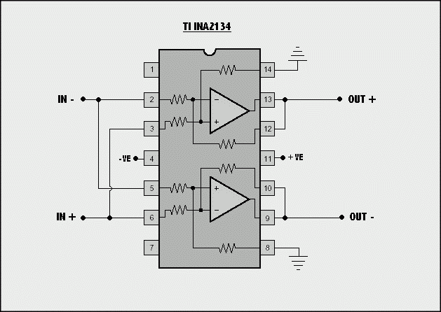

Re: Re: IC Balanced Line Driver Input
Thats what im going to do for a bridged amp progect using INA134 though
The input which is floating, will take a non balanced or balanced signal (or anything in between) and output a differential signal
It will have as good (even better than a single INA) CMRR even with single ended input aswell as with balanced input, dont know if this is relavent but its a very usefull circuit
darkmoebius said:
It's too bad the balanced line receivers I've seen so far(INA134/137, SSM2015) convert the differential single back to single-ended. It would be great to use the Pro Audio approach of a line amplifier at the preamp and receiver in the Zeus in lieu of the input tranformer.
We'd get all the advantages of noise rejection and the ability to drive any length cables with extremely low distortion.
Do you think it would be possible to feed the + and - differential signals to seperate receivers in the INA2137 dual receiver pictured below and still maintain balance?
The + input for both receivers would share the common ground line of the differential cable.
Anyway, just a thought.

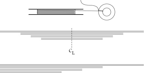

Reading trough a fine thread,
I had to ask for a visual on the windings. I'm asking about setting up the individual wire. Included is a graphic I hope is sent correctly.
Are you using a group of windings all aligned at a starting point, aligned on common center, or threaded in on a ratio? The last option I think was covered in a post about keeping the windings equal and therefore all phase correct. Although I have wondered if layering and then using a separate layer-wound concept would help.
I needed to ask about the windings. Otherwise, I can collect together most of the needed parts list from early posts.
I'm also waiting to hear of compatible preamps. This will be my only hurdle, because I'd like to use an AV unit for the preamp ( a few video inputs, and audio inputs, and control of ), and run these amps for individual channels or on active crossover setups on all channels. If cost begins to be an issue, I will probably plan for a left/right/sub configuration, instead of 5.1 or 6.1.
I, for one, wish there were a more powerful word than congratulations to Susan for the amp design.
Many thanks all,
GH
Many thanks all,
GH
Hey B.Vdos!!!!
The second picture that you posted is exactly what Susan described a few posts ago, but I had a hard time picturing it rom just words. Now, I get it.
I talked to one of the two engineers in charge of the INAxxx products at TI this week and he agreed that this configuration will work perfectly. Actually, he was surpised that TI never introduced a line receiver that is balanced in-balanced out.
I was wondering if using a balanced line receiver before the transformer actually provides better performance than feeding directly into the input transformer. (if extra gain is not needed)
I plan to use ~20 foot interconnects across my living room, so it might be a benefit.
B.VDBOS said:Thats what im going to do for a bridged amp progect using INA134 though
