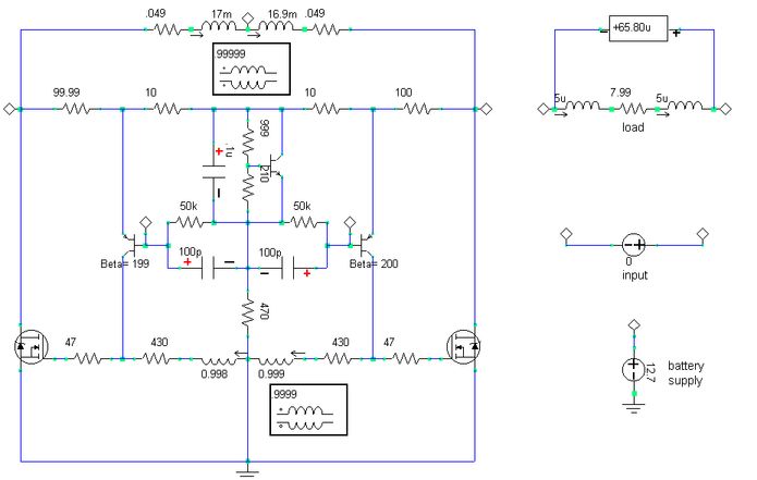

similar design & transformers in b2 spice
Hi Susan,
I have just read through this thread with great interest and anticipation – This is just the kind of amp that appeals to my luddite tendencies.
I did not notice yet if you had an answer Sowter on the o/p transformers. I think would like the bi-filar version. As I would probably use them as chokes. Mind you the toroids also sound interesting. I wonder if anyone makes Bi Filar wound toroids these days.
B2SPICE...
I have been modeling an amp with some similar features for a year or two in b2spice. I always manage coupled chokes and transformers by using inductive coupling – it’s a bit hit and miss as you have to ajust the inductance to effectively change the number of windings. Also leaving the inductive coupling at 100% can cause problems... as can perfect symetry – almost perfect works OK !
Here is one version of my design – not yet built cos I got stuck on the chokes !
I will be very interested to try both your and my designs using as similar components as possible to see what audible effect the dreaded feedback has !!! As you can see this version has heavy feedback but I have simulated versions with source degeneration and higher open loop gain
