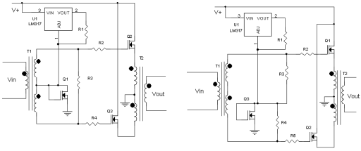

I just got finished selecting IRF540s for the output stage of my push-pull prototype. I used ST devices obtained through Digi-Key. To select FETs, I used a current-limited power supply set to 200ma short circuit current and 10V open circuit. I also used a jig that hooked gate and drain together and grounded the source. A couple of DVMs were used to monitor voltage and current. I ended up selecting two pairs that were exactly 3.91V out of about 20 devices - not a bad haul, especially since there were several other matched pairs at other Vgs values.
My big surprise came when I tried to select bias FETs. Simulation results showed that an IRF 530 would work to bias the 540 output devices if the 530 was bised at 30ma. However, I tried some 533s in my jig, ad they dropped only about 1.6Vat the desired bias current. I then tried some Siliconix IRF612s, which were much closer to the money at 3.6V at 30V bias current. I will use the 612s in the bias circuit and either up the bias current a little or accept a somewhat lower quiescent current in my output FETs. This wasd not a problem with FET diamond buffers I built, as I used the ratio of two resistors as well as the relative FET Vgs to set output bias current.
Attached are two possible bias circuits for the push-pull amp. I'll probably end up using the one on the left. Protection zeners and bypass caps were left out for clarity - these will be needed in a real-world implementation.

Hi wrenchone,
Thank you for your post.
I am using a schottky diode in series with the mosfet to give me the required voltage difference to get the desired bias level.
I would use the left one with the center tapped transformer if at all possible as with matched windings the distortion is a little lower in the measurments I have made so far.
Best wishes,
Susan.
wrenchone said:My big surprise came when I tried to select bias FETs. Simulation results showed that an IRF 530 would work to bias the 540 output devices if the 530 was bised at 30ma. However, I tried some 533s in my jig, ad they dropped only about 1.6Vat the desired bias current. I then tried some Siliconix IRF612s, which were much closer to the money at 3.6V at 30V bias current. I will use the 612s in the bias circuit and either up the bias current a little or accept a somewhat lower quiescent current in my output FETs. This wasd not a problem with FET diamond buffers I built, as I used the ratio of two resistors as well as the relative FET Vgs to set output bias current.
Attached are two possible bias circuits for the push-pull amp. I'll probably end up using the one on the left. Protection zeners and bypass caps were left out for clarity - these will be needed in a real-world implementation. [/B]
Best wishes,
Susan.

Graham Maynard said:Hi All,
When you use two transformers that are parallel connected it is not push-pull. With toroids the cores are going to be magnetically biased, whereas with E-I at least you can gap the I.
Cheers ........... Graham.
Graham is quite correct in that the transformers will be magnetically biased.
My experience has been that for the large cores and small bias levels that are being used this is not a problem (we are using mA, not amps as would be the case with a single ended design).
However this is with EI cores although they were just straight EI "top n' tail" interleaved without any deliberate gap.
The configuration with the two separate transformers should give some results - but is far from ideal. However if they are to hand and can be tried out then I don't see any problem in having a go.
Just remember to have a fuse in the supply rail after the storage capacitor in case a transformer does saturate.
And as the toroids have a closer coupling it may be that this configuration with two separate transformers will not work well at all - but if the bits are available? This is half the fun of DIY audio after all 🙂
And one can also use a lower DC bias level of say 25 to 30 mA - which will still work but for a (slightly) higher distortion level.
With 100 VA transformers you should be looking at 25 watts maximum (e.g. 14 volts ac rms into 8 ohms) for a full bandwidth audio. As this is across the primaries that gives a power supply of around 20 volts DC max (allowing for a bit of headroom), and this could be less.
It is not advisable to run off a significantly higher supply rail than that which is sufficient to drive the desired/calculated maximum power into the speaker/load as with the transformer coupled input there is no intrinsic limit to the gate drive (unless one puts a pair of zeners back to back across Rterm) and the output will quite happily try to follow.
Driving the amplifier output hard into the power rail on the other hand isn't a problem as the mosfets simply run out of get-go. Because the negative rail is generated by the transformer and not from a DC power supply there is no possibility of the output stage shredding itself in overdrive conditions unlike conventional solid state power amplifiers.
As previously mentioned with low gate voltage drive mosfets you could run off a car battery - just don't forget the fuse.
Thank you Graham for the comment and a reminder on the bias levels.
Best wishes,
Susan.
P.S. Note to All:
FUSE - Please remember to ALWAYS use a fuse in the supply rail to the mosfets AFTER the storage/smoothing capacitor(s).
