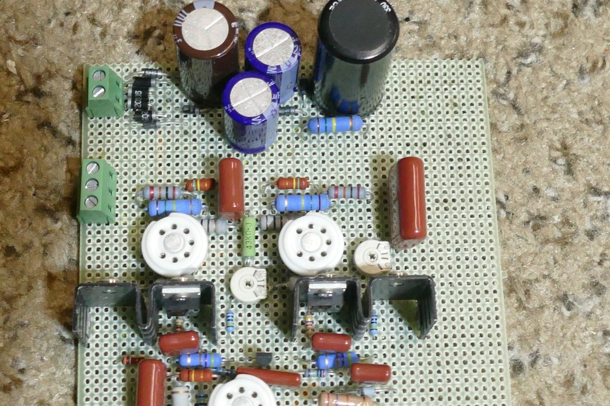

In my latest project I'm trying to combine the best of the two technologies: single triode input stage - transformer phase splitter - FET followers - output tubes.
The amp is currently operating without the followers and I don't expect them to leave much of a sonic signature once they're in place.

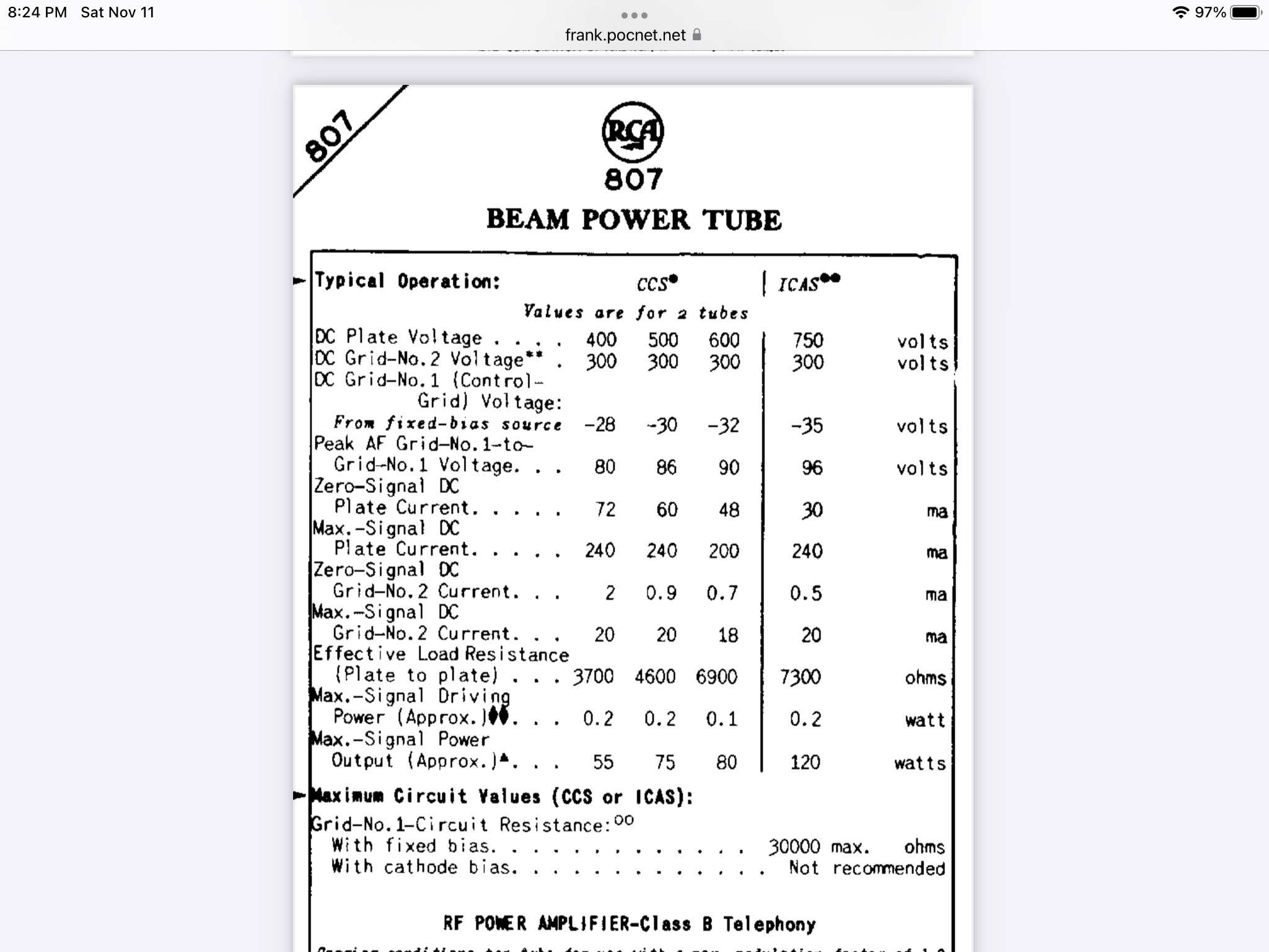

That 807 can actually take it though - it’s a 6L6-oid fully characterized for operation to vg1=+30. It can do this because of the large g2 spacing and relatively cool cathode (0.9 A). Don’t try it with an EL34.
I’ve been tempted to try it with 6W6’s to get more than it’s weight class off 170 volt plates. You should be able to guess where that comes from. Might end up in flames but they are only three bucks.
Yes, AB2 operation is well documented in the STC 807 application report, and in other datasheets. I have another pair of mono blocks with 807s in triode PP class A2, almost 13W from only 290V B+. The same OP would probably only produce 3-4W in class A1.

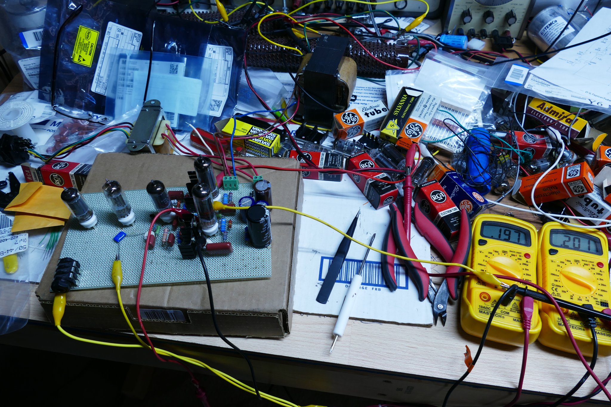

I have a box full of crusty old 6L6-oids including some 70+ year old 6L6G's and 6L6GA's. Will they eat +30 volts on their control grids? And will they do that with 500 volts in the plates? If they survive that how about dropping the load to an absurd 3300 ohms. What will happen?

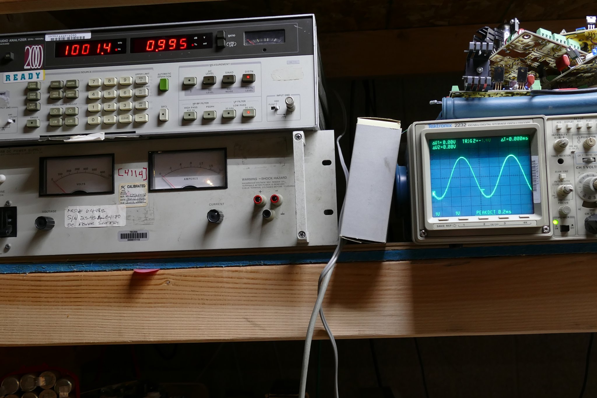

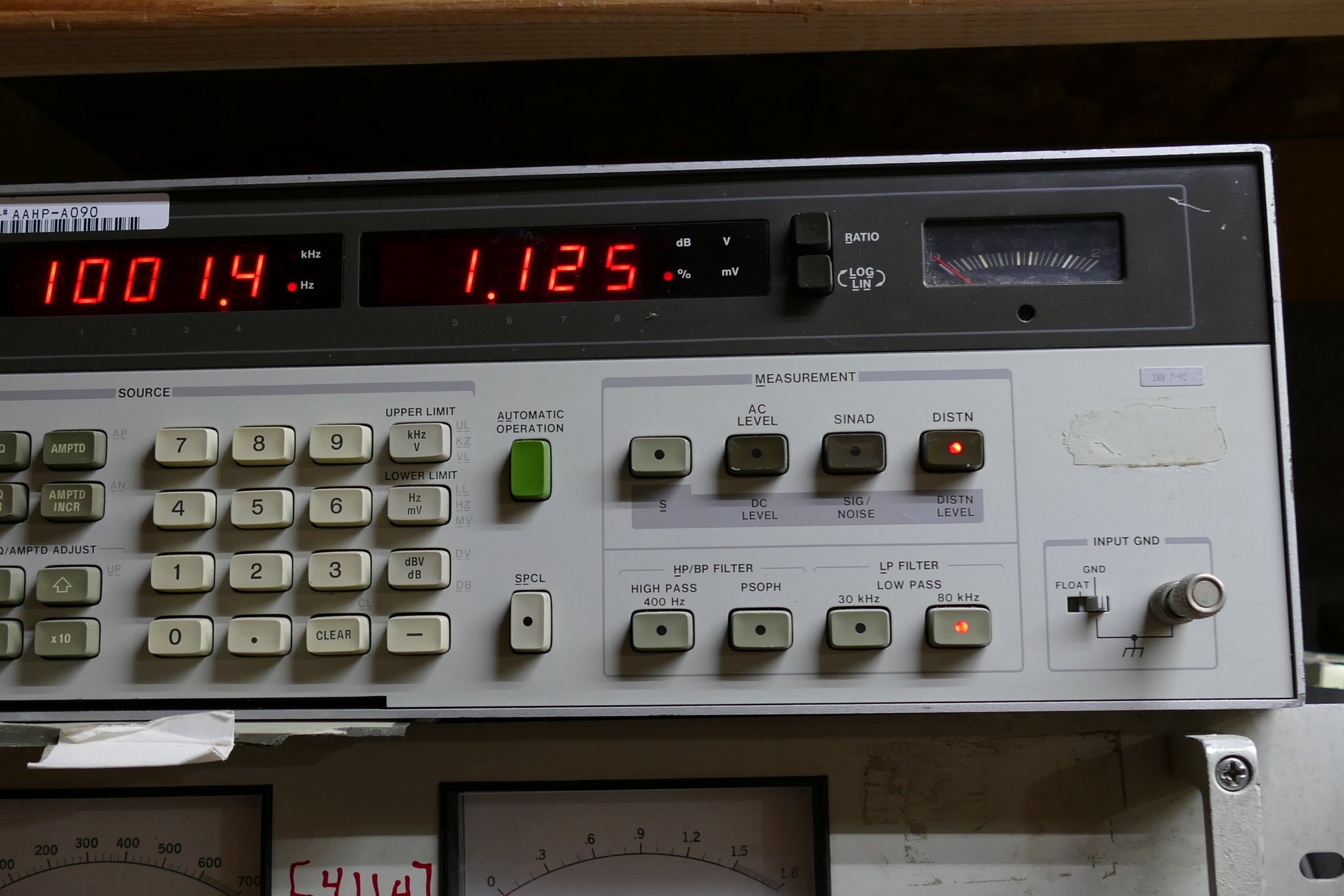

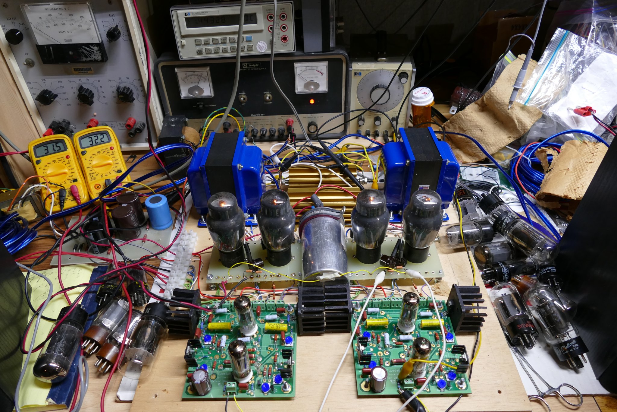

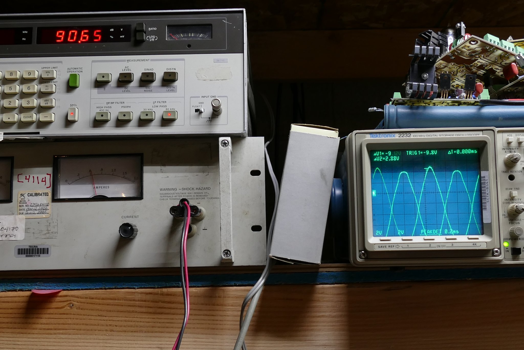

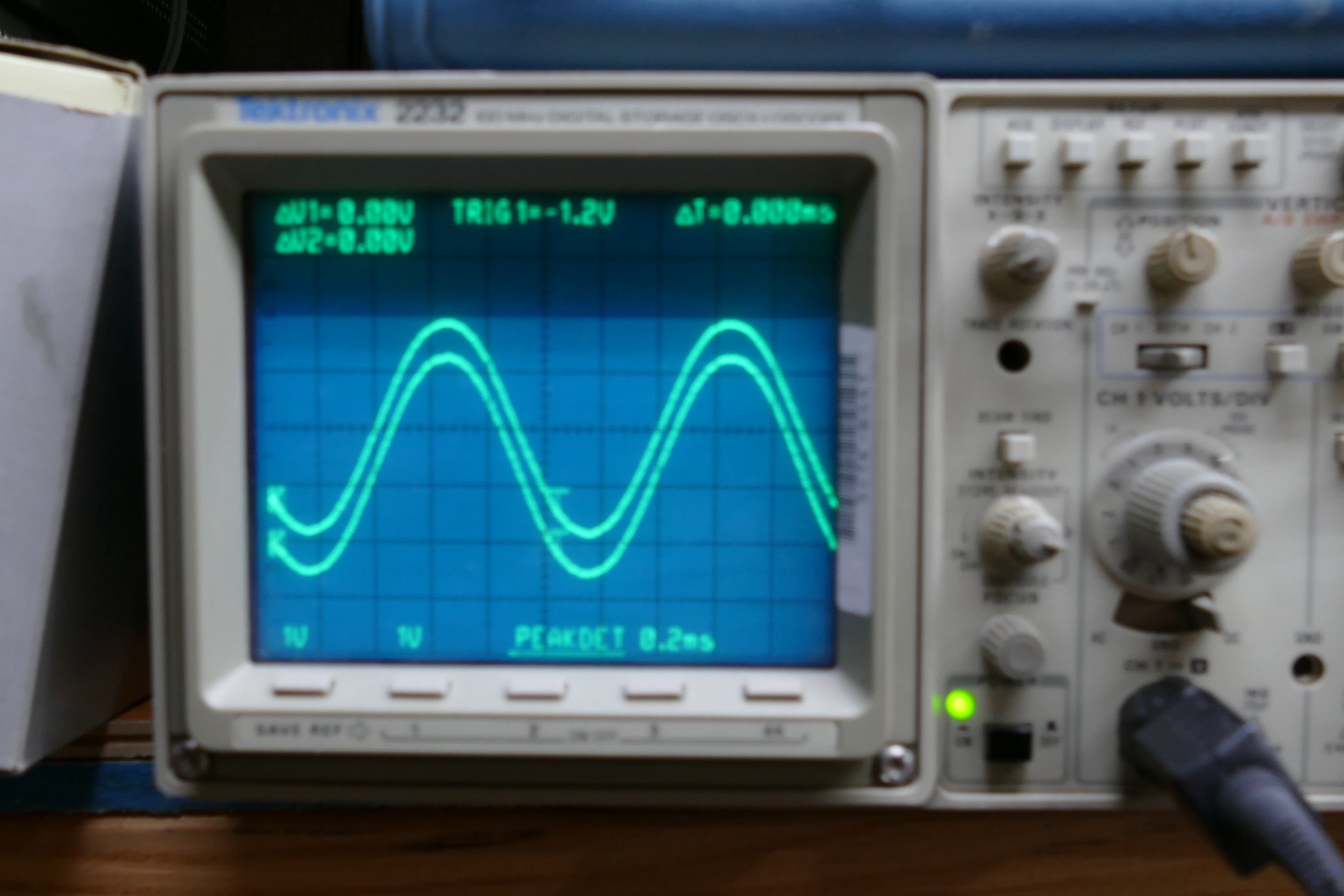

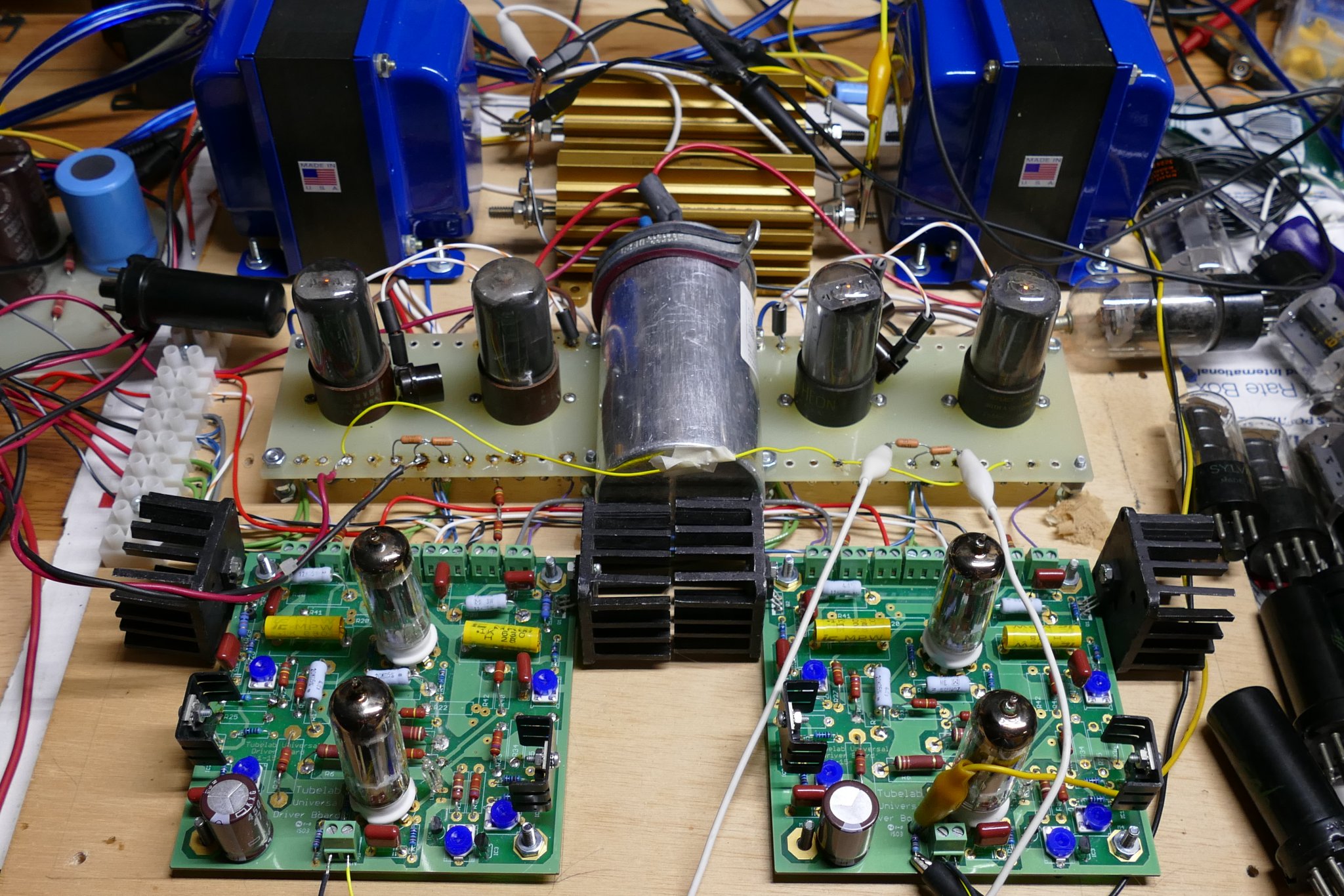

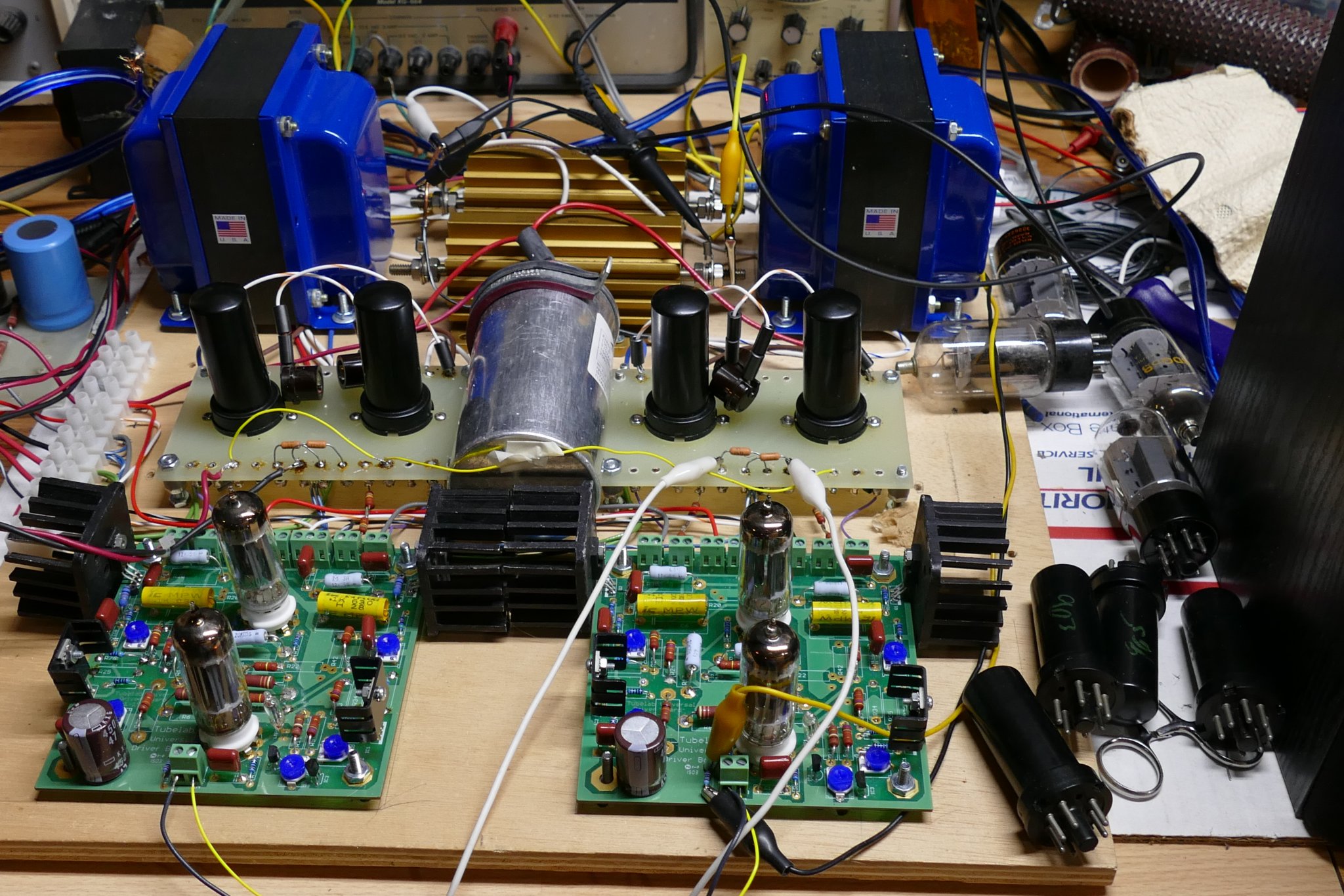

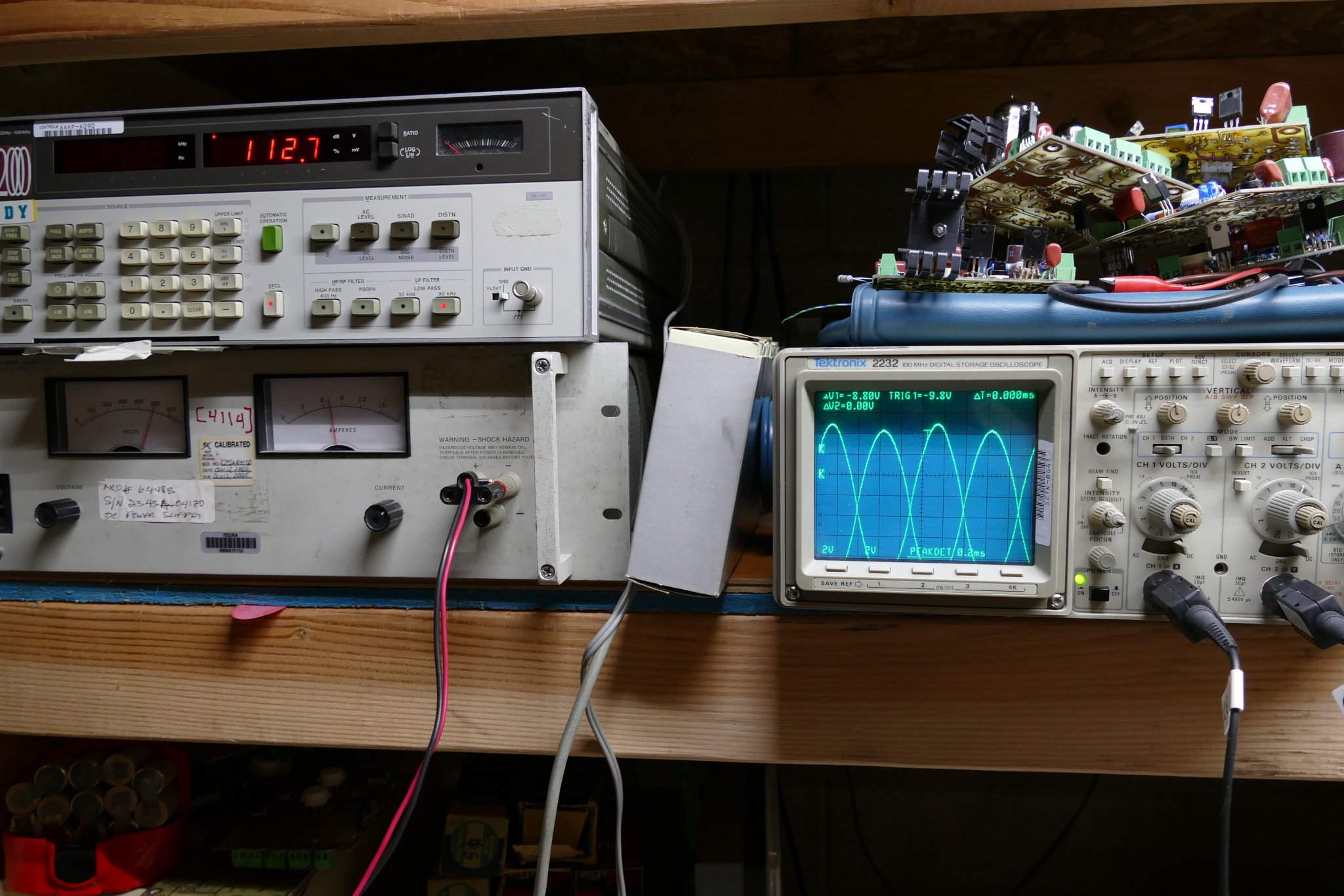

The picture shows the control grids of a pair of 6L6GA's being driven into AB2 by a Tubelab Universal Driver board which uses a mosfet for each grid. I cranked the drive up to touch +30 volts on one grid while the other saw about +27 volts. Nothing spectacular was happening. Power output was 73 watts. So, whats next? You know what's next. +50 volts on one grid and +40 on the other. Power output is 90.65 watts at 8.22% THD. It sat at this level for a couple of minutes before a pale glow was seen on one tube.

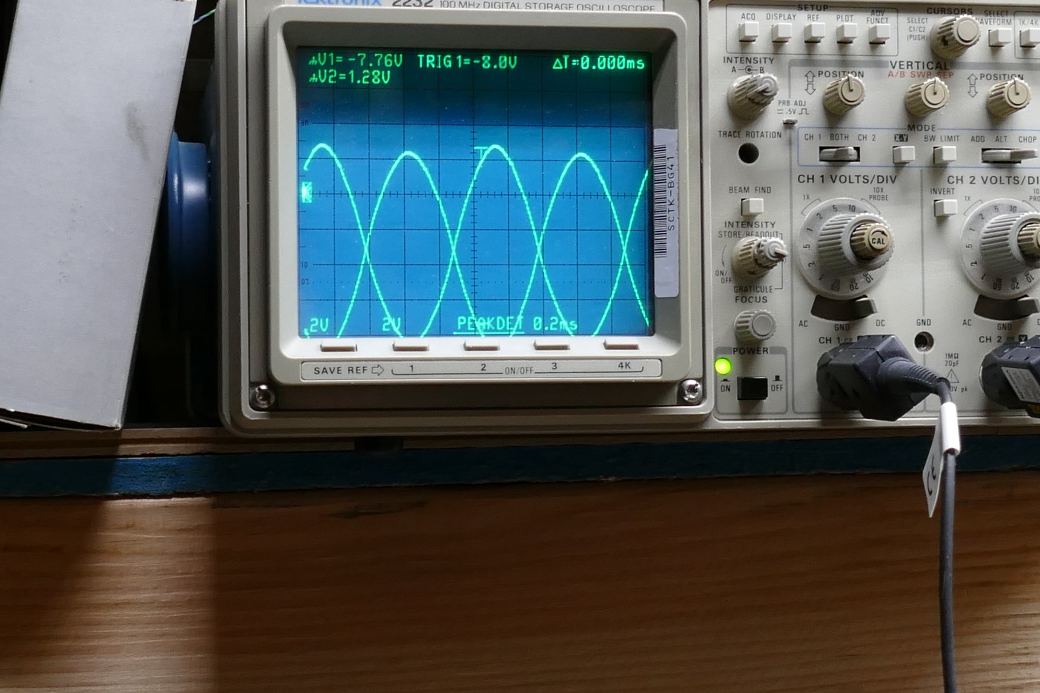

I decided to connect up the second channel and play musical tubes to find some that were better matched. I had both channels running for a while running 6L6GA's or 6L6GAY's. During this time I passed the 110 watts per channel a few times. Attempts to go beyond 110 watts ended with the same result twice. A tube arc occurred twice in two different tubes as I passed the 113 watt mark. Both times the 1 ohm 2 watt cathode resistor popped like a bad firecracker. Both times the tubes continued to work at the same performance level even after the arc.
Here one grid sees about +42 volts while the other is getting about +45 volts. Power output is 112.7 watts at about 7% THD. I moved the 8 ohm load to the 16 ohm tap to reflect a 3300 ohm load on the tubes. Maximum power went down to 95.7 watts limited by red glow on the plates and grids. One look at the control grids reveals the real issue. +60 volts on one tube, and a clipped 58 volts on the other. I killed the power before killing the tubes.

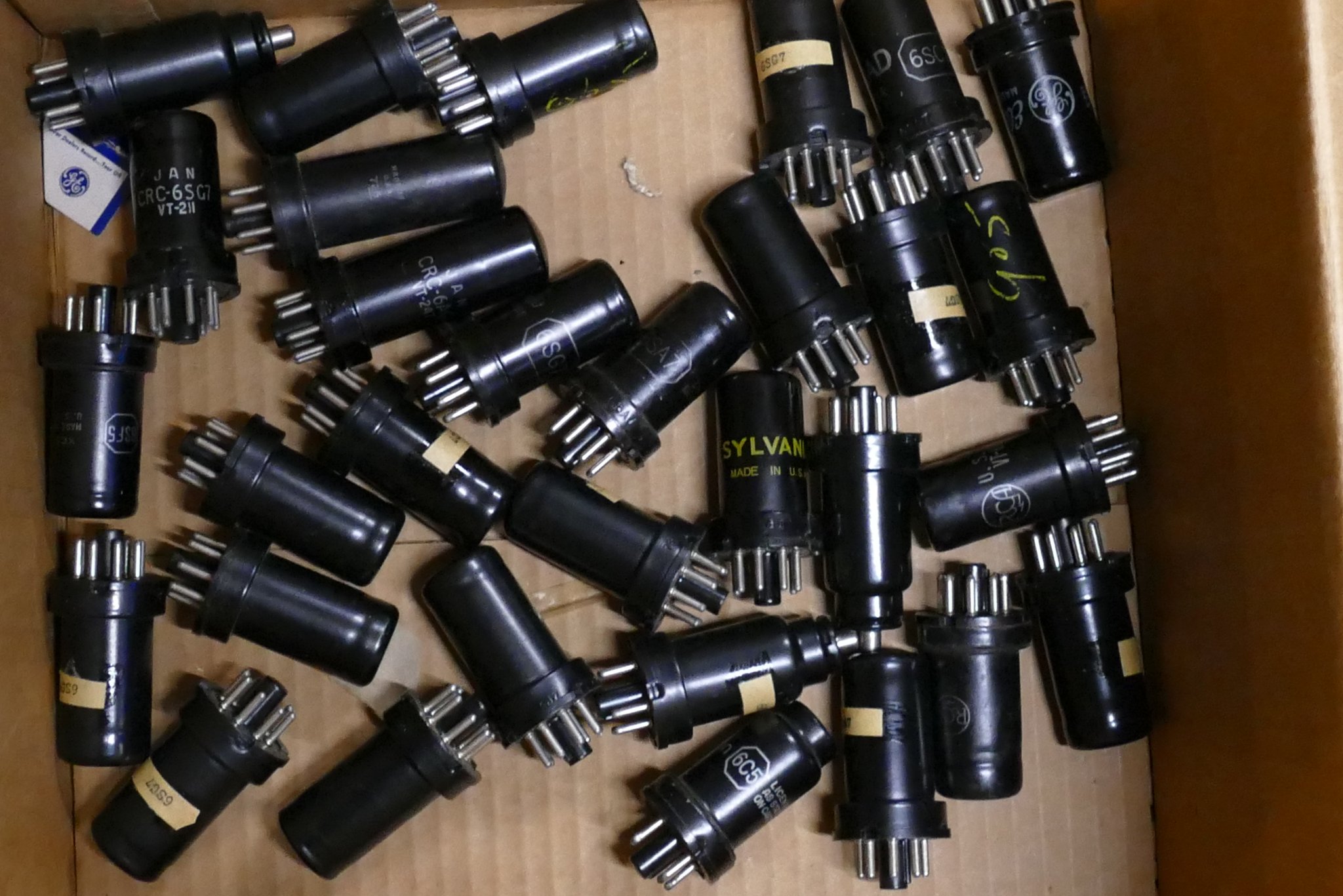

I have a bunch of old 6L6G's and GA's that I don't mind beating on, but oddly I haven't blown any up.

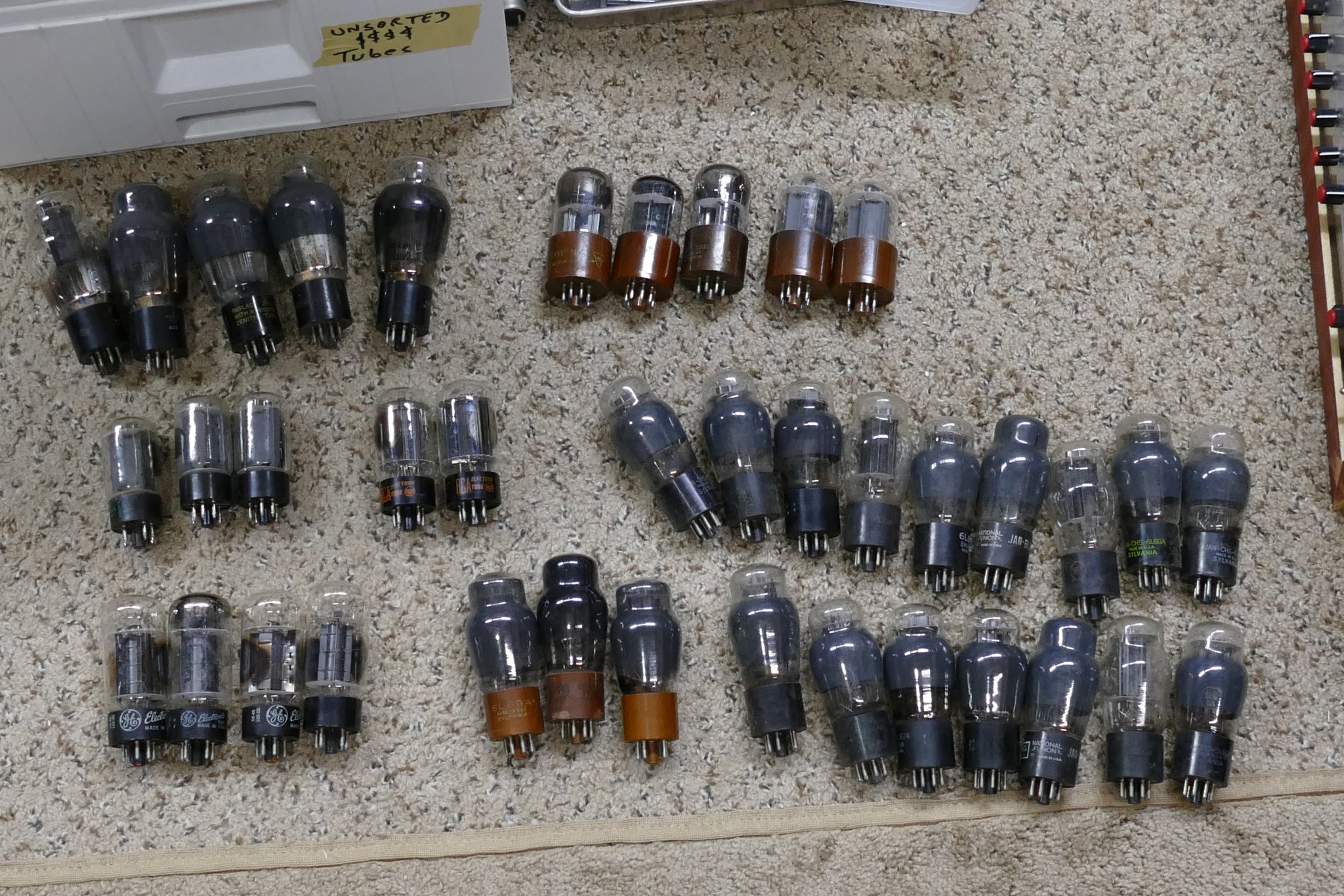

I have been collecting old metal tubes for building a guitar amp that I will call "MetallicAmp, all tube, no glass." My aim is to build a modern sounding high gain screamer with parts from before I was born (1952). So, what could Leo Fender have made if he didn't try to cut every corner he could? No mosfets, no silicon or germanium anywhere. No PC boards either. So far it only exists in the mind of the computer (LT Spice). Here I did test eight metal 6V6 tubes that I got in a box containing about 30 tubes for $5 at a hamfest. They all worked, and I'm not going to abuse them. They gave me 25 watts at 1.225% THD.
You mentioned the 6W6. The 6W6 spawned a bunch of tubes in octal, 9 pin and 7 pin variants. Here four crusty looking 25L6 tubes (a 25 volt 6W6) are being run on 350 volts plate and 250 volts screen. Power is 31 watts @ 1% THD. I have been to 400 volts on the plate but the tubes really didn't like it, but they are old and well used. This prompted me to buy 100 6DG6GTs from Stan for $1 each several years ago. Looking back it might have worked better on a lower screen voltage.
Some of the 6W6's and 6DG6GTs will be tested in the UNSET test amp soon. Right now my 100+ WPC 26HU5 UNSET test amp is being used to push my Yamaha NS10M Studio monitors around on the bench.

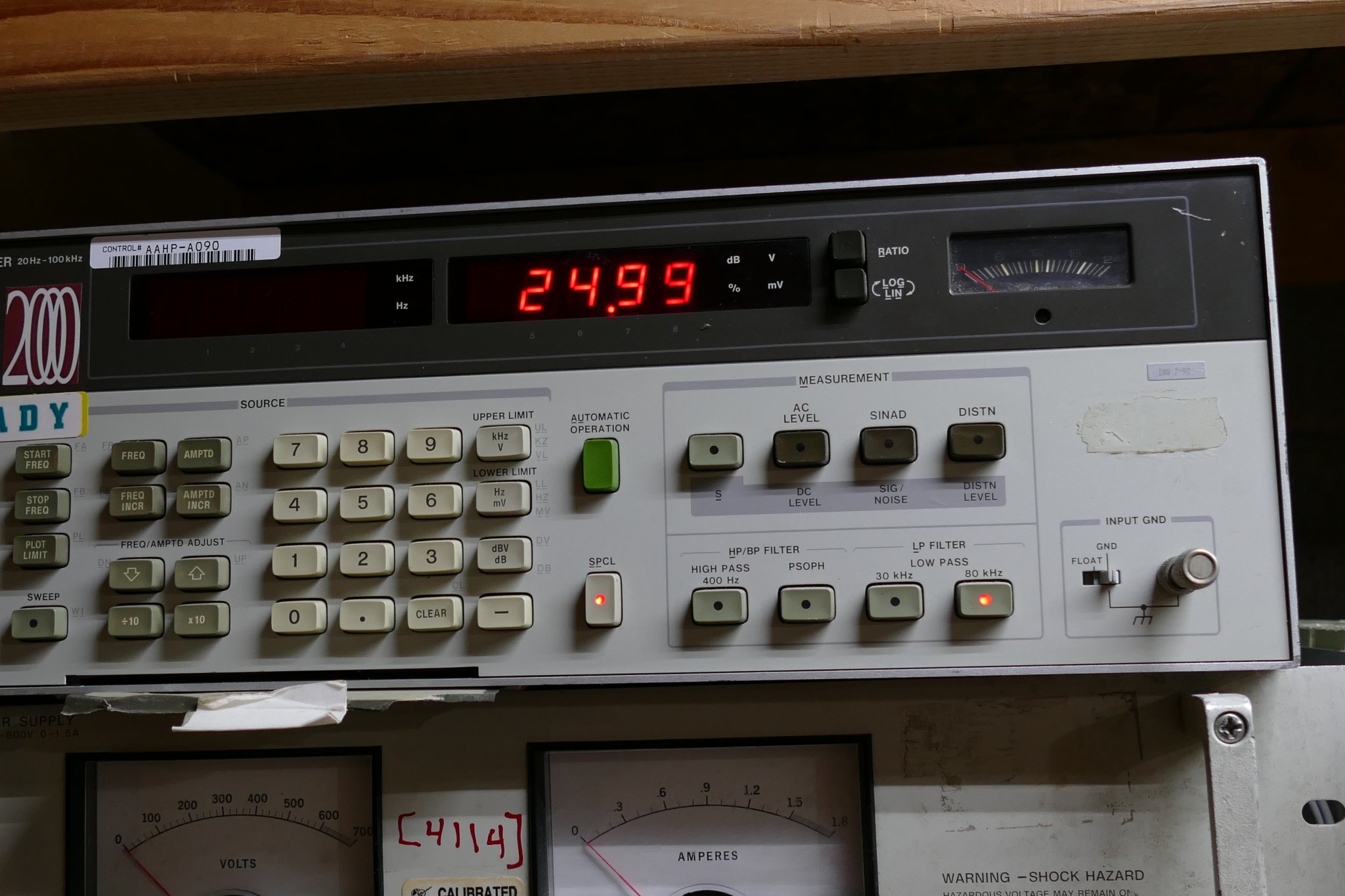

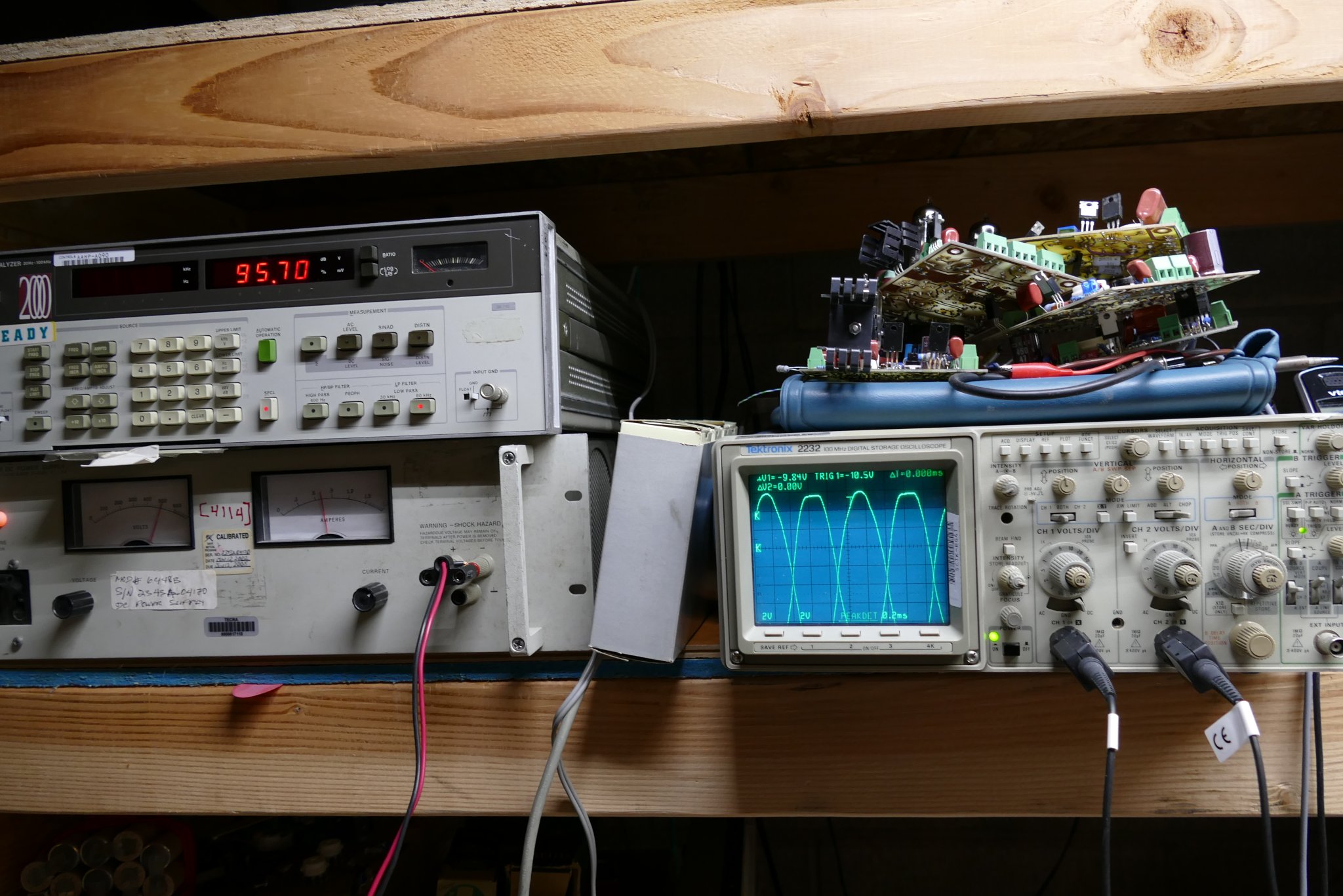

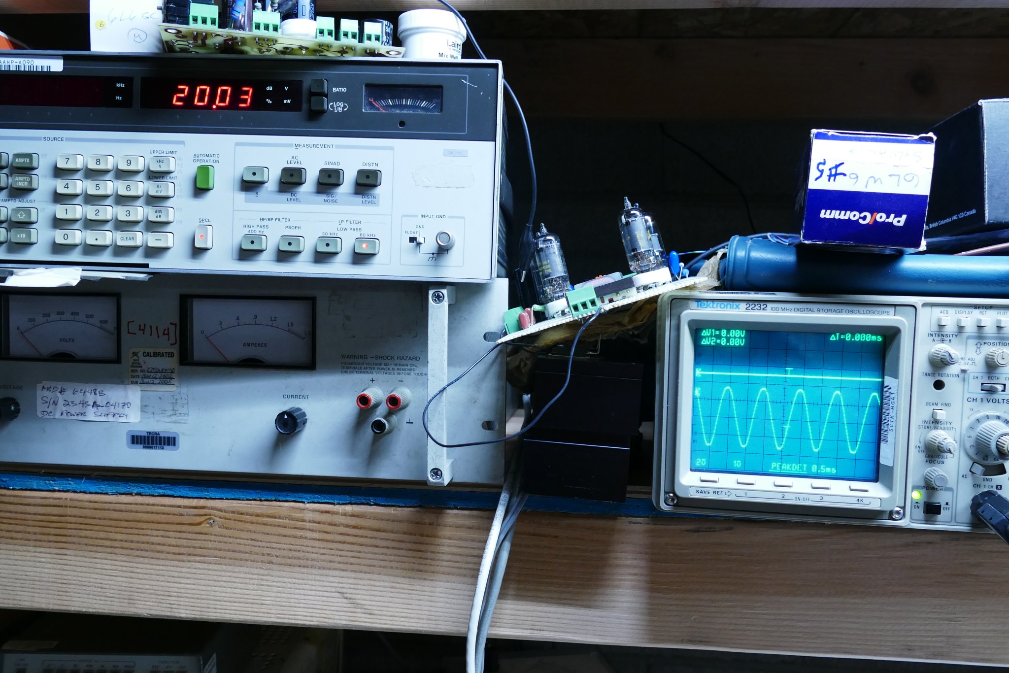

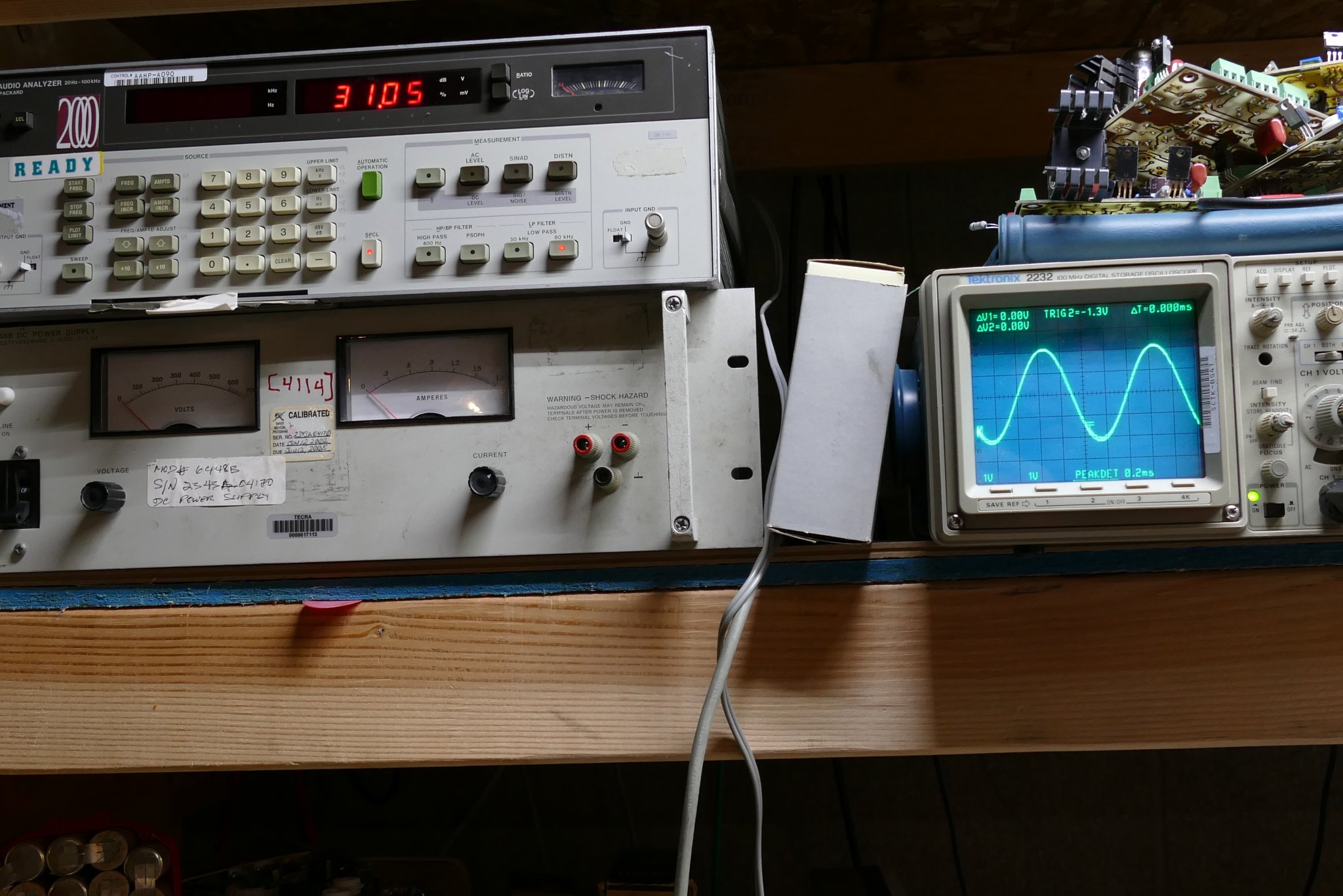

Anyway, just for the hell of it, last night I did a frequency response measurement of the toroid pictured in the first post. Put a 600 ohm load across the series 120V+120V windings and fed the 28V side so that 60VRMS came out the 120V+120V side. Power level was 6 watts. Could have gone much higher but i didn't have much in the way of dummy loads, and I wanted to see how low in frequency I could go. At the 6 watt level the transformer began to complain below about 13Hz. So anyway, here's the graph.
0dB at 1kHz
-1dB at 7.3kHz
-3dB at 14kHz.
0dB at 1kHz
-1dB at 7.3kHz
-3dB at 14kHz.
