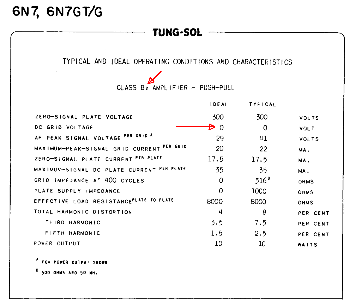

Surely Class B2 is non existent and should be classed as Class C, if it has no bias current flowing. Very common in poor quality amplifiers for RF transmitters, back in the old days.
B2 is a trade name owned by B2Audio.com

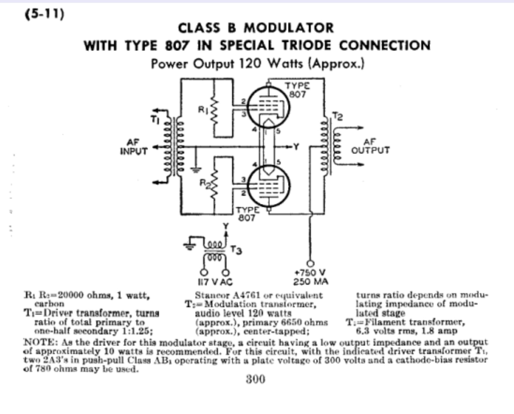

(Post # 7, schematic; I hope crazy drive circuit is better than that).
Old RCA AM radio transmitters for military service is not exactly Hi Fi.
Talk about crossover distortion!
Talk about damping:
Given a large voltage from a bass drum hit that quickly collapses to zero volts, there is No amplifier control of the woofer cone which is trying real hard to return to center!
To each his own.
Real “crazy drive” would crack them open a wee bit more than that (some non zero bias). Still more crossover distortion than typical, though. Post 7 is for an RF modulator. Ham radio operators don’t care about crossover distortion - just how much out of band emission at (around) the carrier frequency. Filters and antenna tuners can take care of that to some extent.

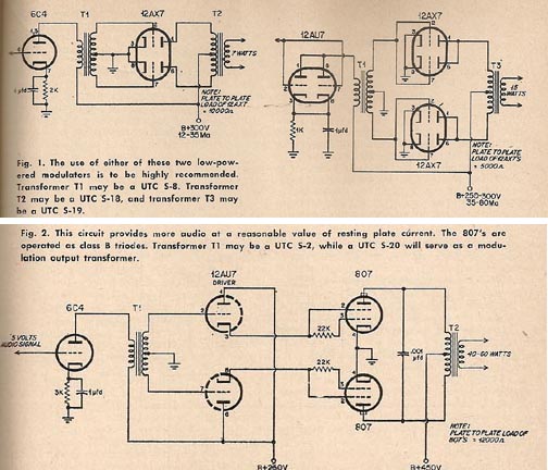

Notice that RCA mentioned a push pull driver for the interstage transformer,
but that they did not dare to talk about the idea of global negative feedback that would include the interstage and output transformer.
Global negative feedback:
Not needed? Not for Hams and Military.
Not possible, right not possible. Exercise in futility anyone?

The easy way out so that your sanity is still intact is to drive the grids with a PP CF.
Adjust the bias on the CF grids so that the output tubes run a little +ve, That way cross-over distortion is reduced.
PP 807s are driven here by a single 12AU7. No need for an expensive IT.👍
