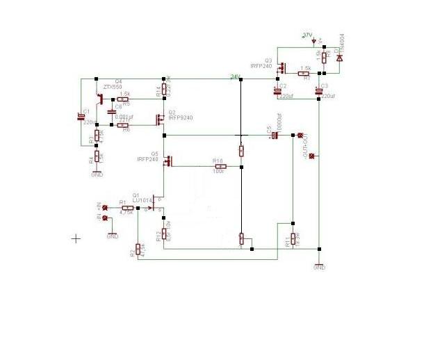

Why no this way . . . ?

hehe
magical eraser
you miss one black spot under the source of Jfet.......:devilr:
no SRPP
no Mu folower
plain ole cascode
less gain........
more distortion....
I have no doubt that steen will try this too
and let us know what is more pleasent to ear.........

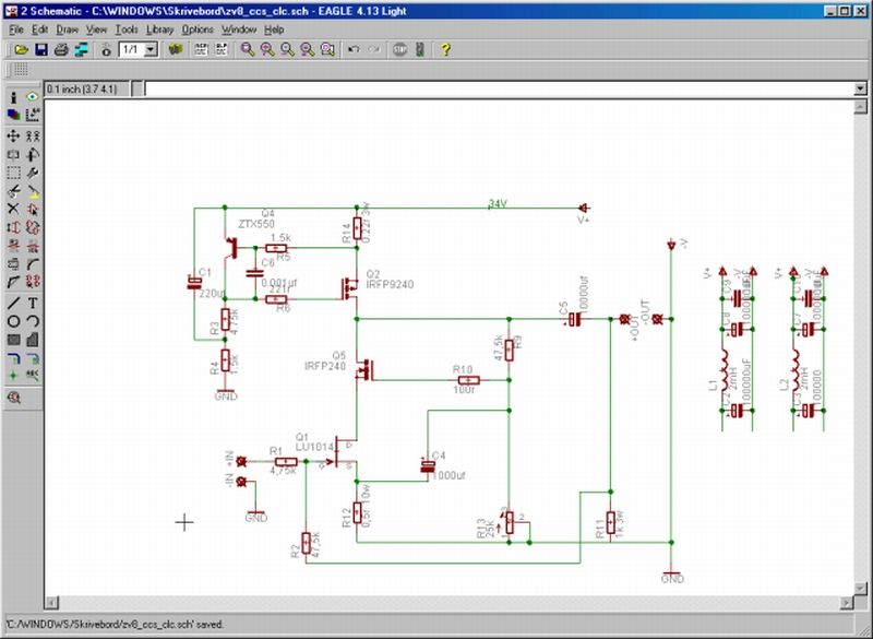

and don't worrie about it to much... but it looked like a wasted oppotunity to me that's all .... MOSFET is fine is that position, for BJT you may have to change more values so just leave it the way it is...
... 😉 allthough a BTJ would give you 3 or 4 more Volt output......
Thanks Tschrama🙂
Yes I have thought about that too. Since I have a pair of nice trafo's with 2x25V secondaries I think I will try this one first. See schematic. Looks like a pretty "organic" amp to me.
Steen🙂

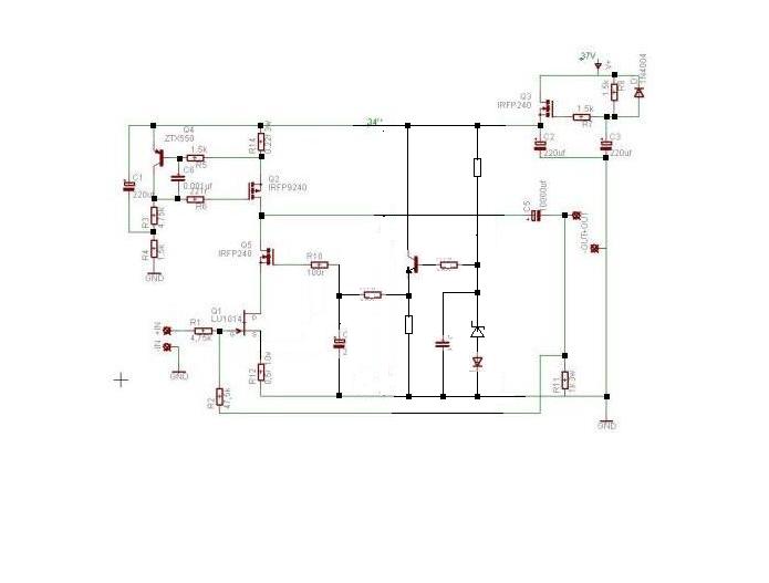

Never to interupt Steen . . .
I believe that your schemetic is elegant as it is . . .
Just curiousity with a small variation . . .
What about this . . . ? :devilr:
Tooboo man, the dot gone . . . 😀 . . . won't you learn by answering my stupidd Q . . . :devilr:

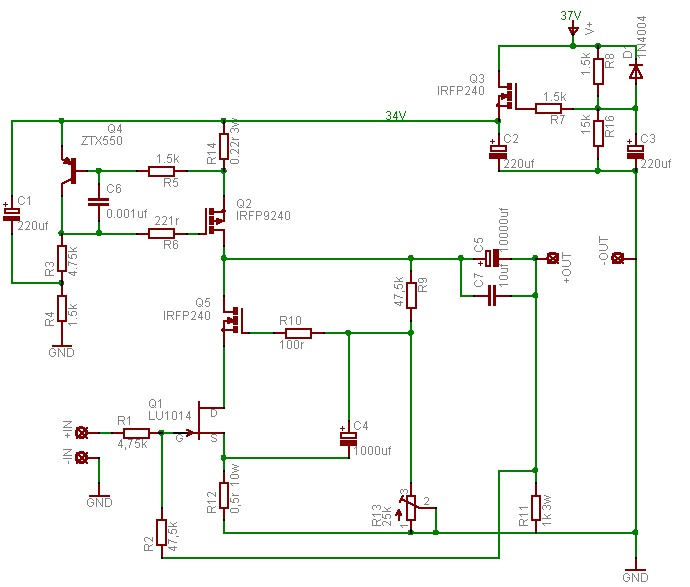

I cleaned up the schematic a bit and added R16 and C7. This will be the first attempt on a Jfet poweramp for me🙂
The picture attached should be a little prettier than the first one.

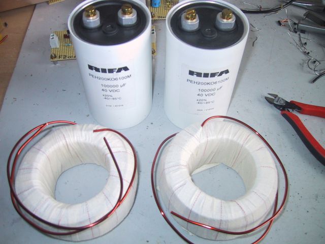

Hi Steen, have you bought those inductors directly from Magura?
Yes, I was lucky enough to pursuade him into winding some of those for me. I have 4 in my A-X's also 😉
Steen🙂

Are you ready to lose 7V or more through Q3 . . . ?
Hi, JH thanks for pointing that out. I think I have a big trafo with 30V secondaries, somewhere in the garage. That might do the trick. There is a minor mistake in the schematic above. The supply voltage above the reg should read 40V.
Steen🙂
Nice circuit indeed .. very interested in how it all works out.. the 'cap multiplier' now looks better to me .. you can experiment with leaving R16 out .... indeed the voltage drop is now a additional 3.7 Volt ... so if that's a problem, try it without R16 .. or use different values.. 47k-to-15K ..

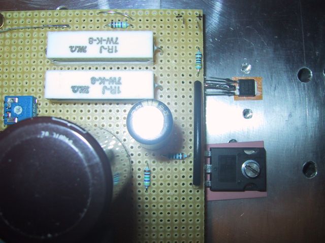

I didnt design boards for this amp, I used perfboards. A nice board would certainly be nice.
BTW I have one channel playing music, but there is something wrong with the other. I will take a look at it tomorrow. In the meantime here is a pic of the little bugger, sitting on its kapton sheet.
Steen😎
