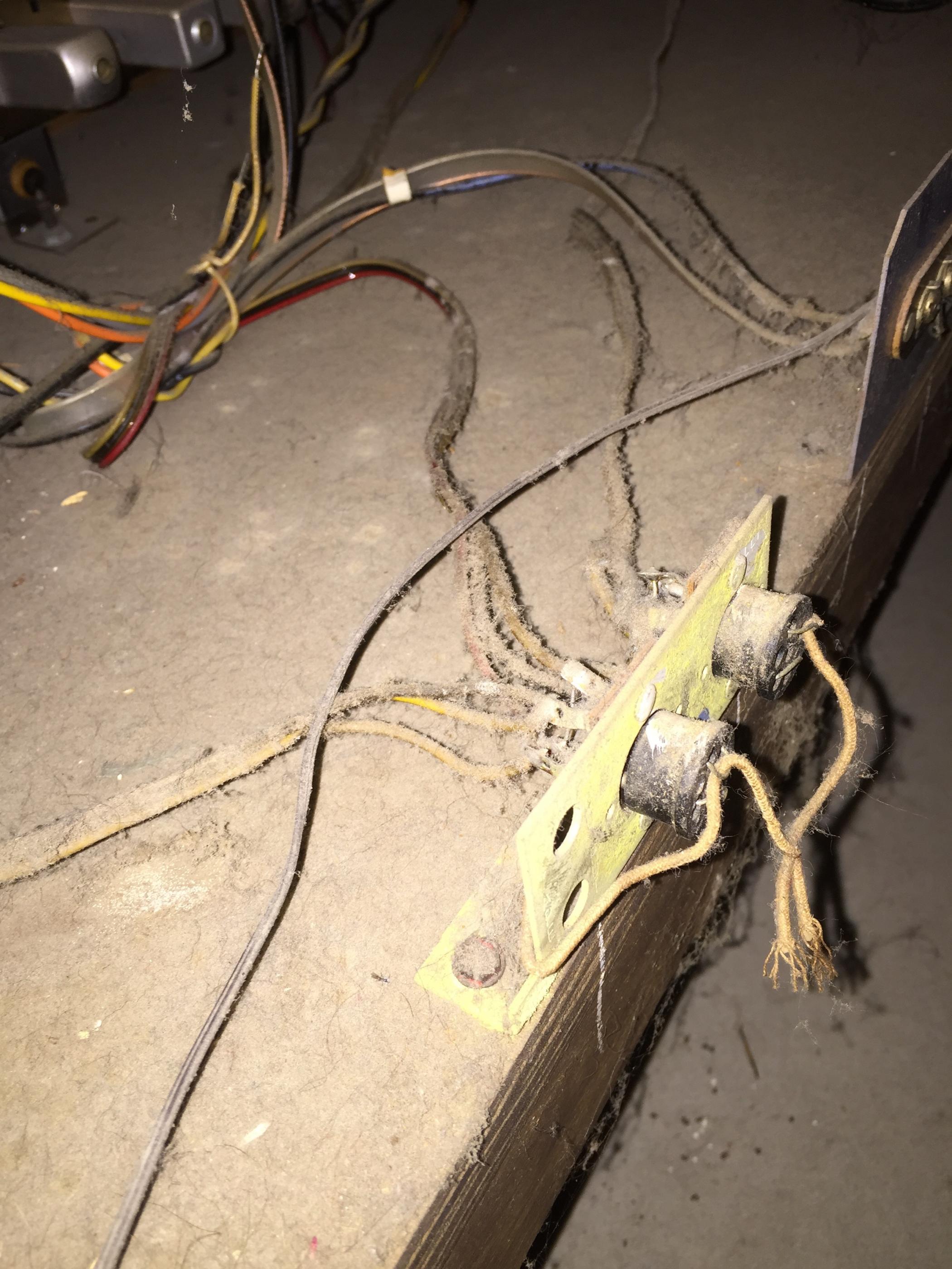

Hello, I am new to this so forgive me if my inquiry is vague or unclear. I will try to be as specific as possible. I have a Zenith Cabinet stereo from the 1960's. I was thinking of building new speaker boxes and removing the speaker components from the old cabinet to place in 2 newly build boxes.
1. Is this possible?
2. How can I get information on the wiring system? I would want the speaker wiring to be the normal way to input into a 1970's pioneer receiver. I removed the back panel of the entire cabinet to view the wiring. The wires from each side go into another "thing" sorry don't know what it is, then go into the built in receiver.
My cabinet is a Zenith model X940W (The Kirsten)
Please let me know what can be done here and let me know if you have questions. Thank you very much.

Pictures are your friend, of the amp, the back of the amp, the speakers on each side of the cabinet, and all of the wiring and crossovers.

Its possible. You need to trace the wiring and the internal x/o,
and replicate in the new boxes. Replace old caps in the x/o.
rgds, sreten.
Most likely there will not be much to the crossovers.
rgds, sreten.

Its a pretty trivial exercise for anyone
who knows what they are doing.
Ask around for someone to help you.
rgds, sreten.
