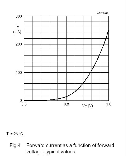

How much current through the zener would you guys recommend?
I have been recommended using a constant current diode of 0.5mA, but is't that a little low?
Check the V-I curve of the zener and bias for a point
of sufficient stability. In addition, zener voltage noise is inverse
proportiional to the square root of current.
The tests in the datasheet where done with 5ma current. Is this a good value to go for? (Good... I want the BEST 😉)
Alcaid said:Do you mean this graph?
Don't understand how to find the right value.
It's a BZX 79 15V zener.
This is the graph for the forward current. You need the one for the reverse current. Then find a spot where it is relatively flat.
Jan Didden
Well, the V-I diagram with the reverse current isn't in the datasheet. Where can I find it then? anyone?
You won't find it... but the parameter "dynamic resistance" can be useful. This parameter says how much the curve is going up, the slope, upwards.Alcaid said:Well, the V-I diagram with the reverse current isn't in the datasheet. Where can I find it then? anyone?
That is correct. Look in the table differential resistance for your zener, I think it was a 9.1V zener?
You will see that at 5mA reverse current the dynamic impedance is max 15 ohms. That 5mA also seems the current where the zener voltage variation is closely centered around 9.1V, so that seems a good value.
