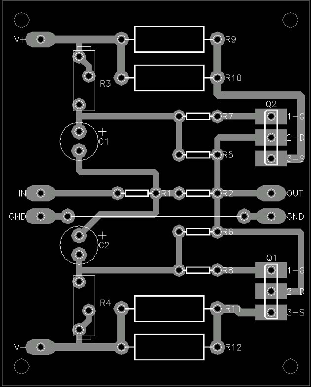

Put a cap across the series combination of R3 and R13 and take the input cap to the gate resistor of one of the mosfets. Power supply noise will modulate the bias current for the mosfets and show up as part of the input signal. The gate to source voltage is pretty sure to be different for the 610 and 9610 mosfets even with the same bias current through them. You probably want to put a pot as part of the resistance of both R10 and R11 as you will need to adjust the gate to source voltage across R3 and R13 (which can be one resistor now) you will never get a stable bias current for the output stage without some degeneration. I would be looking at 1 ohm and 0.5 ohm at the very least. Your DC offset is still going to move to a great deal I fear since the negative feedback is DC coupled as well as the bias and DC offset moving with power supply changes (and they will move as the line voltage does. It is probably a workable topology if you pay attention to these concerns. Of course, I gladly submit to any veto power that Mr. Pass might exercise. It is actually has the potential for a good amplifier in my first estimation. I might shoot for 30 volt rails and an amp of bias for the output stage. I will definitely simulate it and might build one if the Spice results look reasonable for stability and open loop gain.

Fred,
Maybe we need to take this design to the next level. I like your ideas and maybe double up the output stage ( with suggested source/emitter resistors ).
I will post my design as soon as I get it working.
Pedro,
Nice, clean layout. The only thing I would do different would be to thicken the B+, B- and output traces. ( How about local decoupling caps for the B+ and B- rails)

jam said:How about local decoupling caps for the B+ and B- rails
[/B]
what do you mean by that?
I allready made some track thickness changes to 3.0mm. Is this ok?
Pedro,
I ment to add some capacitors about , say 100uf, between the supply rails and ground, close to the mosfets and ground. I would make the tracks as thick as possible.

jam said:Pedro,
Jam
sorry about the question, but what is the purpose of those caps?
