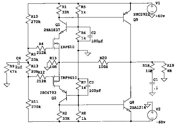

Re: Food for thought?
Looks pretty good as it is. Your idea? No emitter resistors on the 2922/1216?
