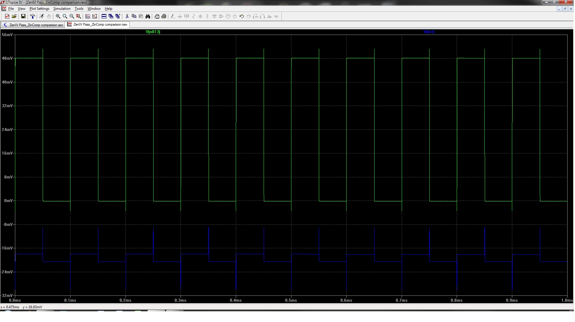

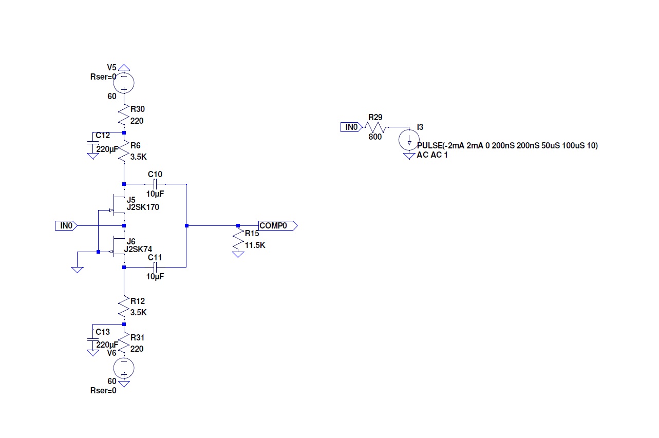

The most interesting thing from without the compensation on so far is that I fat fingered the compliance voltage for the circuit as drawn for the 1541. Running without compensation on it wasn't ~40mV, it was ~400mV of compliance. Ohm made it simple, I messed it up...
Correction - ~40mV was correct. Power supply voltages needed to be bumped to 60 volts to ensure jfets will function...
Here is a picture of a "stock" Zen I/V with values figured for a 1541 with no low pass filter. Stimulus is a square wave current of +/-2mA with 200nS rise and fall times. The gates of the jfets are grounded and there is a nice square wave voltage pattern on the input as expected (~40mV or so, see the second picture). I should point out that this rise time represents a 1.75 MHz bandwidth.
I will post the Zin Compensation circuit with and without loop comp in the next reply. 🙂

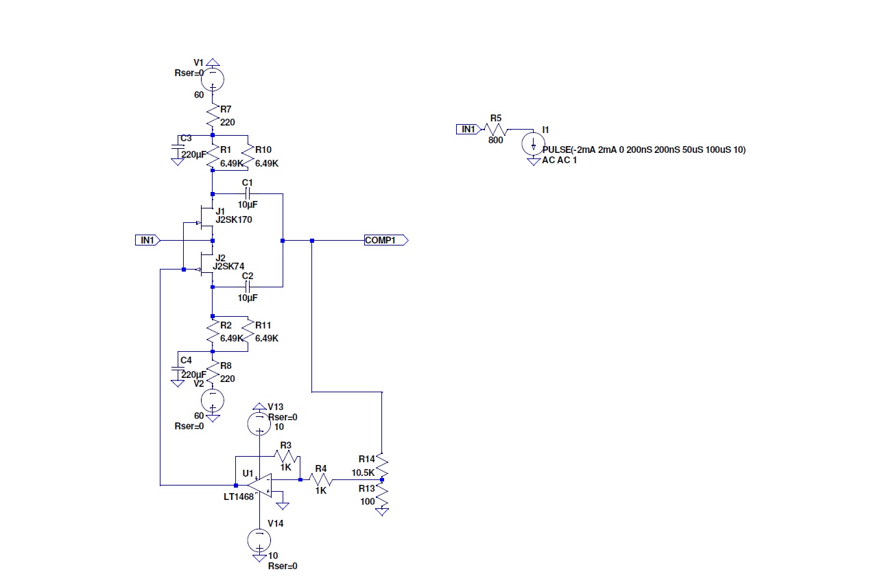

The next picture is of the same circuit with Zin compensation stage added, and with no loop comp capacitor. The gate compensation voltage waveform is on top in the second picture, the input on bottom. The waveforms are offset so that they are easy to see.
As you can see, the input compliance voltage is reduced to <3mV. The spurs on the input are an artifact caused by the phase error I described earlier. They are not ringing, simply a single spike each.

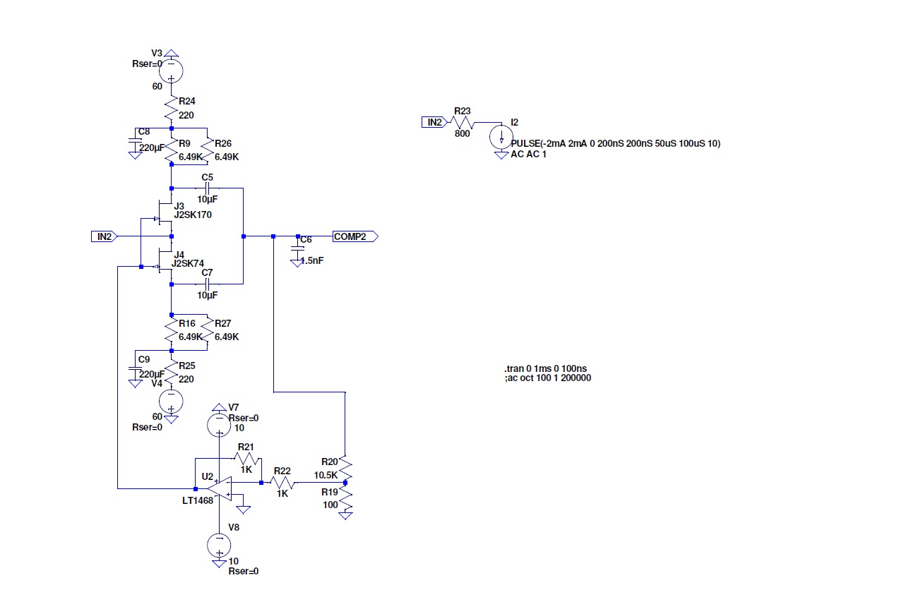

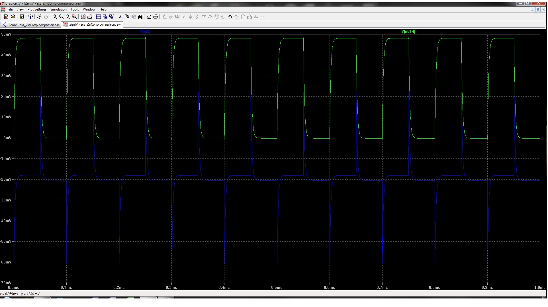

The next two pictures are the circuit with a 1.5nF compensation capacitor added in. This is actually the correct value to match the original Zen I/V roll off at about 20KHz.
As you see in the traces, we have added more phase error into the compensation signal, causing the spikes on the square wave to increase proportionately with the additional phase delay. Still no ringing...
A real circuit will not be nearly so idealized, and likely need some compensation. I look forward to building one soon and am collecting parts for this and a Sabre version as we speak. It will likely be weeks on this end.

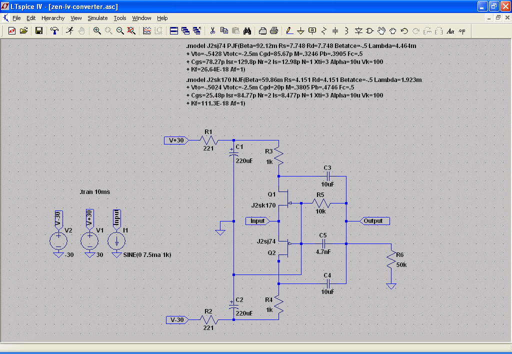

Question: What is the correct formula to determine the value of the outout filter cap? Right now i used 2n7, guessing that a higher value drain resistor corresponds with a lower value capacitor
regal,
Try this for the spice directive and see if it gets better... You probably see input voltage offset because the JFET models do not have matched IDS. If someone can fix the models to say 10mA so they appear matched and there is no input offset, it would be appreciated!
.tran 0 10ms 0 10ns
Dave
