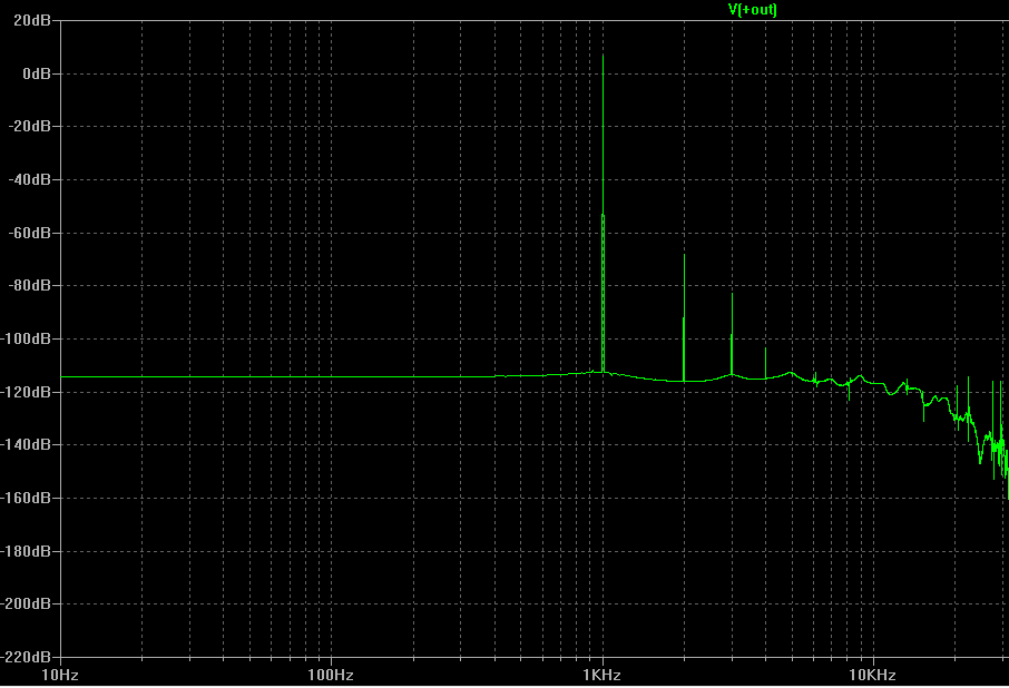

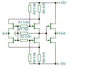

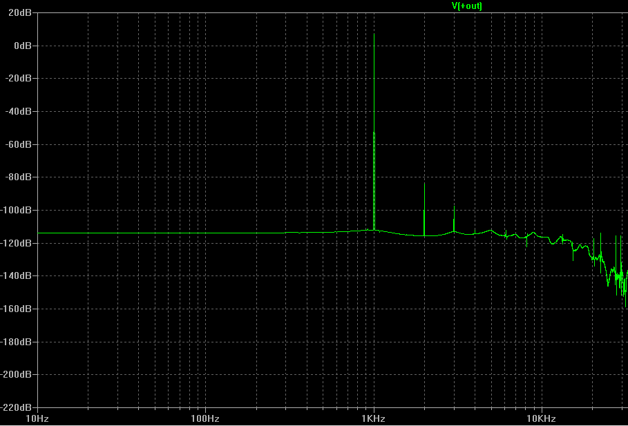

Since the merits of the floating supply keeps coming under scrutiny, I managed to dig out a circuit which I believe originates from Mr. Loesch.
It is basically the same folded cascode design as I posted here but with JFETs as cascode device instead of MOSFETs :
http://www.diyaudio.com/forums/pass-labs/173291-zen-i-v-converter.html#post2298531
Using matched JFETs with 8mA Idss, floating 16V or +/-16V supplies, 2.4mA p-p sinusoidal current input at 1kHz,
I used LT spice to simulate both circuits and compare the distortions.
As you can see in the middle figure, the folded cascode has some 15dB higher distortion, double the supply voltage and number of active devices.
So I guess the pain of the floating supply in the CEN / SEN is still well worth suffering. 
Patrick

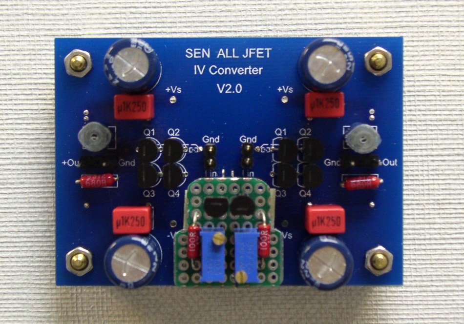

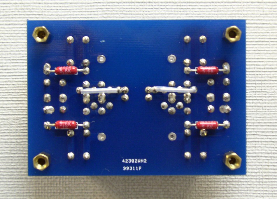

For those interested, here is our quick-&-dirty prototype of a SEN IV for PCM1794.
It uses the V2 PCBs, 8x 2SK369V per PCB (one balanced channel), and 2x 18V floating battery supplies per PCB.
Heat sinks not yet installed.
The P2P daughter board at the bottom is a dual 6.2mA Current drain using heavily degenerated 2SK369V.
The heavy degeneration to reduce 18mA Idss to 6.2mA is key to its low Vds(sat) and current stability.
The degeneration resistor also acts as current feedback.
The "tails" of the CCS are connected to an extra -9V battery (rel to DAC Gnd).
Listening test pending.
We still have some work to do to remove the original opamp IV to make space for the SEN.
Patrick

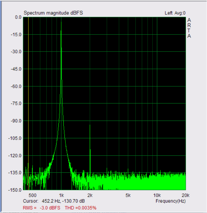

Patrick, one of my best sounding DAC based on pcm1794 is a folded cascode with k170/j74 very similar to your design, but I use current sources instead of R5 and R6.
The distortion measurement is from a similar design. The measurement was made with a pcm1794 at -3dbfs and only 2ºharmonic is measurable. This is a measurement of a real circuit , not a simulation. I real like the sound of this converter.

I am sure measurement does not tell the whole story, and these simple JFET circuits almost always sound good.
We use something very similar in our XCEN Balanced to Single Ended converter.
http://www.diyaudio.com/forums/anal...ced-single-ended-converter-3.html#post3384411
We have listened to a few of these ourselves, but we always come back to the SEN / CEN with floating supply.
It is simply impossible to beat this (essentially) 2-JFET circuit.
But of course I am totally biased. 😉
Patrick

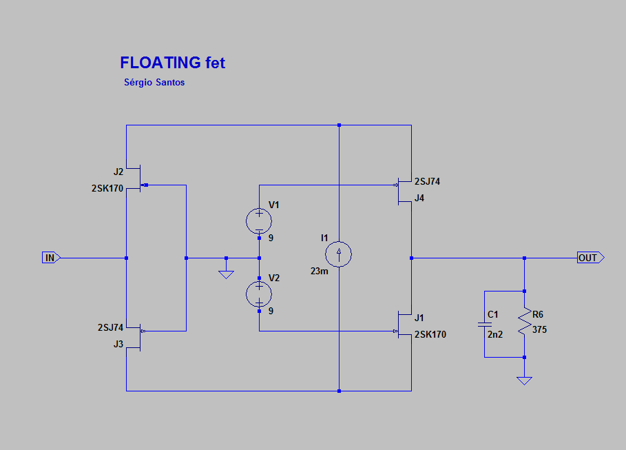

Floating current source
Patrick, one day I will try 🙂 , I promisse.
The problem is that I have a lot of ideas that I want to try, and to litle time.
One idea that may interest you, is this one.
Using a floating current source, instead of a voltage source, with this circuit we have the benefits of the cascode with the possibility of not using capacitors at the output.
The simulated distortion of this is 0.001% with prevalence of even harmonics.
V1 and V2 are only to biasing the output jfet´s and will last for years without the need for maintenance.
If you like the idea, I would like to developed this with you.

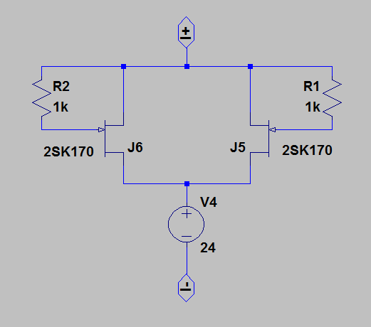

first image is the basic circuit, the second is one exemple of a floating current source.

I also prefer to develop offline, I have also my share of bad experiences when developing online.
It is possible to be simplified of course. One obvious simplification is the floating current source, that only
need one fet, two fets are not recommended, but I did not have the spice model of the fet that I want to use. V1 and V2 can also be discard.
🙂 glad you liked . Your experience in this type of circuits will be very important .
