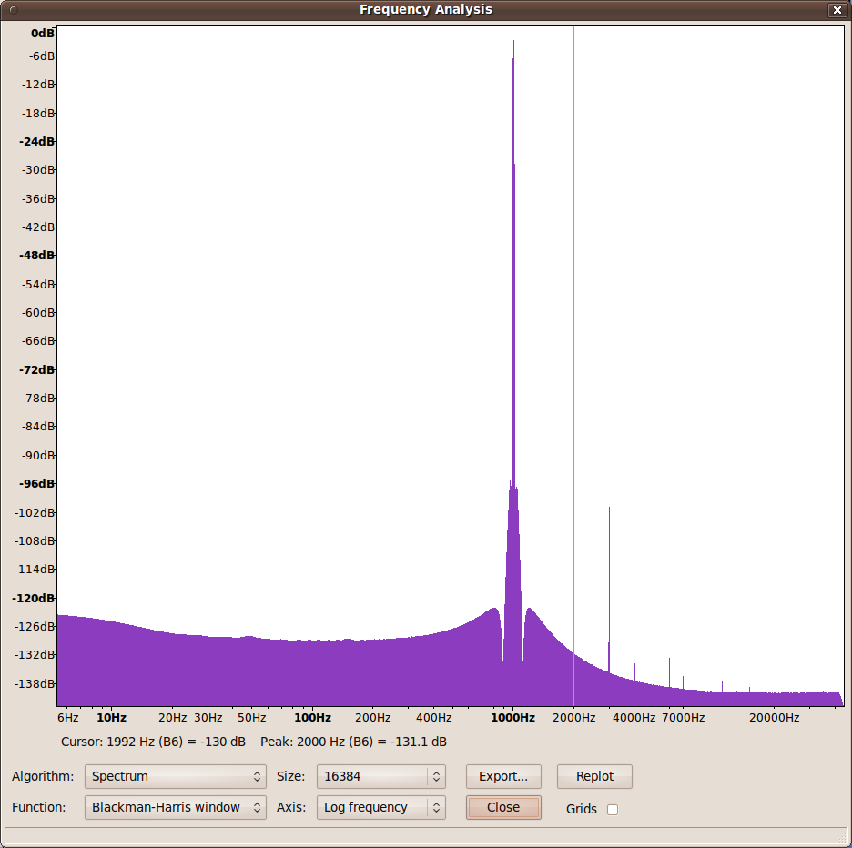

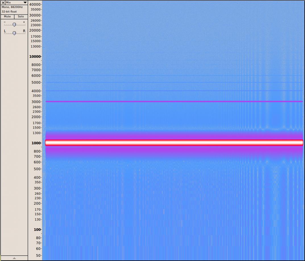

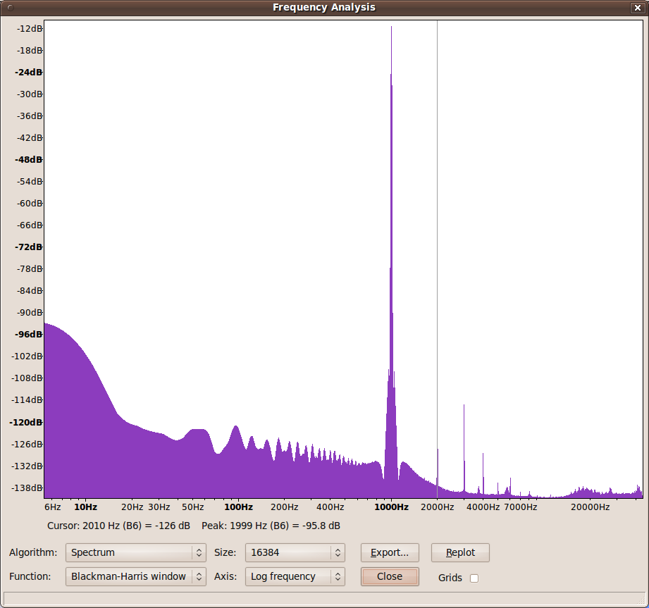

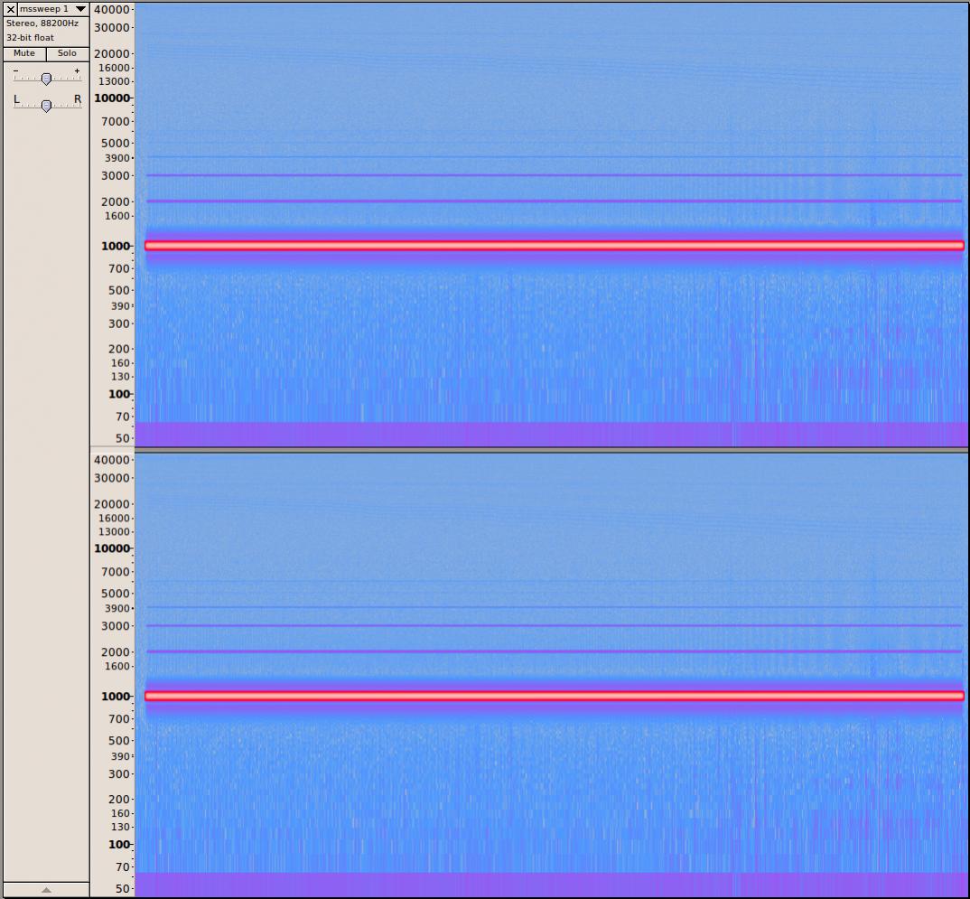

I made some cable by hand - 3 cores braided, aluminium foil shield, copper braid around the foil, PVC heatshrink tubing outside.
Same connection strategy as with the usb cable before and I haven't changed anything else.
It sounds good again but 2nd harmonic is also back up (by 36dB!) to -100dB 3rd harmonic is down from -87.7dB to -91.6dB.
Not really sure what's going on. Could twisting DAC +ve and -ve together prevent the balanced circuit from canceling out the 2nd harmonic properly?
Its seems that the 2H is probably closer to reality, maybe the earlier measurement was a fluke ?
If you read the article at Jan Didden's website, you will know that we had a hard time measuring the circuit to -120dB (or 2.8µV).
And that was with an AP System1 in balanced mode.
So when people reporting measuring to -130dB or even -140dB, they might have super professional equipment that none of us have.
No fluke - there is second harmonic in each measurement of the two halves of a balanced pair and it clearly cancels out when they are mixed together. See attached pictures.
So the total circuit DAC - Sen - ADC in balanced mode definitely had very low 2nd harmonic with the usb cables.
I saw this on all the measurements with the usb cables and I did at least 4 or 5 - it varied a bit, sometimes I could see a little spike at around -130dB.
Patrick
I'm not claiming to be able to measure the distortion from the Sen circuit in isolation, I'm just reporting the numbers of the overall chain.
The components in the chain might be conspiring together to cancel out distortion but the end-to-end result is pretty clear in the digital data as you can see from my previous post.
My ADC is a PCM4220 and I was doing FFTs with 10M samples using Audacity.

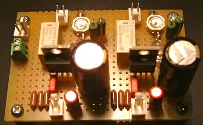

Not much progress this weekend - I tried increasing Riv but my circuit gets too hot with Riv > 256R. I'm not sure whether I just need to add heatsinks to make it work or if it's heating up because increasing Riv is causing it to oscillate (perhaps a problem with the servo which was working really well with Riv=256R).
I did get some more measurements with increased Riv in the window before it becomes unstable with a lower noise floor which you aren't likely to believe either 😉

Has anyone actually made a non-battery PSU for Sen that they are happy with?
Patrick> next project should be a hassle-free, plug and forget LiFePo4 charging scheme
I don't use them, so there ain't going to be one any time soon.
One reason is that they have limited lifetime, even unused.
My current preamp NiMHs are from 2007, and they are still fine.
Patrick
