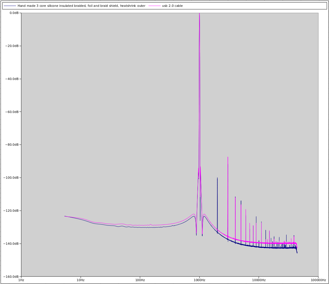

My current numbers are:
2nd -136dB,
3rd -87.7dB,
4th and above all < -110dB
peaks of noise all < -98dB
So I'm currently limited by 3rd harmonic but I still have 12 JFETs in parallel which is definitely too many. When I measured 5 in parallel, the 3rd harmonic was -95dB ish.
I think my second set of servos will reduce all distortion. They are not finished yet. When they are, I can also snip off some JFETs to get 3rd down some more.
I can increase measured SNR by 10dB by increasing Riv from 256R to 800R at the cost of some more distortion.
I'm pretty confident of achieving -90dB.

Help - what's the best way to connect the DAC chip to the Sen box?
I had previously been connecting the Sen box to my DAC chip by plugging some twin core cable with shield into the dip sockets on my sound card after unsoldering some surface mount components to disconnect the DAC outputs from the rest of the sound card. I was using the two cores for the DAC output and the shield for the return current to the DAC ground. One cable each for L+R balanced channels. I had XLR plugs on the other end with the three pins used for the +ve, -ve and DAC gnd with the shield connected to pin 1 but not the plug. The cables went through the side of the computer with the side cover off.
This solution sounded good but was picking up some noise which I assumed was because the shield was being used for DAC gnd rather than as an actual shield connected to chassis gnd at both ends so I spent time creating some short cables to connect the DAC L and R channels to D-sub sockets on a PCI bracket and longer cables to connect the D-sub sockets to the Sen box.
This time I used USB 2.0 cable with a foil shield and four cores. For the internal cables, I pulled out one core and used three cores for the DAC +ve, -ve and gnd. I connected the shield to the D-sub socket shield (connected to the PC chassis) and left the end of the shield near the DAC unconnected. For the external cables I used 3 of the 4 cores, +ve -ve, gnd connected to the XLR plug pins and D-sub pins, one core left floating and the foil shield connected to the XLR plug and D-sub plug shields.
This allowed me to close the computer case and connect the Sen box with cables with a foil shield connected to chassis gnd at both ends and three cores to carry the DAC +ve, -ve and gnd.
Measurements showed 10dB less noise using the new cables but the listening test is disappointing: the liquid smoothness that was present before has gone.
The measurements look very clean but there might be high frequency noise I can't measure.
Anyone got any ideas what the problem is likely to be or what the best connection strategy is likely to be?

I just use 2 separate pairs of twisted wires for L & R (i_in/Gnd).
Never had any noise issues.
Patrick
Patrick
So, in my first solution, i_in and Gnd were not twisted because I was using the shield for Gnd and in the second solution I'm not exactly sure. I guess that the usb cable might contain two pairs rather than all four wires twisted together in which case the second solution would have had +ve twisted with Gnd and -ve not twisted.I just use 2 separate pairs of twisted wires for L & R (i_in/Gnd).
Patrick
I'll try to find/make some three core shielded cable where all the cores are definitely twisted together and see how that goes.
It's not exactly a noise problem at -100dB but it could certainly be better.

I made some cable by hand - 3 cores braided, aluminium foil shield, copper braid around the foil, PVC heatshrink tubing outside.
Same connection strategy as with the usb cable before and I haven't changed anything else.
It sounds good again but 2nd harmonic is also back up (by 36dB!) to -100dB 3rd harmonic is down from -87.7dB to -91.6dB.
Not really sure what's going on. Could twisting DAC +ve and -ve together prevent the balanced circuit from canceling out the 2nd harmonic properly?
