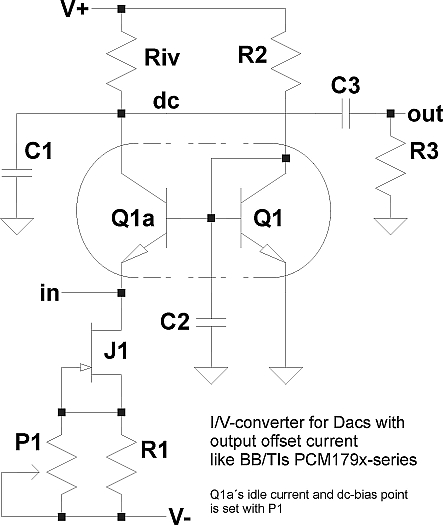

actually I was referring to a simpler Jocko as in the attachment. I called it ´improved´as the THD-values for this simple version were reported to be less good, possibly not better than -60dB at 0dBfs.
Indeed fell the first testands into that range and I started to tune and tweak. Now my versions are consistant at -90dB and better (measured at the output of the associated JFET-bufferstage and 0dBfs).
The CCS towards the positive supply is omitted with and the Riv is used instead.
C1 limits the bandwidth. In conjunction with C2 the input impedance of the circuit may be linearized up into the MHz range.
J1 is a simple NJFET-current sink. Its current taking over the DACs offset current plus the bias current of Q1a. Its bias may be tuned by P1, thereby setting the dc-working-point at the same (influence on THD-values too). C3 blocks dc and couples the audio signal to the following (buffer-)stage. If R3 is rather large in value as it could be as the Gate-resistor of a JFET-bufferstage, C3 may be small in value (and size). The current through Q1 is set by the value of R2. Tuning of R2 allows to null the input offset at Q1a´s emitter.
The quality of the supply voltages needs to be high, since the positive PSRR is low. But then we need quality supplies in audio anyway. ;-)
Against the before linked Jocko with its two bipolar CCS setting the working points is very easy and the circuit is lower in noise (and seemingly also lower in THD).
The circuit resembles certain similarities to the D1 and OPCs Power-MOSFET version of the D1, but requires less effort regarding power consumption, heat dissipation, size, high values of supply voltages, sourceability of parts and cost. Using easy to source matched dual transistors no further matching is required. A solder station and a DVM to control the dc-working point is all whats needed to get the thing running.

Actually same problem as the Pass Zen IV -- no PSRR and coupling cap in voltage mode.
But indeed very simple.

Much lower distortion than Pass Zen, much lower input impedance. Zen really measures like a passive I/V+ tube stage but with better S/N.
Coupling cap is a coupling cap, my guess is he probably has a dc coupled buffer figured out.

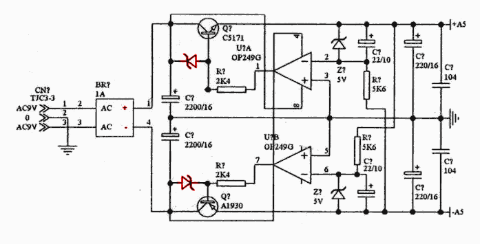

If one wanted to use a regulated power supply, would that be a problem? My dac already has one available at 15v (see image but 15v zeners). Or is this circuit so sensitive that battery power is mandatory? (asking since I'm still waiting for my Linear Audio issue ordered a while ago)

I have read the posts #150 on regarding floating supplies. I'm a newbie in regards to floating supplies.
I suspect that even if my supply was isolated from the rest of the circuit ground and I used only +15v and 0v there would be leakage to ground via the mains transformer. Is that so?
I too, looked at the idea of floating supplies, shunt regs, etc and considering that you need a dedicated 18v supply for each Cen/Sen stage, it quickly became a problem in itself
And, I wasn't happy with the voltage developed across the Riv also being superimposed on the supply lines, regulator, caps, transformer secondary, etc - just asking for signal degredation
Take a look at the world of batteries, particularly those Li-ion ones intended for remote controlled cars, helicopters, etc (Patrick himself uses a system of the 9 volt block batteries with isolating relays for recharging ) - this appears a simpler, possibly better, supply solution.
..... just my 2 cents, mind you.

Lithium batteries, especially the ones with unmeasureable output impedance and noise (LiPO4 and other variants) are a huge untapped new frontier for DAC's, both on the digital and analog side. But setting up the automated charging circuit is a PIA 🙂 I've found one of the biggest problem with dealing with low level signals is the power company and rectifiers, take a scope to your wall outlet and study it over the course of a day, its amazing we get any quality audio at all from household mains. I work with robots and vfds in my real job and you wouldn't believe all the issues from poor quality mains.
So taking the jump into the new battery technology is well worth the trouble, just don't make them explode 🙂
With a PCB and all parts ready, you'll get this going within an hour using 8x 9V alkaline batteries for two balanced channels. They will give you more than 10 hours listening. And when after 10 hours, you are still pleased with the results, then it's the time to start worrying about charger circuits, filtering caps, regulators, ..... But then again you may enjoy the music so much that you won't want to bother with regulators and what not any more.
So why worry about it now ?
