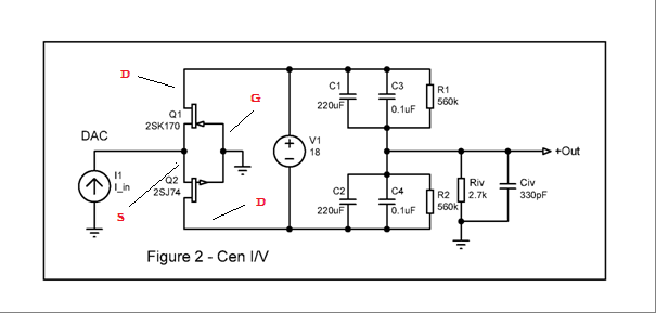

> I do have some dc offset in the output of one channel. Whats the best way around this, trimmers in series with the 560k resistors?
You should trim the output DC by adjusting the current source that you added according to post #301.
You are obviously not compensating exactly the 2mA (whatever the exact value and may also vary from chip to chip) current sink of the TDA1541.
You should measure both input and output DC while trimming.
Changing R1, R2 will not solve your DC out problem.
Maybe QSerraTico_Tico can give you more advice.
I do not have a TDA1541 to play with, so I cannot tell you exactly how it behaves.

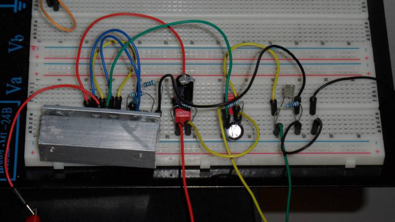

I made a try, breadboarding it.
I used what i got in hand, matched jfet at about 7.5mA and 1.5k Riv, NiMh DC 18V battery, electrolytic and wima cap, the I/V was behing an AD1865.
Is there any mistake ?
I got offset at input (10 DC mV to DAC ground) and output (30mV). I got sound but a little distorted... A "pseudo" simple thermal coupling (using UGS heatsink) was used but not enough i think...
Nothing wrong that I can see.
The input DC is due to JFET Idss mismatch.
A better matched pair plus better thermal coupling will cure that.
But the DAC will still work with 10mV.
The output DC might be from the DAC itself (leakage of 20uA at no signal).
Try measuring it again with the input open (no connection to DAC).
As to distorted sound (never happened to us), first check output with no input connected (open, no DAC).
If you see oscillation, you can add 2x 100R gate stoppers between Gnd and JFET gates.
Then feed your DAC with a 1kHz digital signal (-6dB from full scale) and measure the output with an oscilloscope.
We'll then take it from there.
Patrick

Thx for advice, unfortunately i don't have a scope. I will work on it this WE especially on thermal coupling. I will also measure DAC DC offset using simple low value passive RiV.
Can't wait. I try another matched jfet, I place them as close as possible using the same heatsink. Result is less than 1mv DC offset at input now 🙂
One of you mailed me about drift problems of the JFET current source used to counter-bias the TDA1541.
Apparently the sound was very good when DC was under control, to justify further experimentation.
JFETs wired as current sources, even with degeneration, are very sensitive to temperature and hence drift. You may consider using a degenerated BJT, such as BC560C, biased by a voltage reference (e.g. a Zener or chain of LEDs), instead. Or even simply a regulated power supply (say +12V) and a resistor (6k nominal, trim to zero DC).
Perhaps others who have used TDA1541 has proven solutions ?
Patrick
Distorsion vanished with the 2x100R gate stoppers... Amazing 😎 Is this IV worth it ? the answer is YES.
I quickly compare it to Spencer D1 jfet I/V (also 2sk170/sj74, R Vishay Bulk metal foil, PIO coupling cap) for the left channel, CEN using basic material for the right.
Comparison was made with CD having the same mono sound on both channel.
Sound was great in both case, for sure really better than opamp IV. I cannot tell whether Spencer D1 or CEN is better... They are closed... CEN is opened to simple improvement (Better RiV...) and should be better as my try is really not optimized (see picture)...
One default 😀 it will be difficult for my wife to change battery each 10 hours if i adopt it.
So really, thx Patrick for sharing
PS : Have you compared CEN/SEN to one of your previous concept http://www.diyaudio.com/forums/digital-source/168093-hawksford-discrete-iv-twist.html
Thanks for reporting the results.
You should do the circuit some justice by using proper PCBs, etc.
The PCB for the GB has already allowed for the gate stoppers.
So you did have oscillation.
You can use rechargable batteries and use a relay to switch it to charge as you switch off the player.
We do exactly that.
As to other circuits.
We have our own version of all.JFET D1, and the Hawsford as you mentioned.
They do not offer any sonic advantages but are much more complicated.
And the CEN / SEN are dead quiet !!!
As said, we use SEN ourselves for PCM1704. 😉
Patrick
