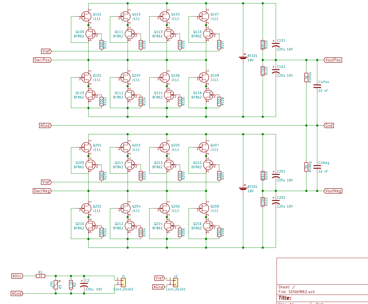

I am thinking about building a Sen I/V for my buffalo 3 dac using bf862 cascoded with j111 as shown previously in this thread (since I have these transistors already.)
In deciding how many jfet-pairs to use, I have been trying to understand how/if the cascode affects the input impedance of the I/V. Is the impedance of one "pair" the sum of the inverse transconductances of the upper bf862 and j111?
Best regards,
Tor-björn
So after thinking about it I guess this was a quite stupid question.
I'm planning to build a sen as in the attached schematic, but am uncertain about where to use gate stoppers. The "upper" bf862:s will get some, but should there bee stoppers on the lower ones/on the cascodes as well? My google skills fail me, and I have no proper education in electronics (learning by magic smoke as I go along...)
If there is no advice regarding this, I'll just include pads for resistors and jumper them so that I can insert resistors if needed.
Best regards,
Tor-björn

I've also found through dumb trial and error that sometimes you don't need gate stoppers and other times you do, can depend reel-reel on the factory the BF862s come from, so use stoppers always.
