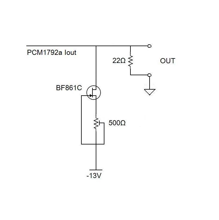

Hello,
I quickly implemented my first version of the SEN "to try" on a prototype PCB directly (PCB are very cheap nowadays) and using SMD parts I had in my drawers.
My DAC is the PCM1794 as well and I am struggling with the cancellation of the 0dBFS current of the DAC (6.2mA).
I implemented a 2N4391 in current source mode but I am having issues with the thermal stability, it can quite easily drift over time and not very stable.
I am using 3S LiPo battery.
So I would appreciate if someone had a good recommendation about a low tempco stable current source?
Beside I was able to stabilize the DAC DC offset to a value not too far from 0 and did some listening on one channel only as I haven't assembled the second one since I want to complete the debug on the first one.
I would like to say that at a first listening the SEN seems to sound very good.
I appreciated very quickly the dynamics and low response impact. Was very good. I need to debug & complete the two channels for a more complete listening.
So I am looking for some help on this current source as I am quite excited now to enjoy this SEN completely 😀
Here is how it looks like:

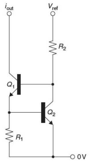

Does your voltage varies across the source resistor of the jfet, thus indicating the drift?
If yes try this one attached with small signal BJTs.
should perform better as well (maybe a bit more noisier depending on bjt).
Vref is ground,
0V is a negative (say -10V)
Iout is the dac current output
(maybe someone more experimented then me has a better alternative/advice?)

Thanks for your advices.
The first schematics you provided with BJT seems still to drift quite a lot at least according to simulations.
To be honest i did not tested it for this specific application, but it is a very common CCS used widespread.
Nevertheless it should give better AC rejection than a simple jfet based CCS if stable thermally.
i actually plan to try this setup on my own CEN+pcm1794+bjt css when i get back at it.

Hello,
After several hours of trial I was able to get something quite stable using J111 I had in my drawer as current source (while waiting for my order of 2SK879).
The main issue is actually not too much the temperature drift but more the sensitivity of the SEN to leave quickly 0DC position as soon as a little current offset is present at the input introducing then distorsion.
It is not easy to adjust given that I use the DAC in mono mode and I+/I- bias adjustment have an influence to each other.
Still I was able to assemble a full stereo SEN quite stable and with very low distortion measurements.

Actually this first proto is using JFET I had in my stock.
I am not using 2SK170, I am using 2SK2145, already matched and I use them in parallel to handle the 1794 large current.
You are right the heat sink here is only to couple all the parts thermally and not to compensate anything.
Later on I possibly plan to try with BF862 that I have as well but not matched yet.
You mean a source resistor on the 2SK2145 would help?
The circuit is relatively stable but very tricky to adjust at the moment.
Best setup I found for the current source is following what Patrick was saying paralleling JFET with a large source resistor.
I also increased the negative voltage applied on the current source.
Right now using J111, better than 2N4391 which are better than BF862 (very unstable as current source).
I appreciate your help as I am still learning a lot here.
