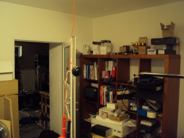

I have now measured the OX tweeter and the 19TFF with conventional frontplate hanging on a string. There is really no contest. Please look. The window was set at 4msec. I do measure reflexions with Power Cepstrum analysys. See me next post.

amazing FR of the OX tweeter. I would not have expexted the 90° and 180° response !
P.S. Next time. please keep color/angle assignment the same for better comparison ;-)

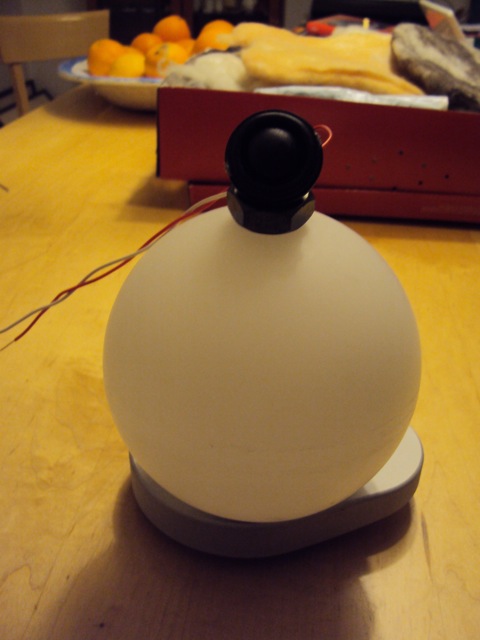

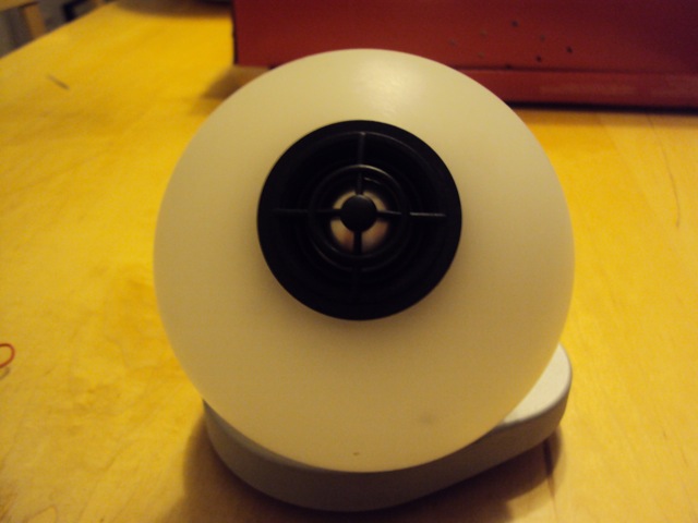

I will build the midrange in a Nylon sphere. A volume of 3 liters should work. With a first order xover and impedance control a 2nd order Linkwitz is posible acoustically.
May years ago i had already experimented with spheres. At that time i put a tweeter into it. The ZDL will be more extrem. The tweeter needs no aditional cabinet. See my mockup.
The sphere shown is too small though.
The output of the midrange in the passband under thoose conditions is ca. 103 dB @ 1m without the coil leaving the gap.
OK, i will keep the colours the same next time. My measurent system asigns the colours automatically and i did not edit. Yes, from the back the OX tweeter has even a bit more treble then from 90°.What that experiment has shown is, that when the tweeter is small enough reflexions are very low up to high frequencies. There is of cause some beaming from the finite size of the membrane and the soft membrane breaking up in the higher treble.
Seems to be very well controlled though, and the first 0.4msec are superbly clean on the cepstrum plot.

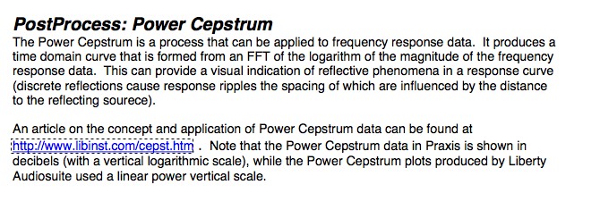

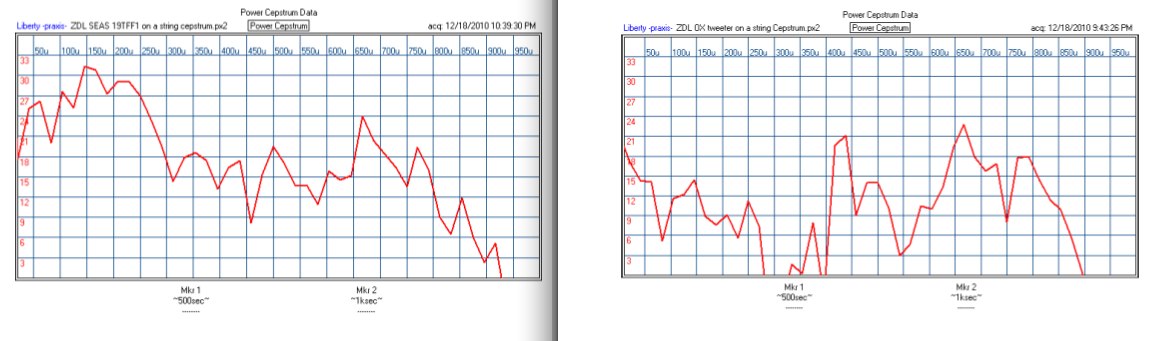

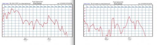

Here are the cepstrum plots. If you have questions, ask me.
Hi Joachim,
I haven't done cepstrum plots myself yet, but understand the basics. Could you tell us something about the sources of reflection (attributed to the time scale), that make up the differences between both plots? It would help me to understand how valuable this method is in real life.
In your linked essay "Reflecting on Echoes ..." I found a reference to the very interesting work of McEachern. Do you know by any chance where I could get his "Hearing it like it is ..." article? Goggle did result in 1000 references, but no source to obtain a copy.
