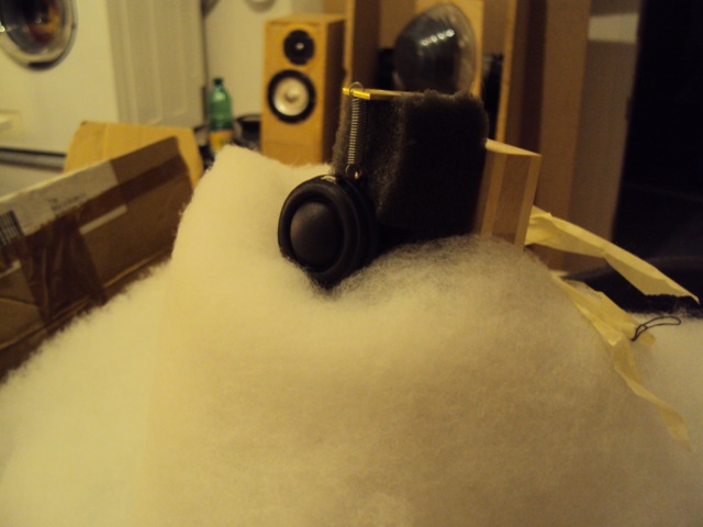

I made more experiments with the ZDL tweeter and Elias is right. Simply hanging the tweeter in "free air" is not the solution. Some damping of reflexions is necessarry for best results and i arived at a good result by damping the back of the tweeter with foam and damping the bucket with poly stuff. That ain´t look pretty but this is just a first attempt.
See the response i get now compared with the measurement without damping.

I also measured distortion. First Harmonic Distortion, second and third. As comparison i used a SEAS 19TFF1. Here the SEAS scores with less third but that does not tell the whole story as you will see in my next post.
First you see that under 2kHz the ZDL tweeter does better the SEAS in third. This is what i found with a lot of tweeters that use Ferrofluid. In the SEAS some compression is going on but it is still well controlled. Now i made some Multitone measurements. Here the diffences come out more clear i think. The ZDL tweeer has more low level hash and should not be used much under 2kHz but the SEAS ( red ) has more high level intermodulation.
What sounds better can only be found out with listening tests. I can not use the SEAS anyway because it has a wide baffle and it does not fit into this particular design.
