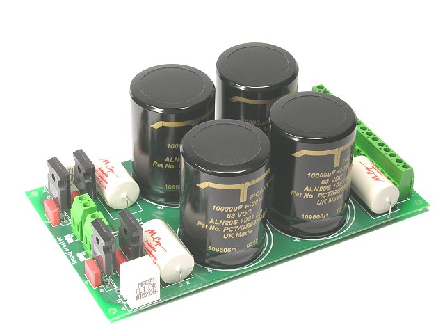

10 months ago I bought BHC T-network and SlitFoil capacitors to use them in the UB-Audio NT-E power supply, all 10000uF, 63V.
I talked to the technician of the store I bought the capacitors at because at first I wanted to use 4 pcs. T-Network caps in each supply (2 per rail). I also have to explain that in this supply the T-Networks are in series one after the other (see attached picture). The technician said that they already had tried all combinations (4x SlitFoil; 4x T-Net; 2xSlitFoil+2xT-Net; 2xT-Net+2xSlitFoil). I asked him about his ranking for these combinations and he told me that the best sound of all was the combination 2xT-Net+2xSlitFoil. Also note that this combination should not be used after the Jensen document a view posts above! On second place came the combination 4x T-Net, 3rd place was 2xSlitFoil+2xT-Net and 4th was 4x SlitFoil. I didn't really believe him because my first thought was that the SlitFoild should come first and afterwards the T-Nets and so I installed only one T-Net per rail up now.
Summarizing this post it would be really interesting if the combination 2xT-Net followed by 2x Cerafine could also be tested according to this technician the best sounding combination.
By the way don't blame me now for posting this here also but it seems the most interested people for SlitFoils and T-Nets seem to gather here I have still 4pcs. SlitFoils and 4pcs. T-Nets lying around (all 63V, 10000uF) because I wanted to build 4 amplifiers and than only built 2 so I still have these left. If anyone is interested contact me by PM.

What puzzles me is all the times I've read that you can combine the two technologies to make a four-pole-slit-foil. They must have tried it, why aren't they selling it?
As far as what they recommend comes first I think it's just a case of marketing. /

It also took me a while to understand this sentence in the T-Net data sheet. First you think of they mean you should combine a SlitFoil with a T-Net to get optimum results but actually they want to say with this sentence that the T-Net is a combination of 4pole and SlitFoil. Yes the T-Net is a SlitFoil capacitor in a 4pole configuration so no worry why they don't produce such as cap, they do.
Are you sure?? Got some inside info on that? They only ever said it "can" be done...which kind of implies that they aren't.
You'd think they'd really be marketing that if they were. "The ultimate slit foil, newly improved..."

You ask if I have some insider infos proofing that the DNM (BHC) T-Net cap is a combination of 4pole and SlitFoil technics?
Yes, I have poof but it seems not to be insider info.
Just have look at their homepage http://www.dnm.co.uk/capbhc.html.
Their you can read:
"This T-Network capacitor uses a combination of T-Network and Slit Foil technology to produce the ultimate audio capacitor. It is a typically ultra-reliable BHC electrolytic with performance exceeding even the most expensive specialist electrolytics"
Greetings
