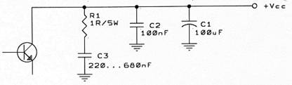

Lars: On the electronics (amp) side, can the following snubber circuit (I think that it is called a snubber circuit) be used with the 2.3SE circuit board?
For some reason I don't seem to be able to attach the picture (jpg)? I need some help with this. Any ideas?????
Hi Lars: I have emailed a picture of the snubber circuit to you at LCaudio. If you are able could you post the picture for me. Also, is there room on the 2.3SE PCB to this circuit?
