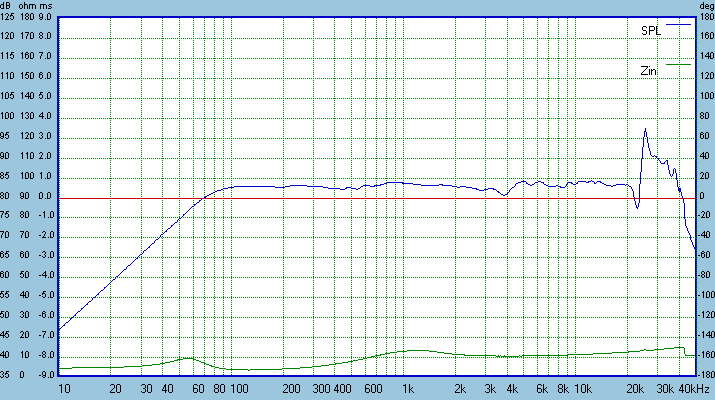

However, even after reading many threads with BAMTM in the subject, I still couldn't figure out, which amp fits these speakers best, or even which impedance the system has. If this is a FAQ, please point me to the answer, I honestly couldn't find it.

The middle row of numbers on the left, and the line on the bottom of the graph shows the system impedance. This is a 4 ohm design based on the woofers impedance through out the mid bass. Any amp that can handle 4 ohms would be suitable.
