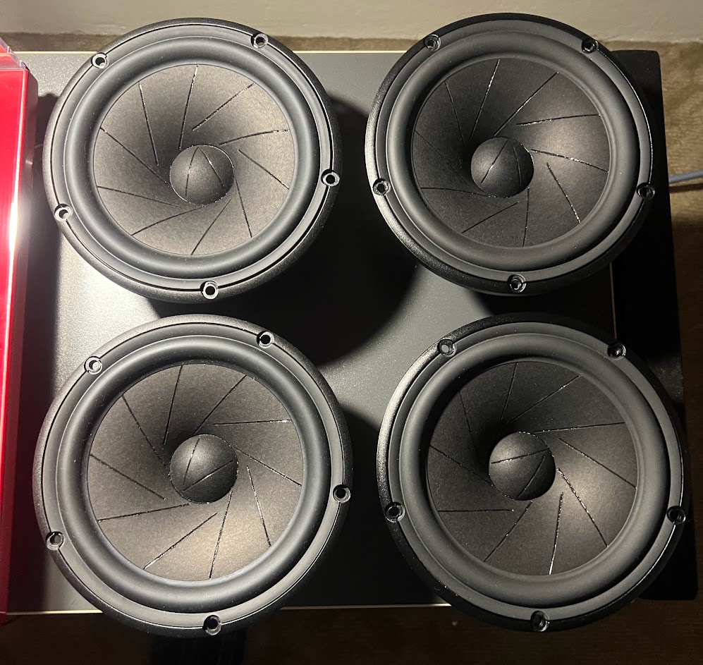

I keep reading this thread because I have a similar build right now. Mine is the same 18W8531G00 woofer in 33L @35Hz as I posted before. The bass output is definitely more than my build with a 15W4531G00 in ~9.5L @ 50hz which isn't too far from the ZD5.

@D1sco - they are in phase - checked, doublechecked and triplechecked with 15Hz signal generator from REW. There's plenty of bass, it just does not reach deep enough.

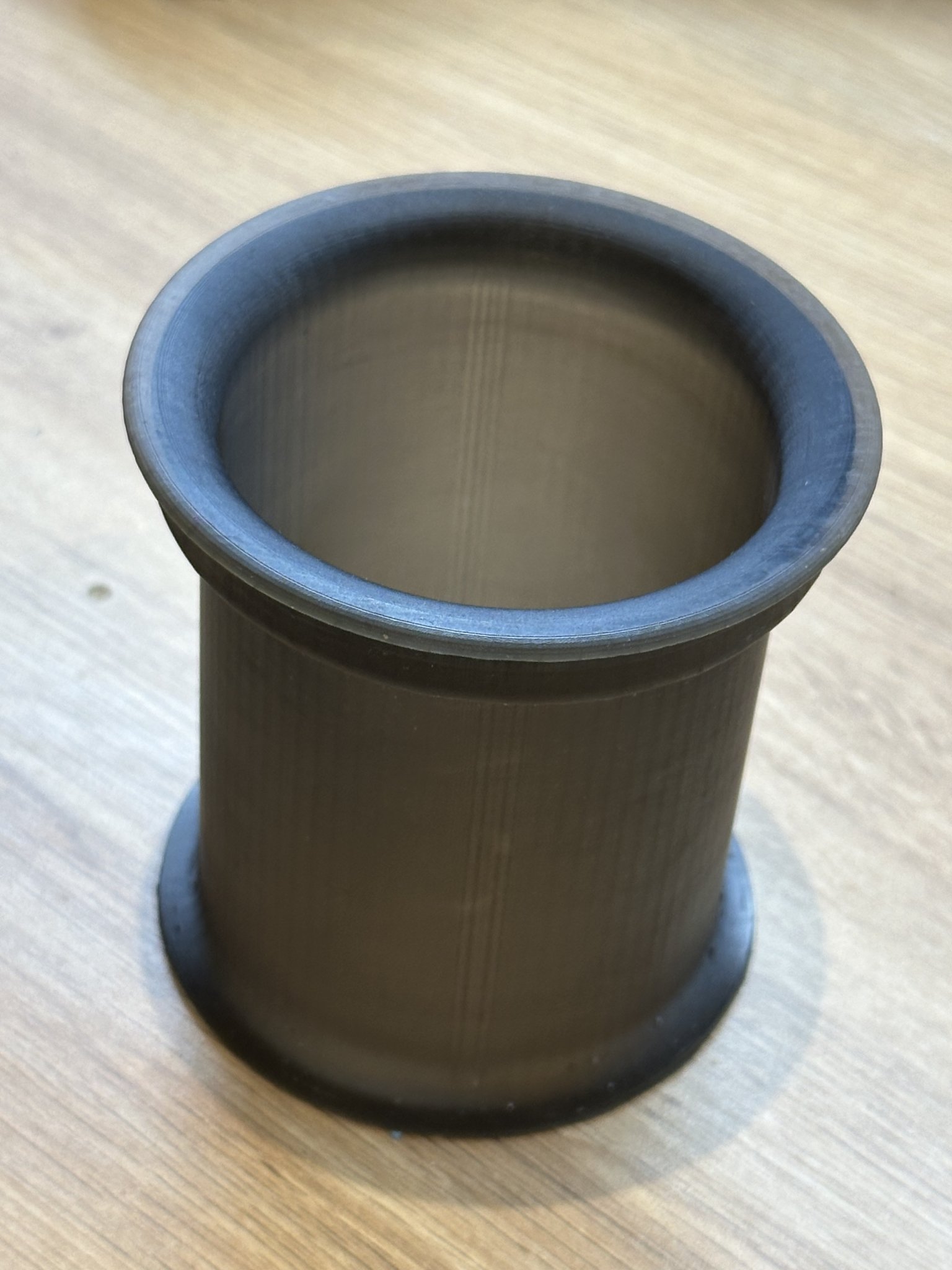

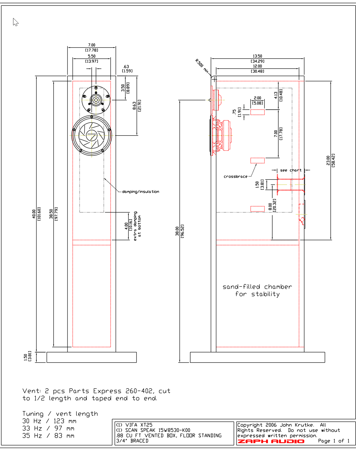

I completely forgot one detail about ZD5 - it was built as 25l floorstander, but with reduced depth minus the sand chamber. This was messing up the mids, so the box was eventually reduced internally to 14L, but the vent remained the same - it was tuned to 30Hz for 25L box (3,8mmX123mm). With reduced volume according to the Virtuix, the tuning actually went up to 38,4Hz. So I ended up with a unique sounding 14L vented ZD5 that noone has 🙂 I will try to tune ZRT to the same frequency so maybe it will be able to match that low end reach that my ZD5 has.

Yes, 10-15Hz. At this frequency, you can see all the woofers move in the same direction.

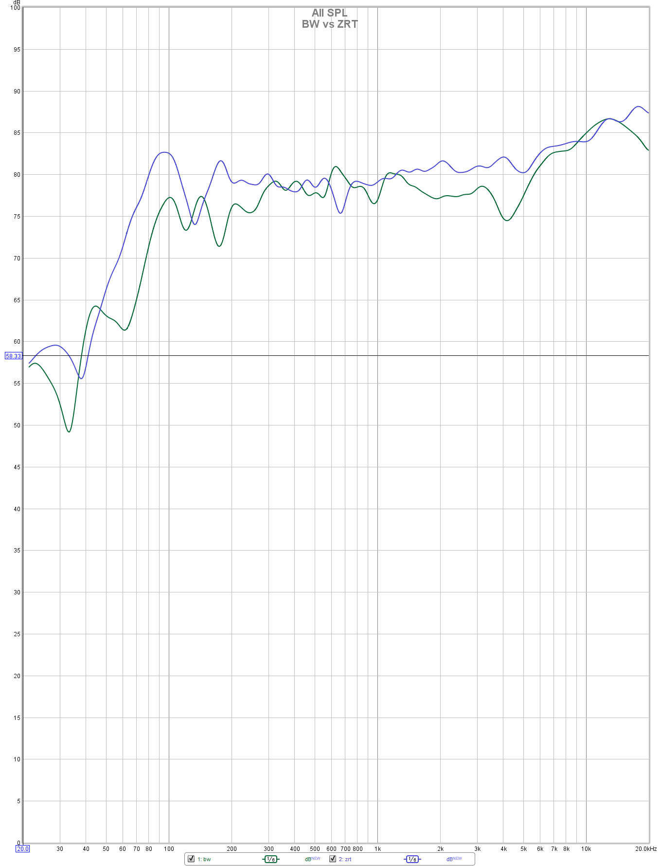

If you say so. I think connecting a 9v battery would more definitive. Or actual measurements (maybe I missed those).
You have obvious room modes on 35, 65 and 130 Hz or close to that...if you have deeps you also have peaks of bass....can you find them walking around... are there areas with excessive bass?

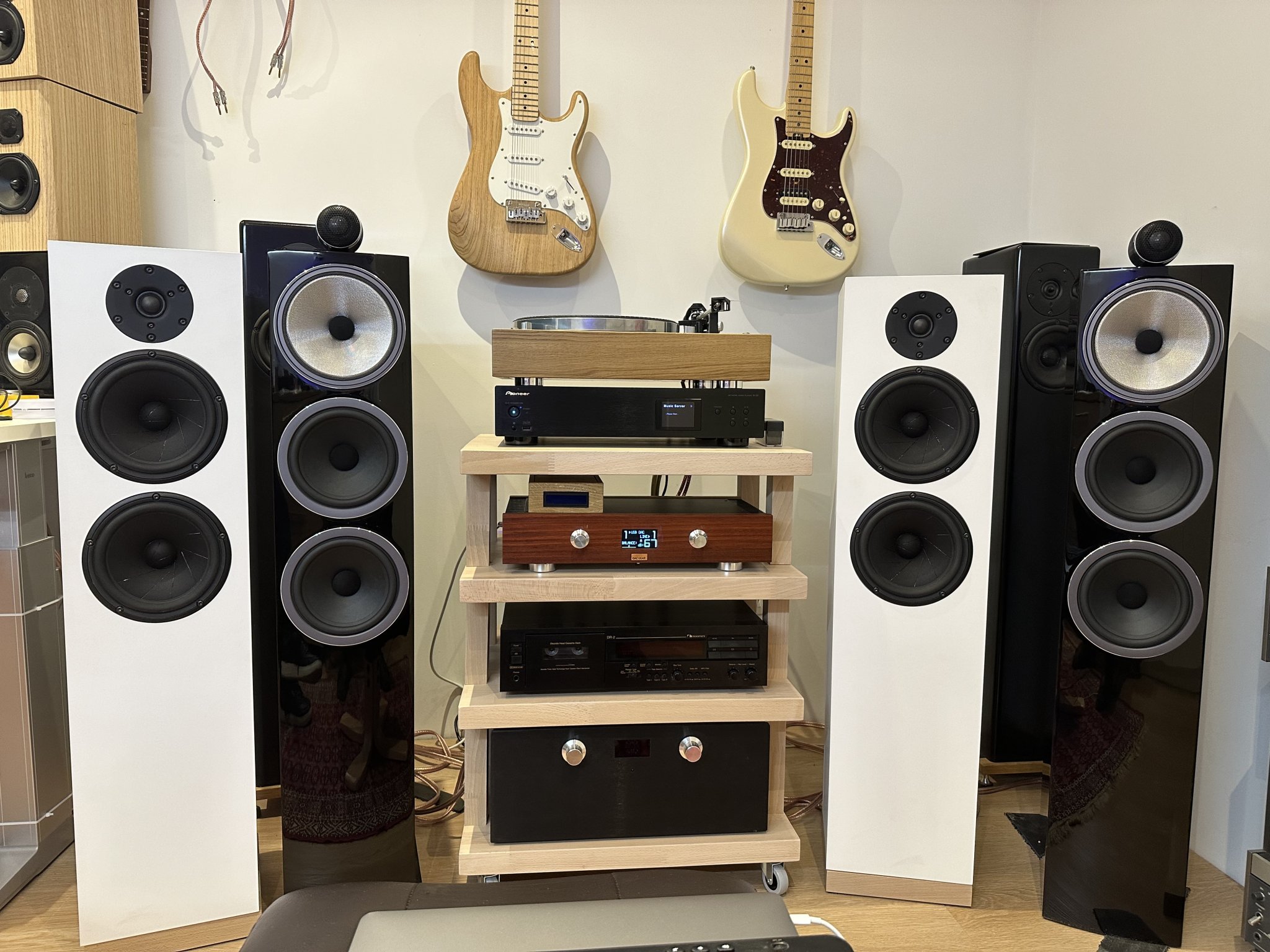

It is, and also mids are fascinating on ZRT... New 40Hz port installed. BWs are brand new, burning them in right now.So these biggy B&Ws have less bass according to your measurements?
Is it really like that?
Just to make it perfectly clear:: there is no lack of overall bass in ZRT - they just do not go as deep as ZD5 (40Hz area?). But B&W does not reach that sweet low end either.

I am considering building another, more narrow box just for testing, with baffle width reduced to 191mm (from 231mm). Baffle step will move upwards from from 77 to 93Hz, and looking at SPL it might help to dampen a peak around 90Hz.
So the conclusion is - nothing wrong with ZRT, I just chose the slightly wrong design. They are high efficiency speakers that don't go very deep. The voices and pretty much everything sounds just incredible, beats B&W 703 S3 on almost everything. I have my eye now on DXT MON 182 (https://heissmann-acoustics.de/en/dxt-mon-182/) which looks impressive on low end. If they can match voices on ZRT, that would be a way to go for me. Low efficiency does not bother me, I run on class D or AB. Thanks for the help everyone, time to close this off 🙂
