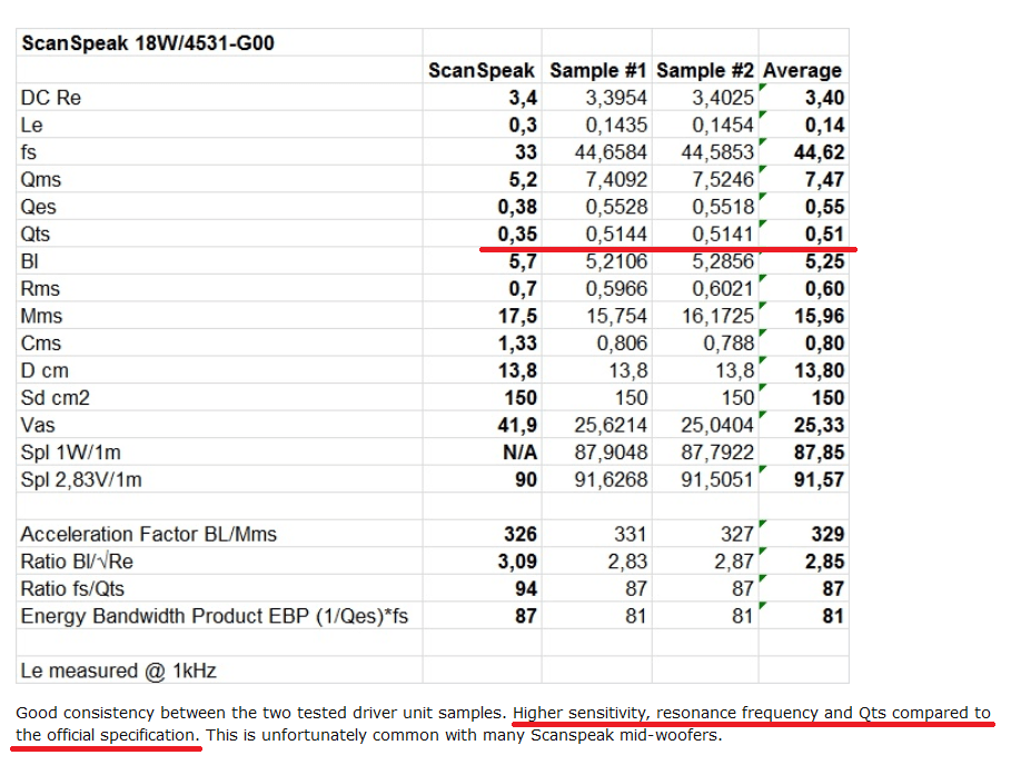

Coming back to your speakers, I do not have your woofers.

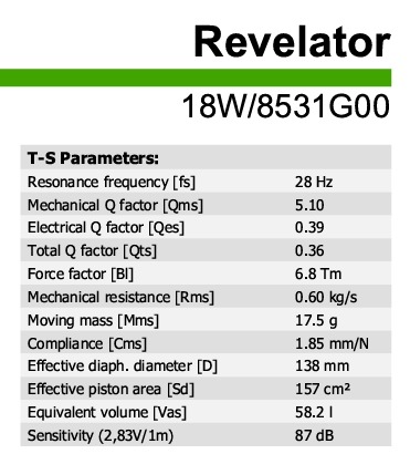

Your ScanSpeak Revelator 18W/8531G-00 looks similar to my 18W4531G00.
With a Qts of 0.36, you should get a very solid bass in a bass reflex.
The bass should blow you away. That's now good a proper Scanspeak woofer is.
Try to measure your woofer's Thiele & Small. That will be a good starting point.
The harshness in the treble is caused by the crossover.
That can be addressed but if the woofer is out of specs, there's nothing you can do.
To be fare to Scanspeak, their 5" Underhung Scanspeak 15WU is in a class of her own.
The bass in this midwoofer is incredible. The best I've hear so far.

YSDR +1, I had quite similar experience in 2way project with 18w classic. After few tweaks leading nowhere I added rlc tuned to 6kHz, 1dB suppression, lowering the area roughly 5-8kHz. After that harshness dissappeared and the sound was detailed, smoother and full, very enjoyable and what I would expect from expensive soft dome.
I might have been spoiled by detail and clarity coming from W12CY with magnesium cone. I am inclined to return the whole order within 14 days and sell the boxes. I don't think I will take the risk of tweaking things with questionable outcome without proper measuring equipment.
For 1500 eur, I could easily buy second hand Dynaudio focus 220 that will blow this thing out of the water.

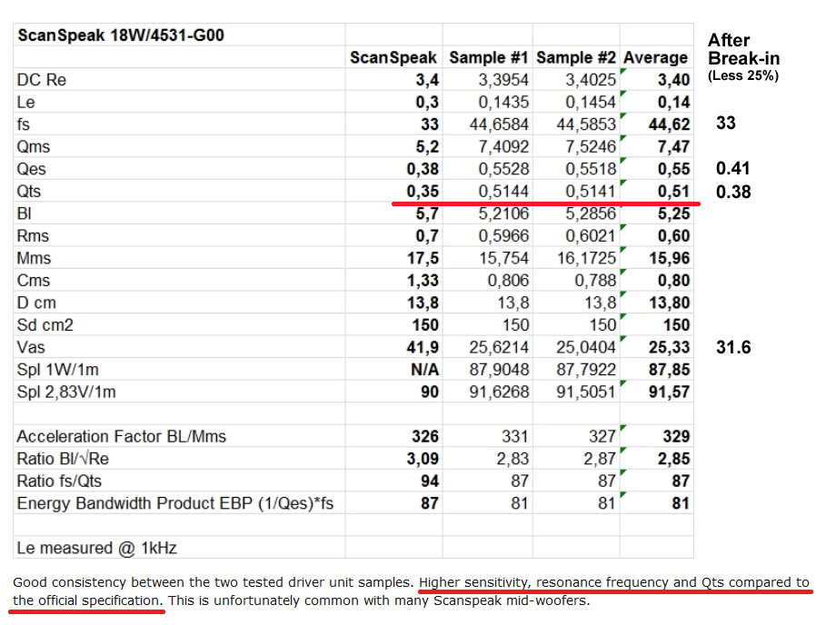

Thank you for bringing up this chart.
If the woofers were measured before break-in, they are actually very good.
From my experience, I find there is a 25% reduction before and after break-in.
You can see from the chart below the new parameters after a 25% reduction.
They are very close to Scanspeak's specs.
For the Vas, it is 1.25X, the rest is 0.75X.
In instances like this, I will use the manufacturer's T/S.

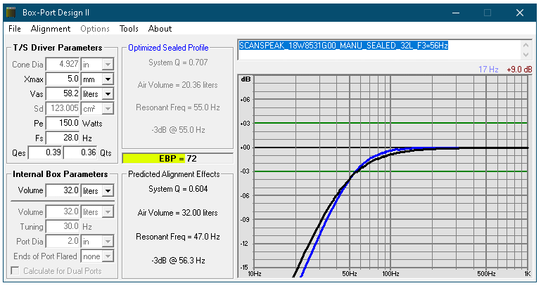

I did some modelling with your Scanspeak 18W8531G00.
Assuming the T/S of your woofers are the same as Scanspeak's, the bass alignment are:
In a sealed box, the F3 is 56Hz. System Q=0.6.
In a ported box, F3 is 37Hz.
This only give you an indication of how low the bass is.
It doesn't tell you how the bass sounds like.
That is a personal preference.
Mike
AmpsLab-Spk

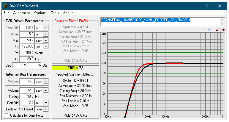

Thanks. Do you think I could simply port my 2.5 ways construction like 2-way is ported on Zaph's site? Ported 2.5way is in 65l box with 30Hz tuning.
Anyway, I installed the port designed for 2-way with 38l box, and I hear no difference in low end. So it must be that drivers are not burnt in yet. I will run them for another week and see.

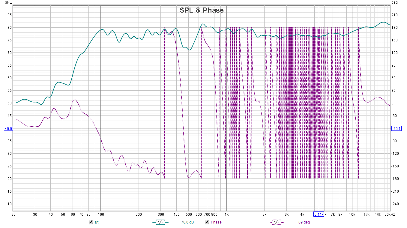

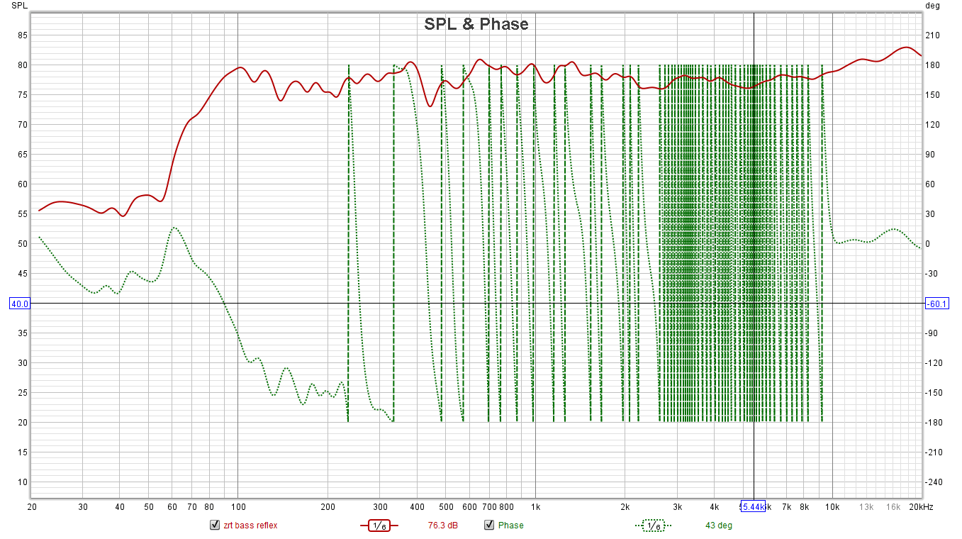

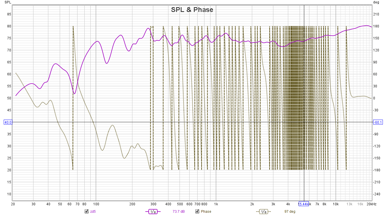

Polarity has been checked over and over again, no mistakes there. I measured the SPL and there is a huge drop at 100Hz compared to ZD5. Port tuned to 30Hz. Maybe my comments were a somewhat imprecise - there is sufficient amount of bass above 100Hz, just does not go as deep as ZD5, as seen on the graphs. I am going to start checking the woofers individually, maybe something really is wrong with recent production of the woofers. I built ZD5 more than 8 years ago. I do have bitumen sheets lined up inside ZD5, but ZRT recipe did not mention anything like that. Could this make such a big difference?
In post 10 you mentioned the word "hot" and in the graphs you have attached to post 29 the amplitude for the zrt climbs slightly above 300Hz, whereas in the zd5 it does not.
Being used to the zd5and forgetting QTS questions is this response shape the real issue here, possibly it is made worse by slight changes in the drivers response over the years.
You are looking at a crossover design to fix it, maybe somebody would kindly take your Xover design and drop it into Vituixcad and tone it down a little bit, this may also alter your perception of weak bass.
Not an easy task unless somebody has the response of your drivers in that cabinet.
