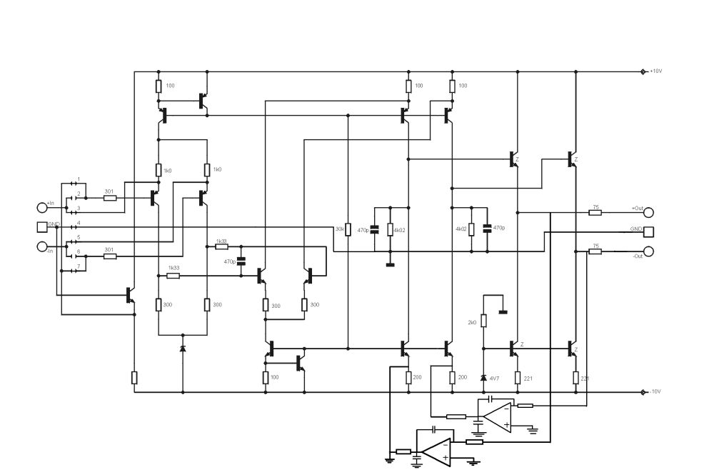

I found a schematic for the very highly regarded (as far as I can tell) zapfilter 2. I thought I would post it here in the hopes that someone can do somthing useful with it such as a PCB layout.
Click here for a very high resolution version.
I'm not aware of too many DIY discrete output filters... none at all in fact. So I hope this can be useful perhaps as insperation to design an even better one. I don't really have a good enough understanding of the circuit to do that or a PCB layout myself.
The layout is easily copied from the pictures. And the complete schematic with the servos has been available for years. The problems is that diyers are an exceptionally lazy bunch and would rather pay somone else to do the work for them.

Yes it was quite a headache for them, the servo was capable of pulling in +&- 50 oddmV, but when the front end tranies got hot, this caused them to (unmatch) for want of a better word and this sometimes caused even more DC offset and the servo couldn't cope, Gert said to me the new version will be 9 x more capable. One waits in hope.
I was able to stabilize this to a certain degree with a common heat sink across the two matched pairs, but being smd this was only a very small heatsink and not the best solution.
And here is the circuit with dc servo's
Cheers George

The zapfilter is already a single ended device.
It needs +-10V, and prepare for heat if you go for +-12V, as it features shunt regulators.
You should find another battery, and provide it with +-12V and a pair of IC regulators, ie. 7810/7910.
Actually it is of very little use to implement battery powersupply for this analog stage, as its own PSSR is magnificent as a consequence of the shunt regulators. It also will result in very little battery time as it has a huge surge of power.
