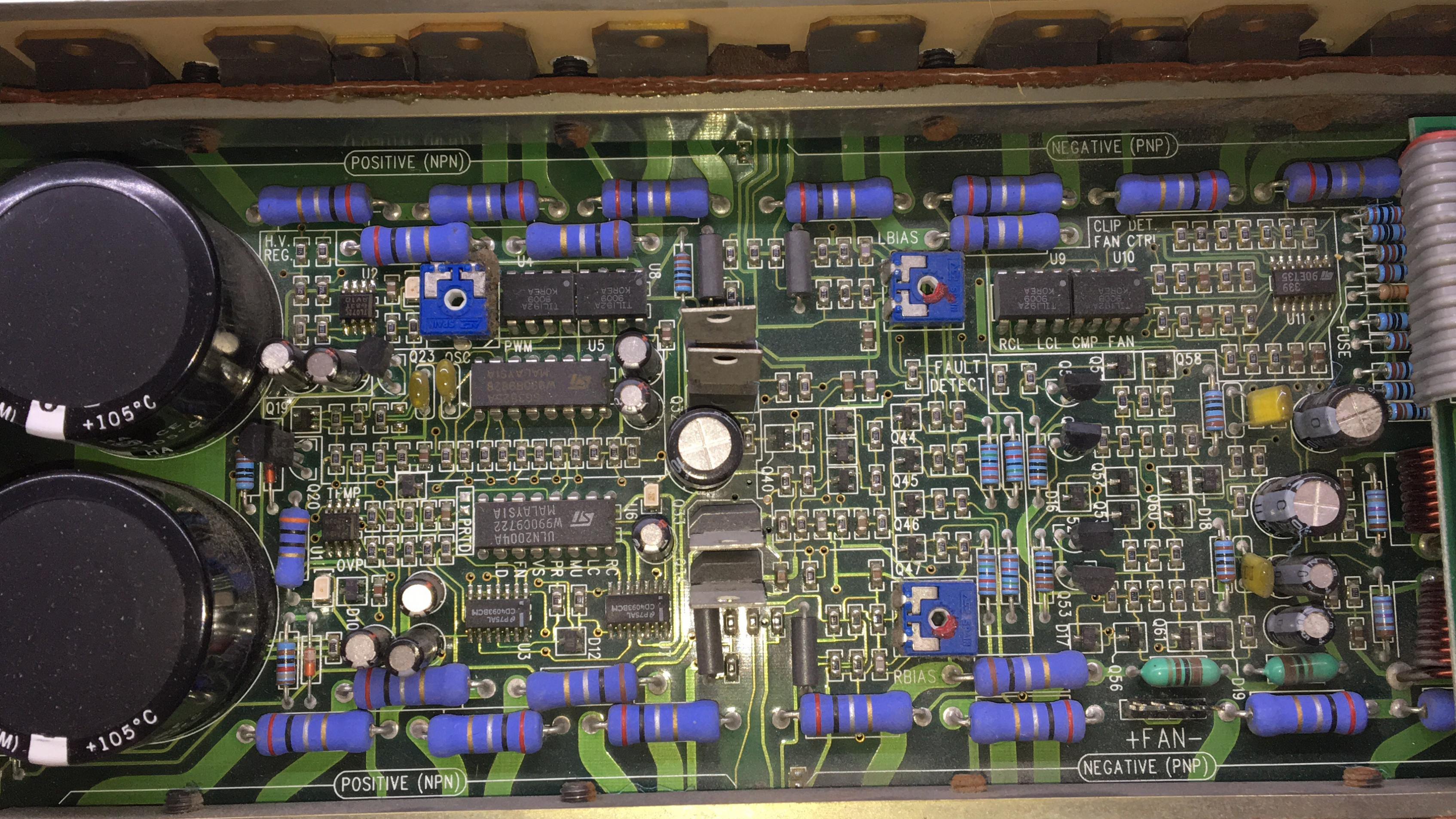

I recently acquired a Studio 500 amplifier.
I've had some difficulty searching for a service manual for this unit.
I did reach out to Zapco earlier today to see if they have one available they are willing to share.
I've not tampered with anything on the board so far, just removed a couple heat sink clamps to test the voltage regulators.
I've powered the amp on
No protect light, very little DC offset (.02)
No sound out.
If I crank the gain knob the clip indicators will slowly flicker as I adjust the gain.
There is no sound out, at all.
I've got +15 on pin 1 and 3 of tip31 and -15 on its counter part

Zapco has been releasing some diagrams. It would be easier to troubleshoot if you wait (at least a day or so) to see if you can get it.
Link to or post photos, please. One photo of the inside would be good to start.

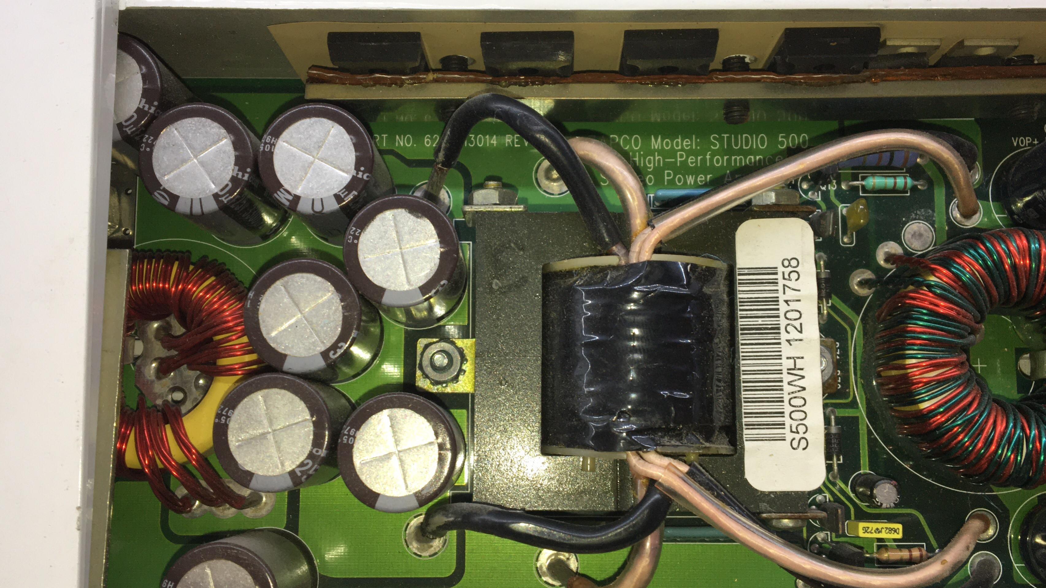

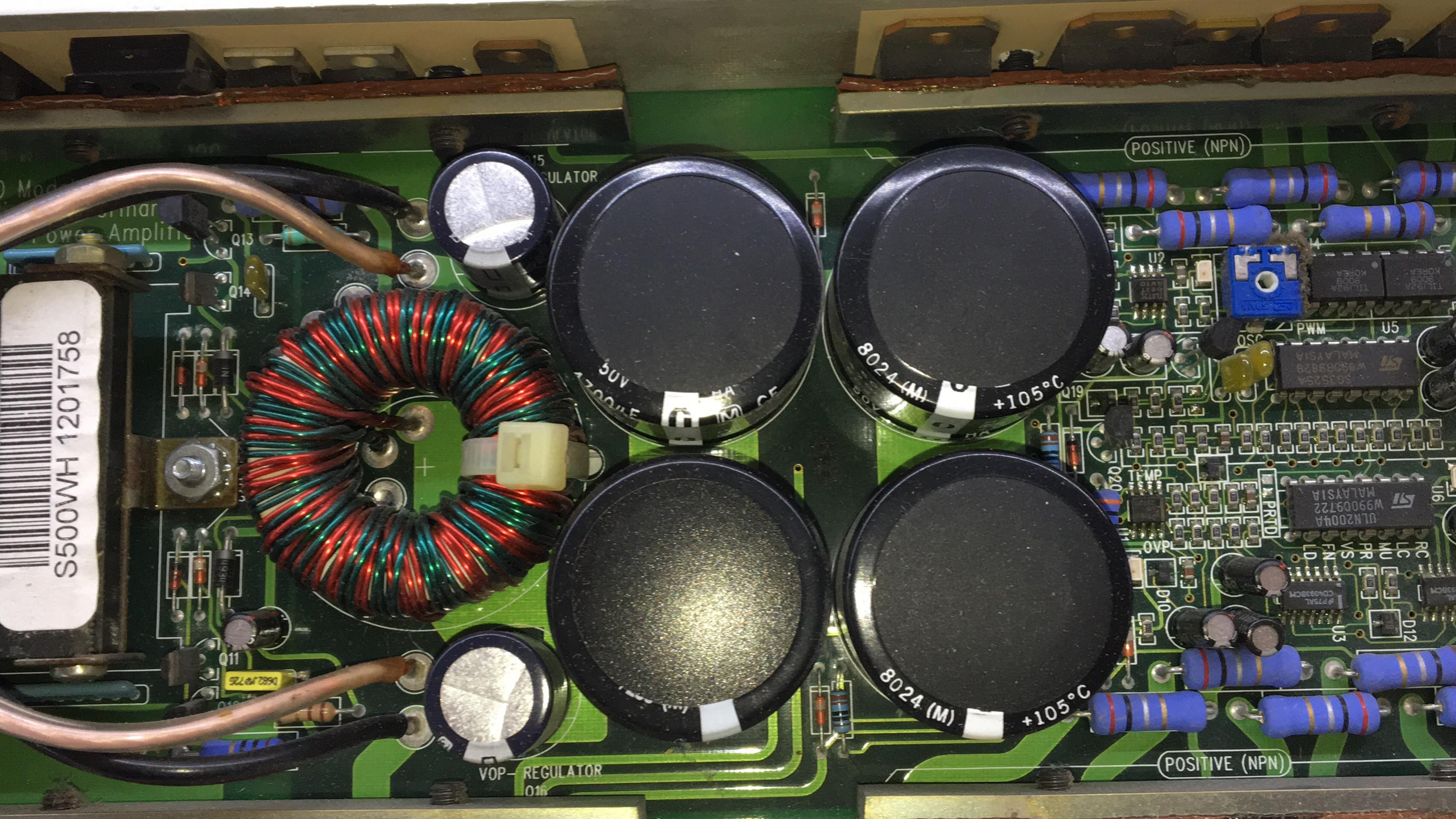

Here are a couple photos.
Zapco was kind enough to send me a copy of the schematics.
I noticed there are two SMD leds that illuminate when I power the amp on

The one LED is in the isolated muting interface, the other in the linearized isolated feedback circuit for regulation, both in the supply schematic
https://www.dropbox.com/sh/adls0jqav6cdge8/AACRdXdxfOyu9eXdzek8uXEMa?dl=0
Just an observation that they are illuminated. I do not know if they would be illuminate for functionality and to show power or fault
I think they show that the corresponding circuit is active (working correctly). I would expect there to be a delay on the muting LED.
I'll power it up and see if there is a delay.

Set your meter to AC voltage, lowest range if not auto-ranging. Drive a signal into the amp and turn the gain until the clip LEDs just light up. With the black probe on a non-bridging speaker terminal. Touch the red probe to the various large blue 0.2 ohm resistors. Do you read more than a fraction of a volt on any of them?
Oops, I'll have to redo this step. I only measured AC voltage on the output with a 1khz tone and read .6V

I tested the SG3525
1. -9.43
2. -9.40
3. -11.98
4. -11.84
5. -9.83
6. -8.18
7. -9.94
8. -7.06
9. -10.26
10. -12
11. -9.14
12. -12
13. 5.25
14. -9.16
15. 5.25
16. -6.80
